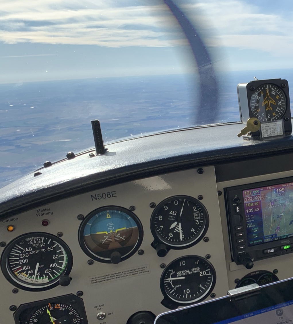

I have been using the Alpha systems AoA for more than 2,500 hrs and can tell you that this device taught me how to fly the wing.
It adds safety and precision to your flying without the need to have thousands of hrs to get the seats of the pants feel.
And eventually with practice and time for sure you get a feel of the plane, but it is still useful.
The AoA indicator its not only for landing, it gets you accurate Vx , Vy, Vg also very useful during slow flight in confined areas.
They do work.

I put a CYA 100 in a late 1958 C180 several years ago; I thought it was helpful in learning those high AOA slow approaches where you better have power at the bottom, or you’re gonna crash. Do I look at it now during landing? Naw, not so much. I do think it’s a useful training aid? Yes. Pretty easy, too. It’s out of the propwash outboard of the strut and mounts in a inspection panel.
