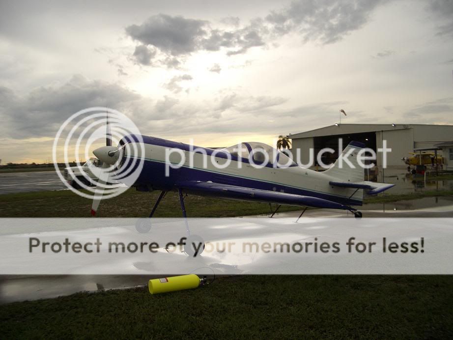

I equipped my E-3 for IFR and flew it in the clouds when I had to get somewhere. It rolled 400 degrees a second, and was designed to be unstable. It didn't have an autopilot....
