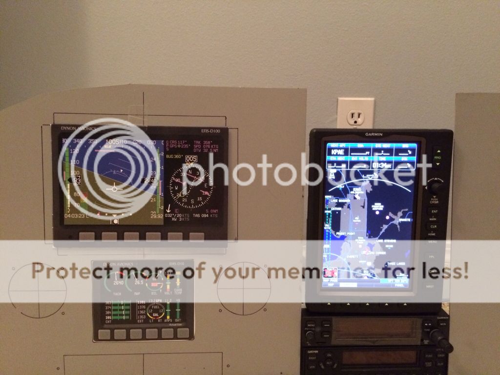

What do you guys think of this?
ASI. ALT Room for
T&B D100
So I'll start with basic VFR instruments with the addition of a T&B w/skid ball. I'll leave room for something like a D100 which can act as a AI and a HSI at the same time. Does a HSI replace both a DG and a CDI w/GS? I'll start with just a comm radio, Icom A-210, but have room for whatever GPS/NAV,COM makes sense when the time comes, maybe a refurb 430W. The D100 can be slaved to both the GPS and a NAV radio.

That seems like a smart way to go. I'd recommend a modular 3 piece panel (left, radios, right) That way you don't need to Build the whole thing again when you add or change equipment.
I'm not sure what you have in mind for an engine monitor but the D-180 is basically a D-100 with an integral engine monitor. It would be the most economical way to go. The D-180 can be configured to display the HSI page when required for navigation. If you want a separate engine monitor (and plan to use Dynon glass), I'd recommend you buy a Dynon EMS. The Dynon legacy "D" series products (except for the original D-10 EFIS) all network so either display can display data from either box. The "legacy" Dynon stuff is coming up for sale quite frequently with the RV crowd as it's not compatable with the SkyView systems most are upgrading to.
As an example, here's a photo of the parts I put together for the panel upgrade I'm working on. I'm using a D-100 networked with a D-10 EMS and a used Garmin 695. I've got a GTR -200 com radio (only thing purchased new) also tied to the 695 and a GTX-327 transponder. Total investment for everything in the photo $5,200. While this may not be exactly what you have in mind for your airplane, I think it's a good example of what can be put together at a reasonable price if you don't need the absolute latest whiz bang stuff.
