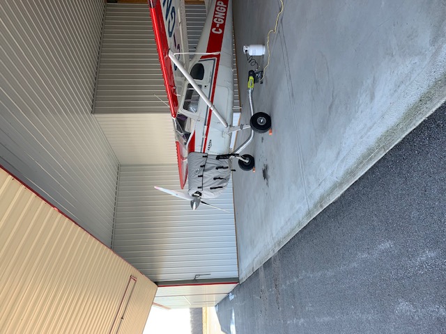

Ryobi heater doing battle in "hard wired" mode but alternately it can be powered by a lithium ion battery with a smaller camping style propane bottle. Some might wonder why the duct is stretched out so long but if collapsed much shorter the overheat sensor is prone to activating and shutting the heater down
