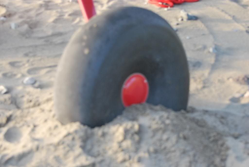

Dogpilot, i like your idea of fill-up bags although instead of sand, they might get filled with sage brush.

carry a shovel - also makes it more "flat."

Matt 7GCBC wrote:You carry an air pump, right? If you're on 31/35s and in that big of a blow, let the air out of the tires. No more high AOA. Hell of a lot easier than digging holes to push the tires into. Sorry if already stated on a previous page.
Why not just pile some dirt or rocks under the tail and tie it down to accomplish the same thing?

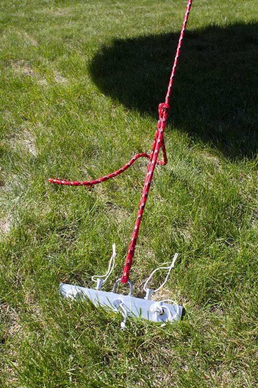

Anyone have any experience with something like this?
I have a couple that seem to work pretty well, although I've only used them at Schafer and Meadow Creek, and never in strong winds. They are easy to screw into the ground - I use an aluminum bike seat post for leverage. Once they are in the ground all the way (14" or so) it doesn't seem like anything could rip them out. The screw on the bottom is probably 4" in diameter.

SamIntel wrote:Anyone have any experience with something like this?
I have some. They don't work half the time...not at all in rocky stuff. If you get them in, they disrupt the ground and simply don't hold. They seemed fine in dirt and sod. Spikes seem to grab better, and are easier to get in to hard stuff.
