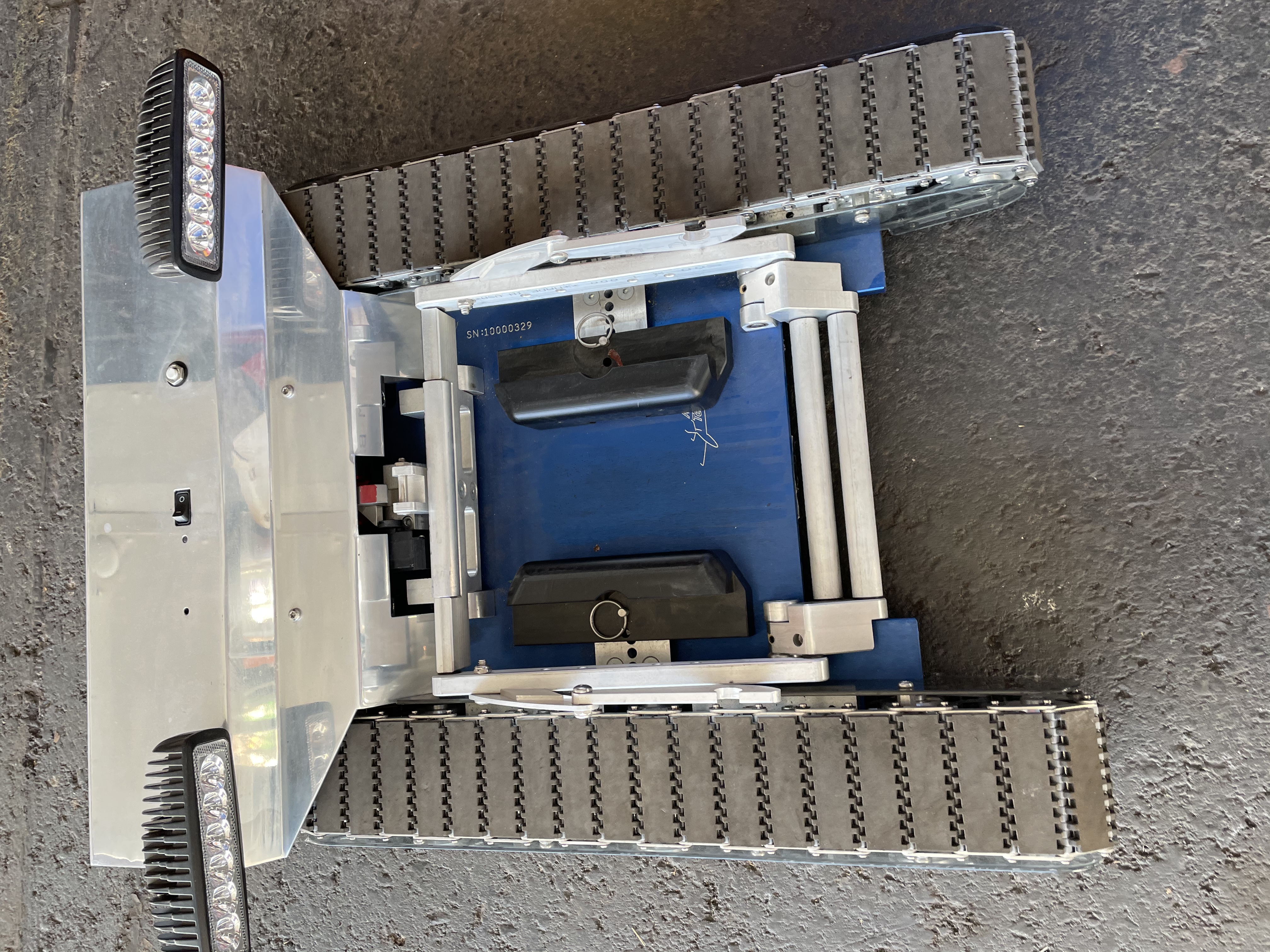

Goodyear, just got my AC Trachtech tug in Jan. Bad hip so no more bending over for straps etc and wife has no more issues. No switching pins for moving Husky or C210. Easily moves Husky on 31s. Expensive; but definitely worth it.
