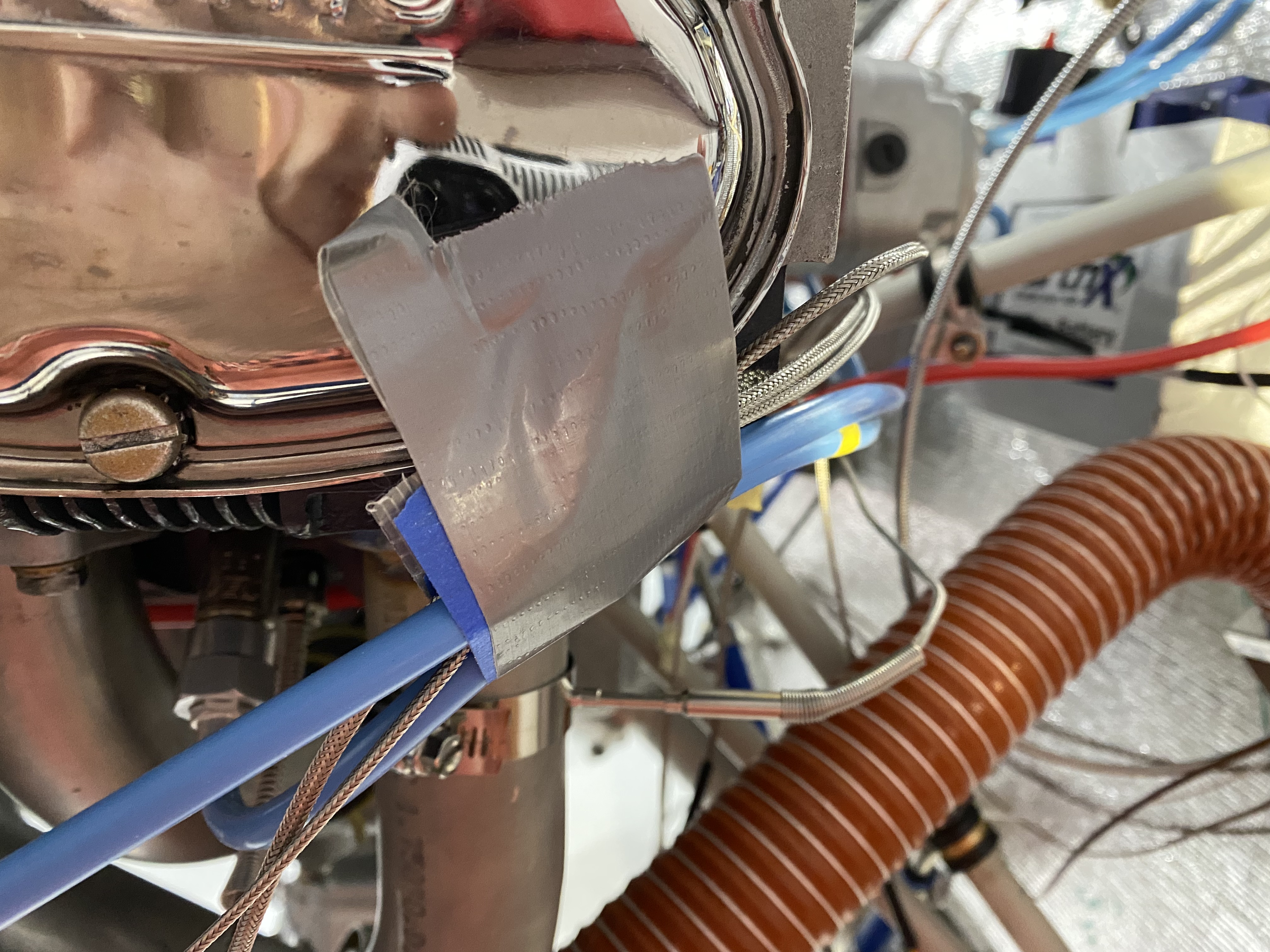

I have been doing lots of work this past week after being away for two weeks of work. All work at the moment is wiring and EMS stuff
Today I installed the EGT probes, installed the circuit breaker between the alternator and Master, made the wires from alternator to master and installed the pass through for the EMS wires.

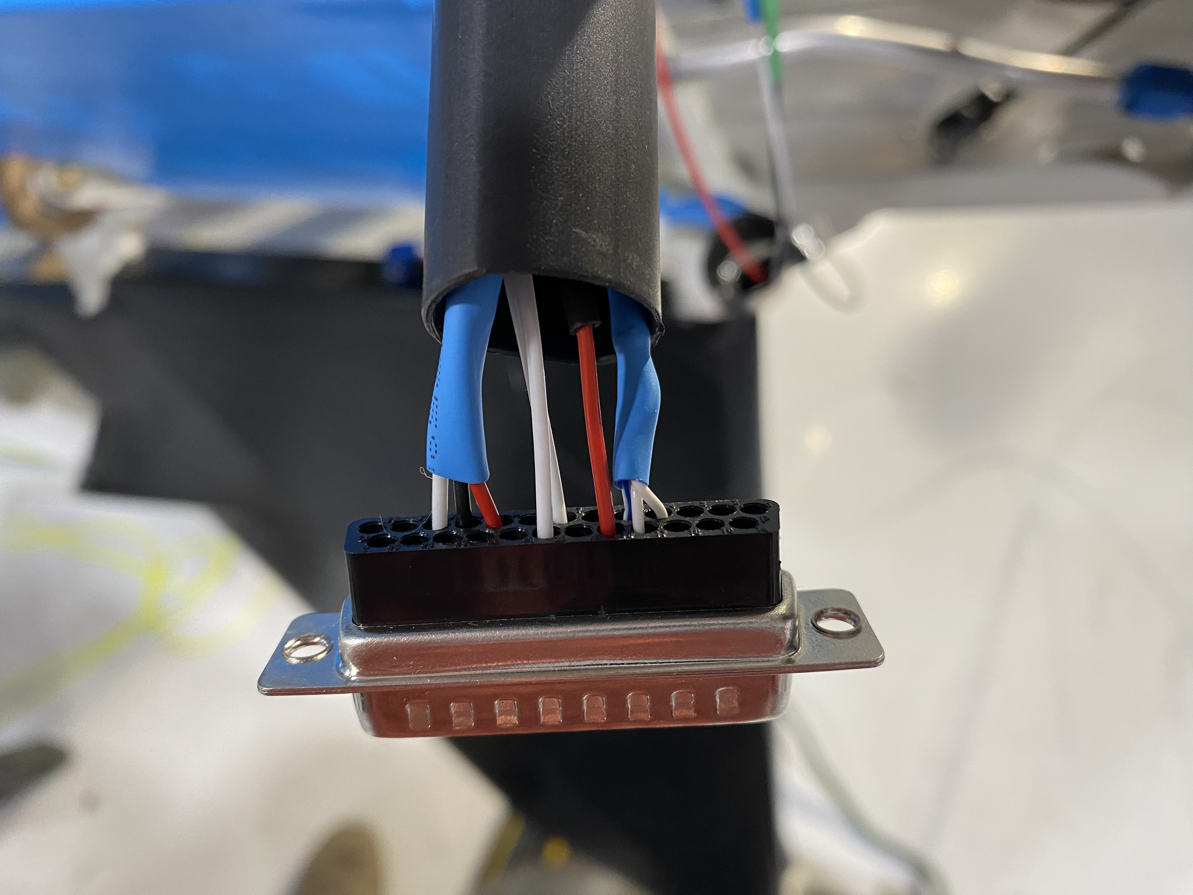

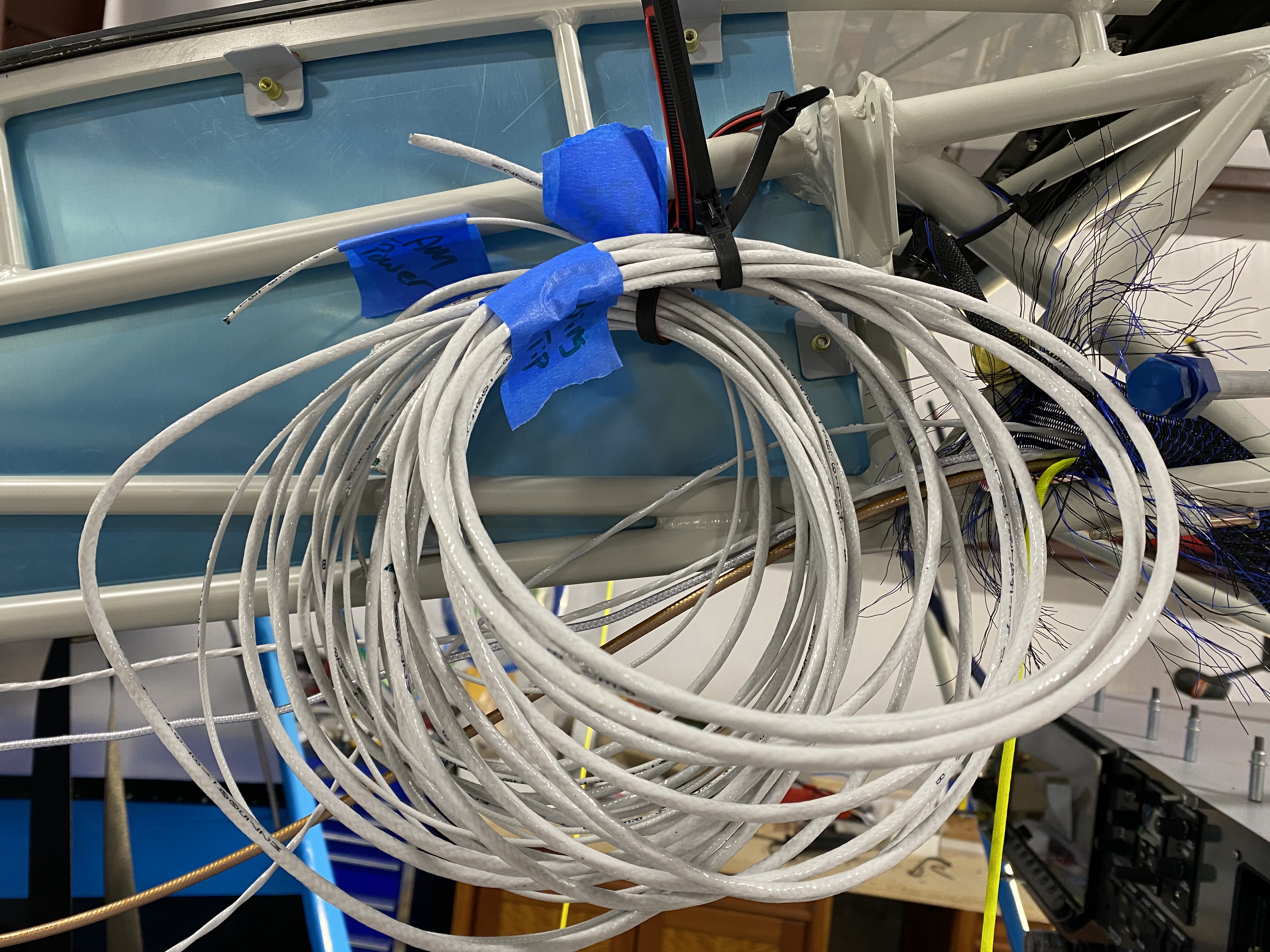

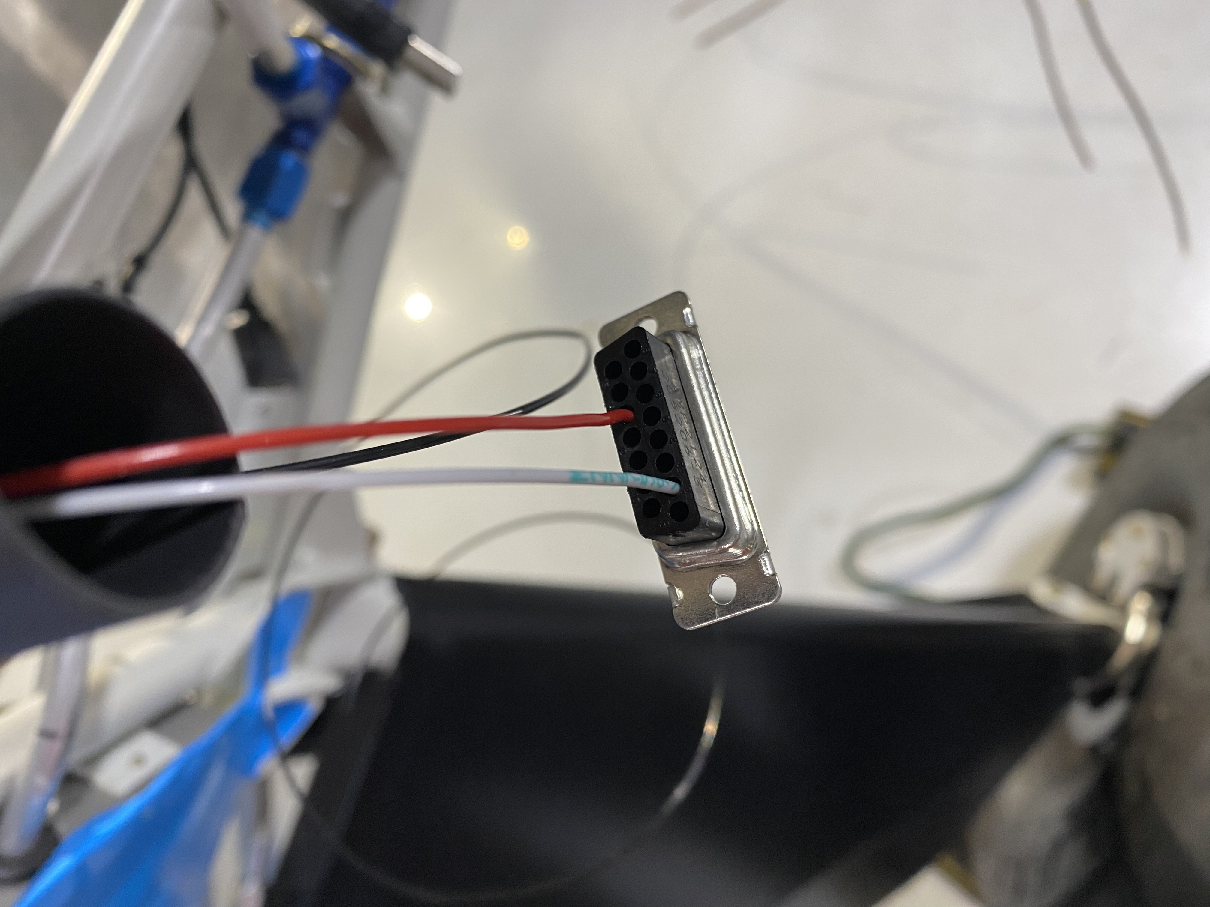

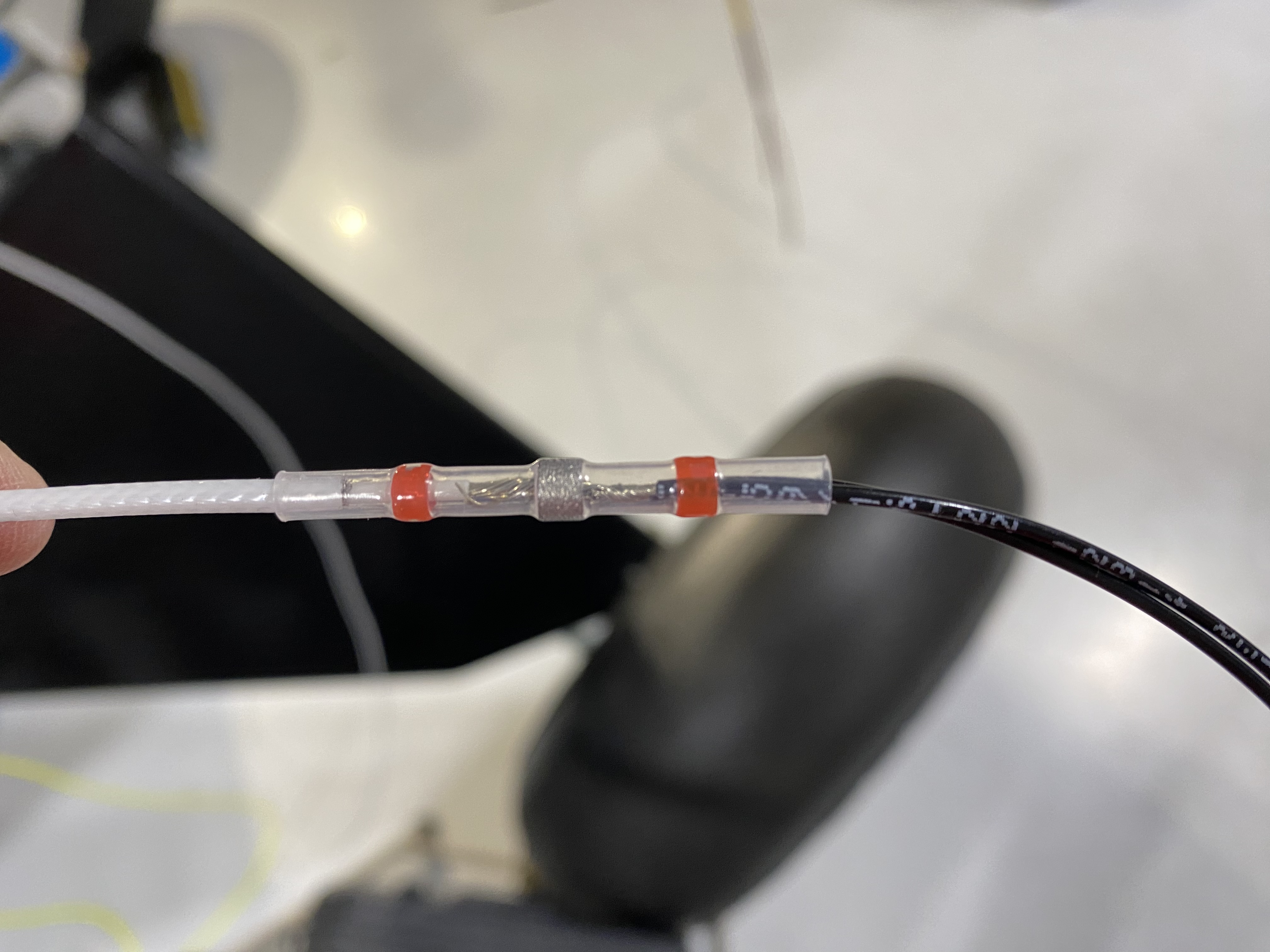

Measured wing wiring, fished it down the sleeve in front of the right door and did all of the fuselage end of my right wing wiring. 2 were 4 conduit 18ga shielded, and one was single shielded 18ga. Due to the D-Sub pins only allowing for 20-22ga wire, I had to downsize via solder splices. Light power has two pin locations in the D-Sub, so it was not an issue.

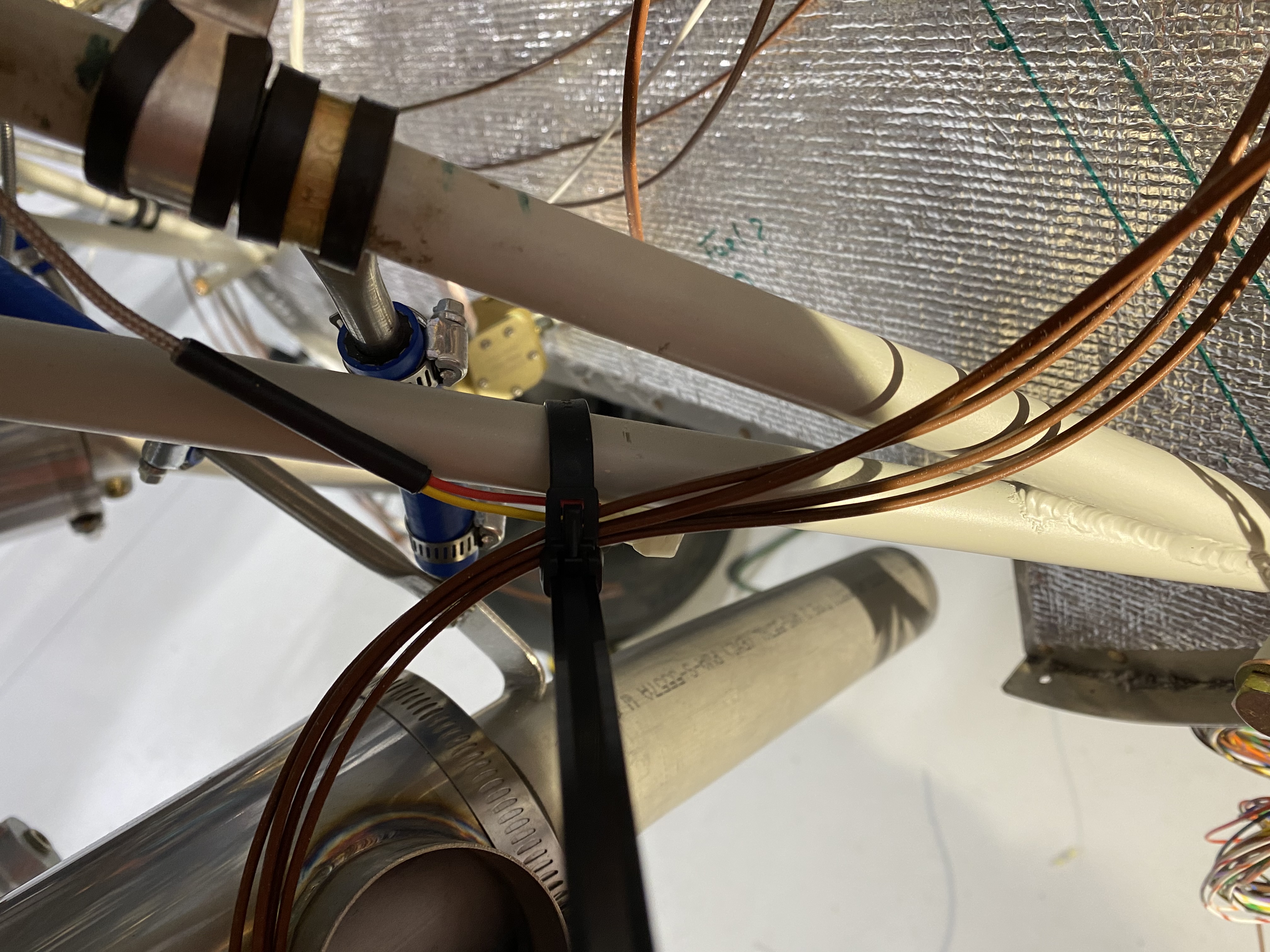

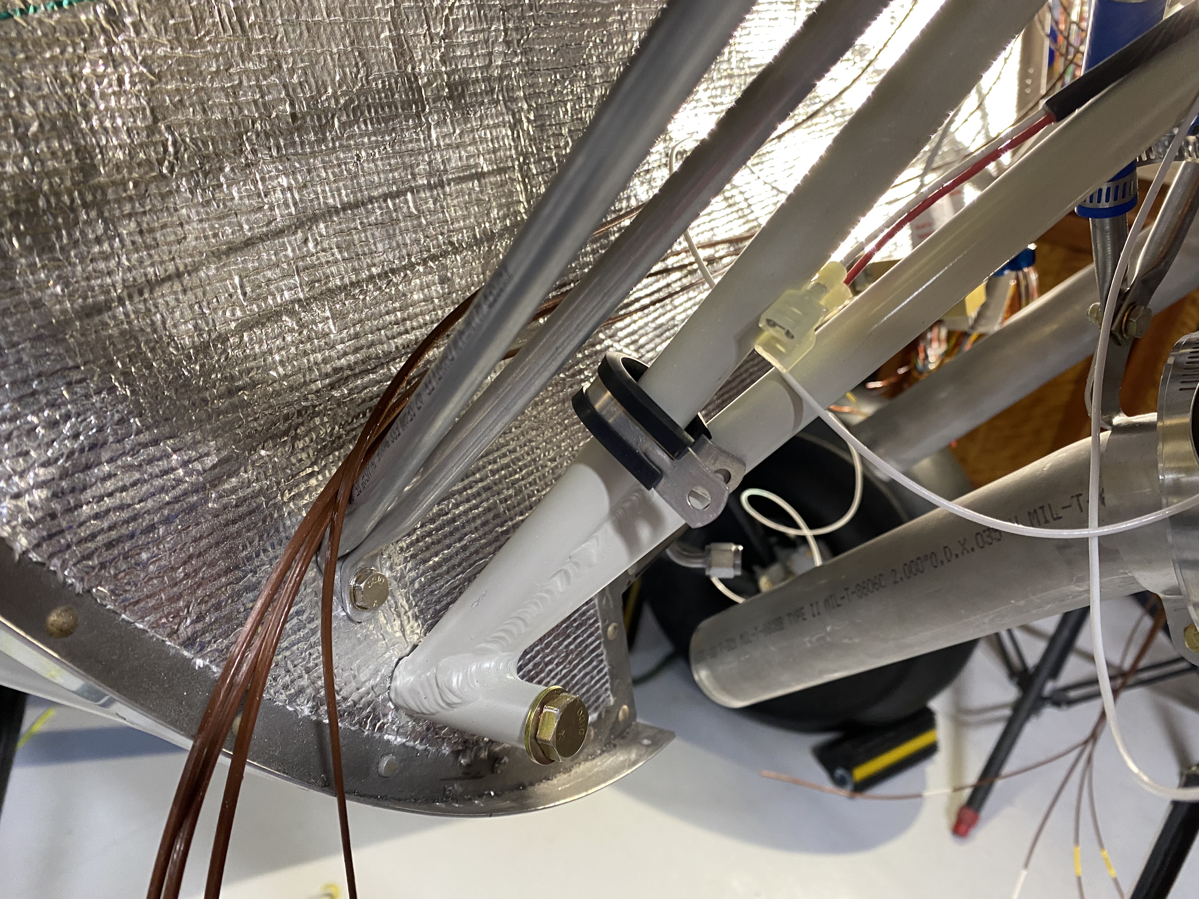

Finalized EMS wire routing, firewall to right side will be left to right along the firewall with adel clamps, engine mount will be used to route the wires for the CHT’s and EGT’s
Sorry, photos would not upload, but lot of progress made
