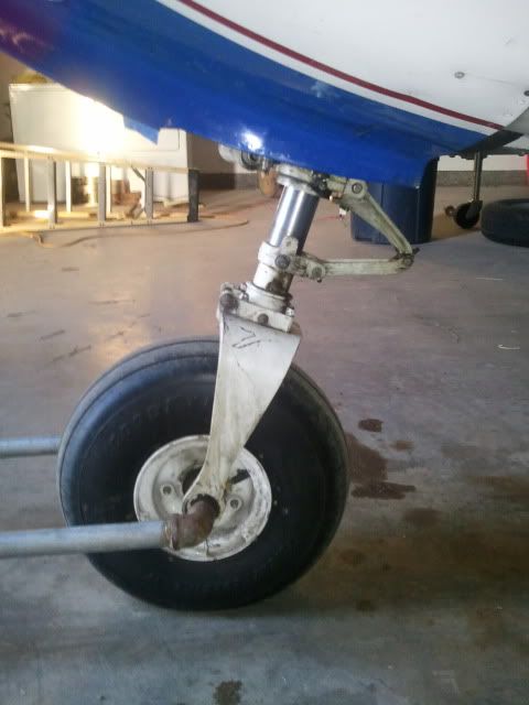

The pic of the hd fork looks like it was added on incorrectly. Tube needs to be cut down and scissors need to go directly to fork. Otherwise it defeats a lot of the HD fork idea.

This is my fork, I think it is the same as the one in the picture.
Ordered the Airhawk , hope it fits. [-o<

Law of levers. Larger front tire, heavier fork - higher load. Longer "lever" to the firewall with a long strut tube take less force to bend firewall.
A 5x5 with a cast aluminum fork vs a steel fork with a 6x6 considerable difference. Plus not having the support of the scissors right on the fork. I have not seen any cessna parts manual with the HD fork on that strut tube setup. Check out airglas's HD fork install instructions, same procedure applies when replacing a light duty with a hd cessna fork.

I see what you mean, the collar assembly is missing, just found out its still attached to my old fork.
Will remove it and placed where is supposed to go.
Good catch, thank you.

Not sure there is a proper way. Done as per field approval. I need the prop clearance at my ranch strip. I have a pretty good bump to taxi over. Oh and by the way, on the 56 182 the nose strut is about 4" longer so when you cut off a few inches it is going to end up longer than yours.

I have just never seen a HD fork swapped onto that Light duty style of tube directly before. My 59 182 originally had the light duty with the collar scissor mount, cast aluminum fork, 5x5. It was at some later date changed to the HD fork, no collar, scissor mounted to fork. (optional HD as per cessna manual) Just like motoave's picture. When i bought the plane I swapped my airglas fork to it with 8x8 and 850 mains. The Cessna fork is almost as heavy as the airglass, so If i was converting I would follow the airglas instructions. nice pictorial on BCP. I guess you could mount it anyway you want if it was field approved. Potential problem maybe if your A&P did the install incorrectly, but stated in the application that he installed HD Cessna fork as per option in parts manual, and no inspector actually looked at it.

As I said, the 56 is considerably taller than the 59. I had a 59 with the fork set up like yours. If I did that to my 56 then it would be taxiing in a very nose down attitude. I guess I could take a big rosebud torch and heat up the mains to level it out. I will try to get that field approval.

Fair enough. There is a 4" difference in the main gear height between the two. Might sit nice with 850's all around, but that is not cheap
