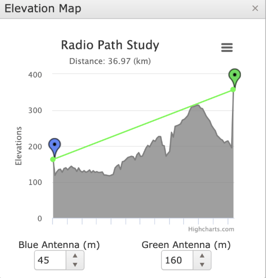

As for Hsivany's issues. He sent me the coordinates privately and I found that he really doesn't have a path until the antenna is on a 200ft pole:
I recommended the multitech rcell GSM modem on top of the pole. It keeps the antenna cable short, and will rebroadcast the signal as wifi. That will allow him to use signal, whatsapp, and if his phone supports volte, he can call/sms text.

Excellent info and references AKSCHU. Never too old to learn new things and this is quite new to me. I can appreciate serving Alaska and other remote locations in terrain exclusive of Satcoms. But Sats are plug and play for voice and text of some form so if mobil that tech and Garmin inReach text can work.
The path plot...might the cell tech support some knife edge propagation over that intervening terrain feature? I'd sure try a pole and see if I could get above vegetation and maybe grab some signal and rebroadcast as you suggest. My knowledge of the rebroadcast method is very limited as mentioned.
I've had some success in my case over terrain with older cell systems when a direct path to the tower has been blocked. And for years I received non-digital color TV from Anchorage to 40 south of Manley Hot Springs off a high reflecting face of a mountain in Denali Park. It's all magic and never give up trying.
