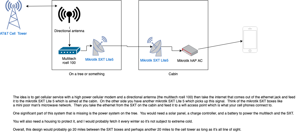

Looking at this more, perhaps a short tower could be built on the hill next to your cabin (on the green side) with a GSM modem, a battery, and a solar panel, that will relay a wifi signal down.

akschu wrote:I recommended the multitech rcell GSM modem on top of the pole. It keeps the antenna cable short, and will rebroadcast the signal as wifi. That will allow him to use signal, whatsapp, and if his phone supports volte, he can call/sms text.

There is no wifi there, and Hsivany's carrier does support VoLTE. So getting cell signal to the tower, then wifi from the tower to the cabin isn't super hard.
Cary wrote:If the cabin is mostly off-grid, i.e., no cable or DSL, the only way it can have WiFi is via Hughes Net satellite in order to have Internet, which is a pretty pricey way to go, just to have cell phone coverage.
Negative. This box will act like a wifi router with the uplink being the cell carrier:
https://www.multitech.com/brands/multic ... 100-series
He would just need an additional sim card which is usually around $10 a month if he already had a family plan.
A WeBoost would work if it was on a tower, but if the tower is on an adjacent hill, then not so much, and as far as I know, would only work for one phone.
If this was my property, I would put the rcell in a box with a battery and solar panel on a tree on the top of the hill, then use a point to point wifi radio to shoot the wifi down to the cabin where I would rebroadcast it. It would give wifi to anything line of site to the cabin, which on my carrier/phone would make everything work. If I had a neighbor on the lake I would ask them if they wanted to chip in and get wifi as well.

Wow! Thank you all so much. I have been scratching my head on this for a long time and now I think I have a viable solution...
Akchu.. special thanks for all the work you did. Your solution is perfect.. those point to point dishes can send WiFi like 5 miles if I am reading it right. I can put them on the hill, or on the other side of the lake (which has better line of sight) and beam the WiFi right to my front door. The links to the equipment are priceless.. it would have taken me so long to find this stuff..

The solution might be difficult to set up, the mikrotik stuff isn't that user friendly, but it's powerful.
If you get the gear, you might consider swinging by my house and letting me help you configure it before you go mount it in the sticks. You know how to get ahold of me.

Here is a drawing of the design:
Untitled Diagram.png (100.4 KiB) Viewed 866 times
A few notes:
1. Mikrotik config is here: https://wiki.mikrotik.com/wiki/Bridging ... s_with_SXT
2. Multitech is the MTR-LAT1-B07-US which has LTE and connects to AT&T
This setup should be reliable, but it's complex and will take time to configure.
If you can just use an in-reach for emergency communications then that is for sure easier. If you want to work remotely from the cabin, this should do the job.

Nice.. very cool.. I see what you mean about the complex configuration. I will definitely have to stare at those documents for a while to piece it together. Getting the gear on order..
