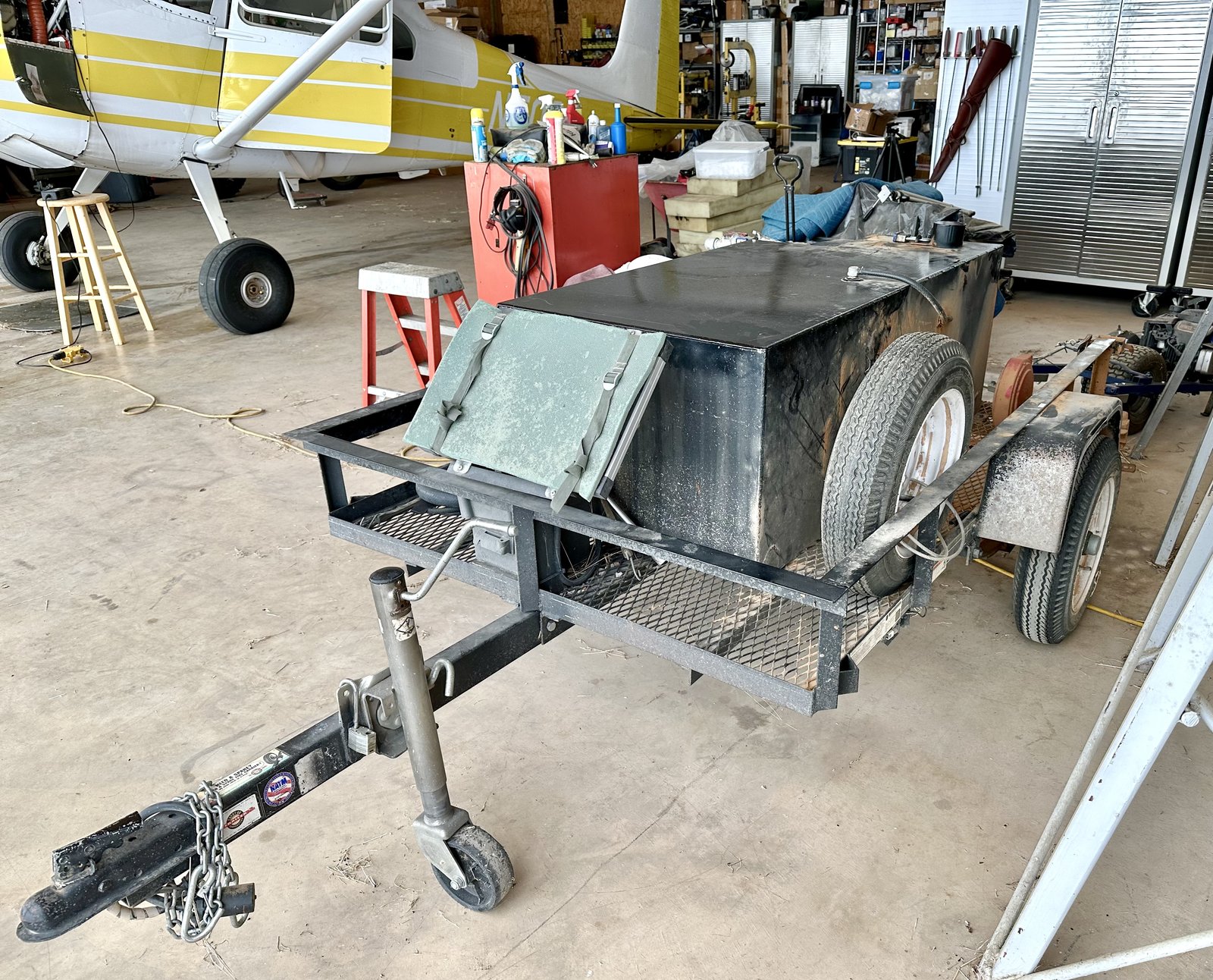

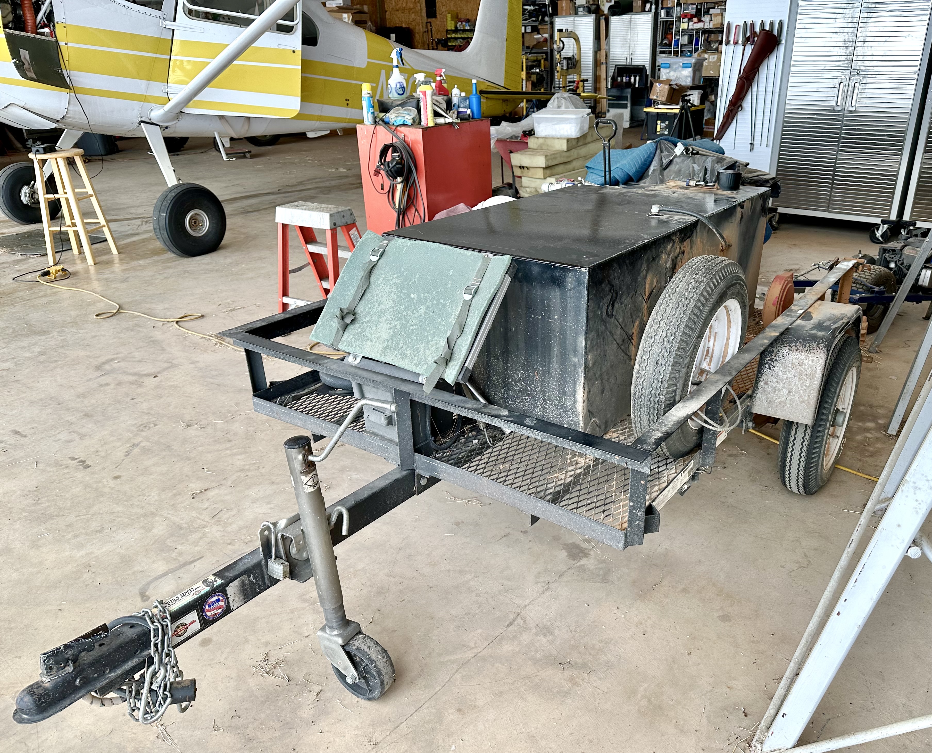

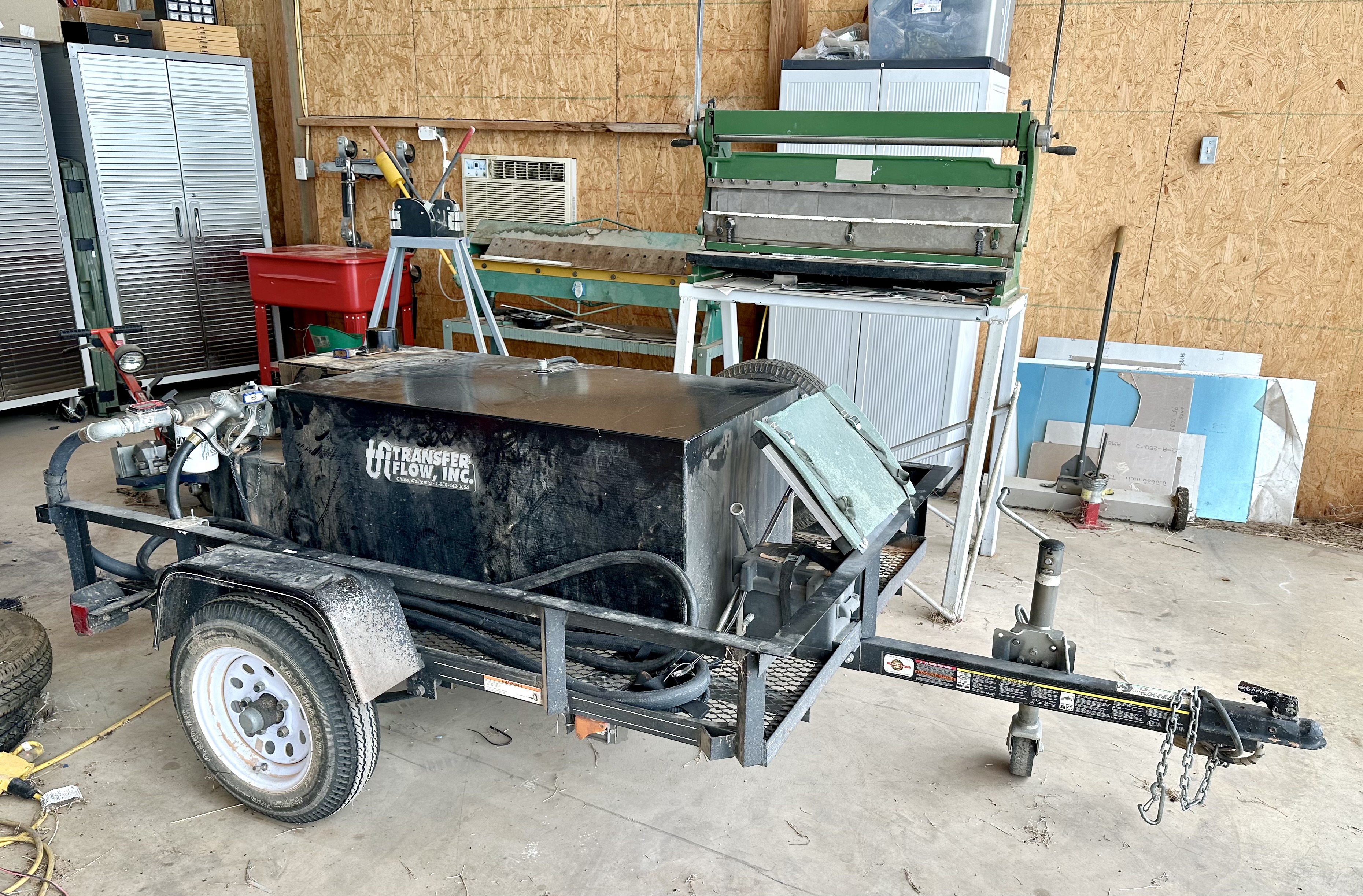

Here’s pictures of my fuel trailer, which uses a Transfer Flow DOT legal 110 gallon tank. Of the two nearby fuel sources one offers self-service 100 LL daily for $5.50 about 40 miles away, the other offers full-service 100 LL daily for $5.99 and is about 15 miles away, but on Sat they give a GA $.50/gallon discount. The solar panel is covered with a sleeping bag cushion material to stop rocks from chipping it.

Nice setup jrc111, and thanks for the pics. Does the tank have a sump or low point drain?

“ Does the tank have a sump or low point drain?”
It does not. However, periodically (after I fill it) I tilt the tank up high in front and attempt to aspirate water at the rear bottom corner with aluminum tubing connected to a 60 ml syringe via nylon tubing and look for water. I’ve only seen a few drops. If I was a forward thinking kind of guy, I would have drilled a hole in the bottom and installed a drain valve before I first filled it. Of course, I sump the aircraft before every flight.
