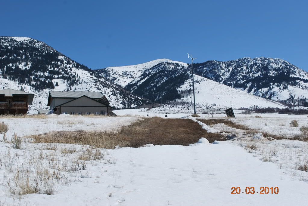

We've got plenty of snow still, it's just a little higher up. At least the runway is snowfree and almost dried out. Image
Re: building an airstrip
courierguy,
Are you using those new Datum skis yet? Looks like you have the snow for it. I'd sure like a report or pictures posted if you get the time. I'm going to wait till the fall before ordering. There's a few questions to be resolved before changing mine over to hollow axles.
I'll be taking notes, and will be set up to help. The only reason I ordered these so late in the season was if the whole scenario for my situation works out as I hope, and next winter I don't spend all my time trying to keep my runway blown out, I have to now NOW as this summer and fall I can prep the winter runway area: pull sage brush, build a ramp so I can start my take off roll (slide?), from the embankment my hanger apron is on down to the general slope the rest of my strip. On my last property, on the same mountain, I had a similar setup to transition from my driveway to the slope of the runway, the ramp works good for my setup.
