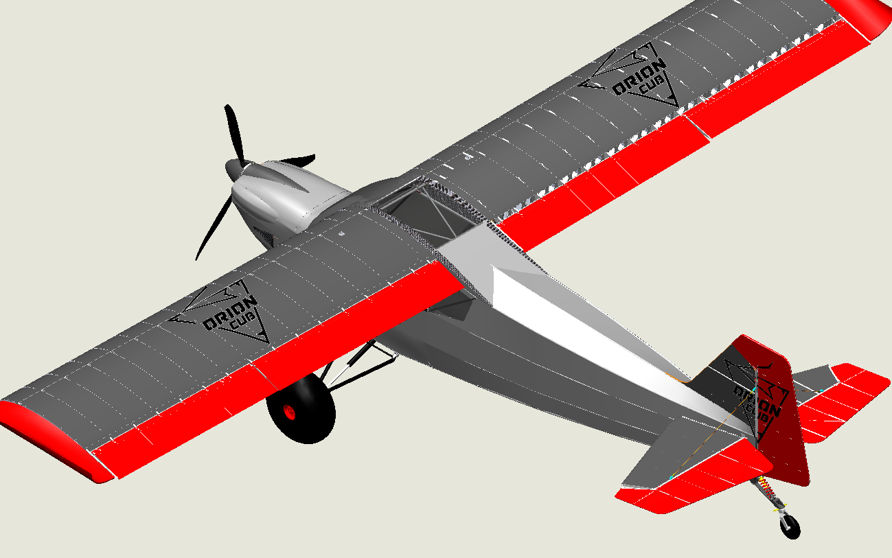

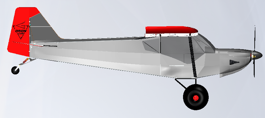

Meet the Orion Cub, a modernized version of the of the popular Super Cub type design. Fully committed to build an awesome new bush plane and work on the prototype is in full swing. Our goal is to offer affordable homebuilt kits and ready to fly aircraft that are capable of proper bush flying, but also have a decent cruise speed. This all happening in South Africa, but plans are to expand to the USA soon.

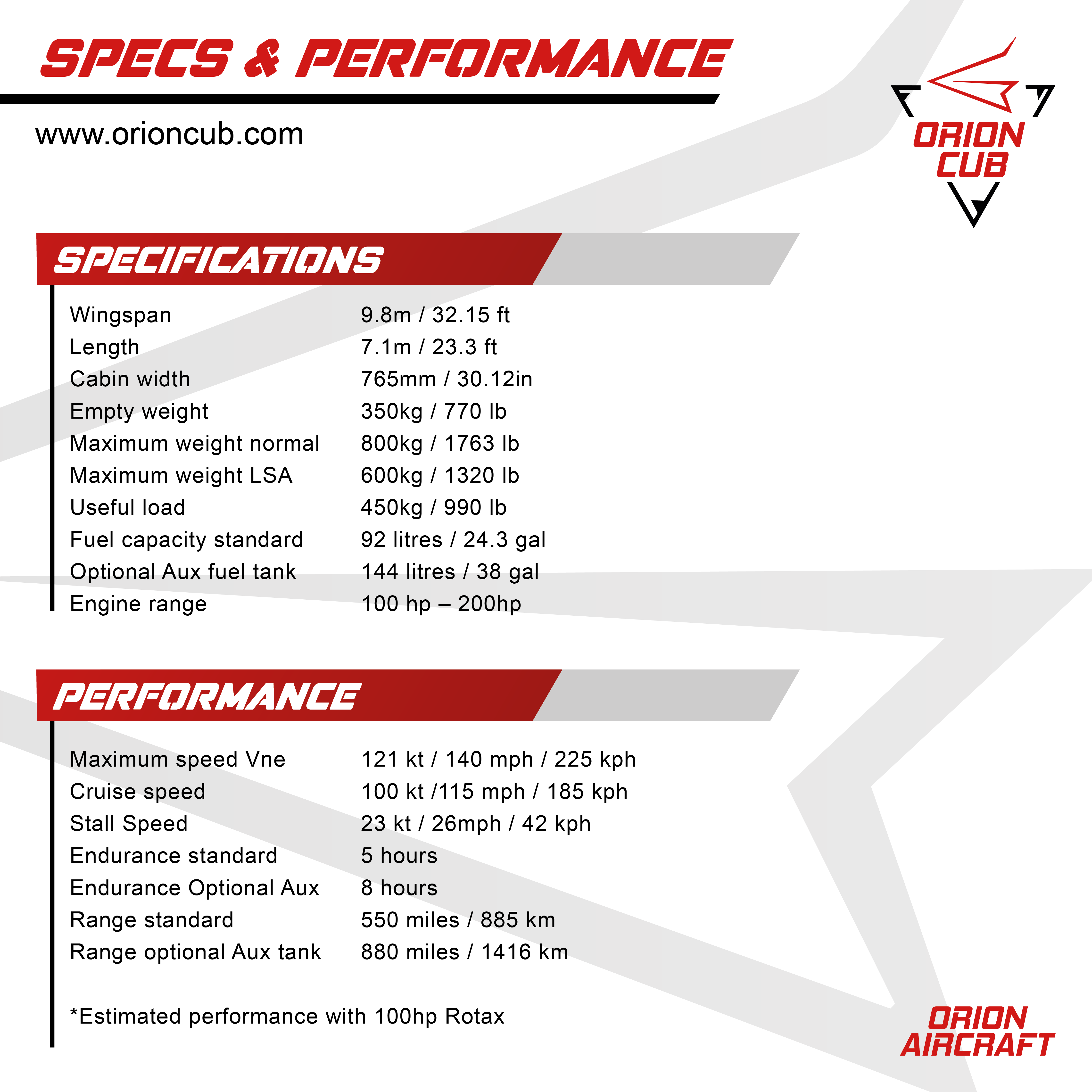

I appreciate everyone's response and the skepticism is totally understandable. Allow me to kindly clear up some of the points raised. The Orion Cub design does not have anything to do with a Rans S-7 design, the aircraft in the videos are just random flying shots of one of the owners flying in his modified S-6. The wing is designed to be an all metal structure hence the single strut, to compare its very similar to the Bearhawk LSA wing configuration with added slotted flaps. The Orion Cub designer and staff have many years experience building a wide variety of aircraft and has won many EAA awards for excellent build quality, so we will most certainly set the standard very high when it comes to the quality of all the parts produced.
Please note that this aircraft has been designed over past 10 years with many many paper drawings to show, so there is definitely not a single design copied with the Orion Cub. We might have gotten inspiration from the best parts from other aircraft and mostly from the legendary Piper cub and super cub, which as we all know is a popular design with many other manufacturers.
We will surely still learn a lot through our journey and I invite you to follow the process with us. It is certainly still early days, but we have a team working on it full time so hopefully we can deliver soon.
Attached are some estimated specs and performance.

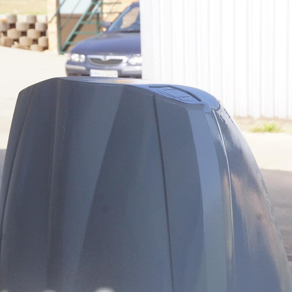

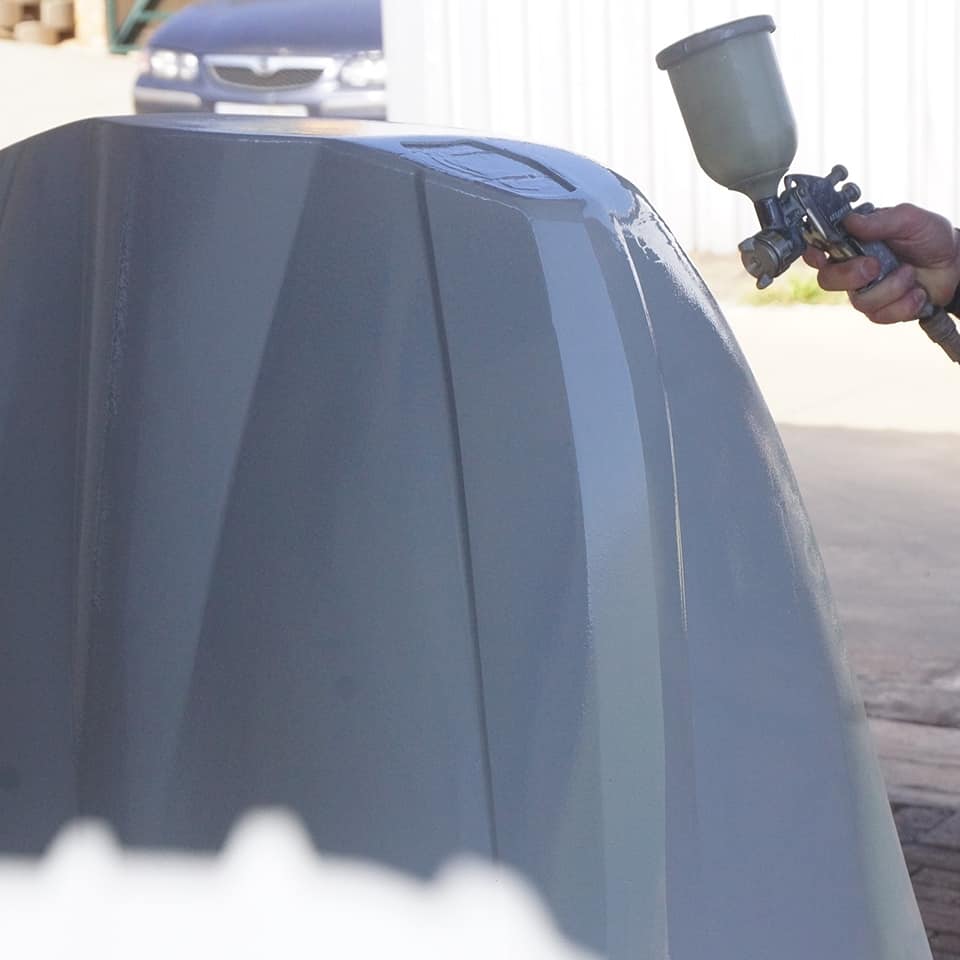

Got some exhausting but rewarding work done on the cowl. Started the cowl plug with some CNC cut foam then worked it done to the desired shape and coated to create the final plug. next will be to smooth it out perfectly and pull a mold from the plug.

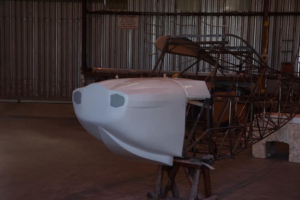

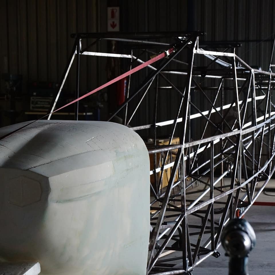

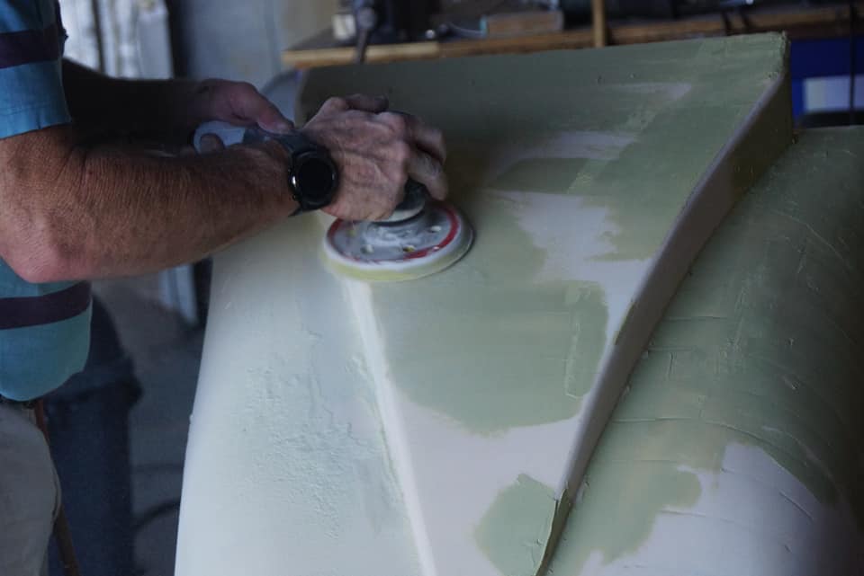

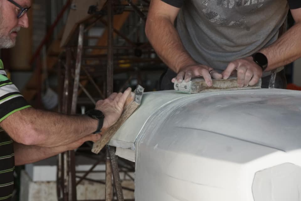

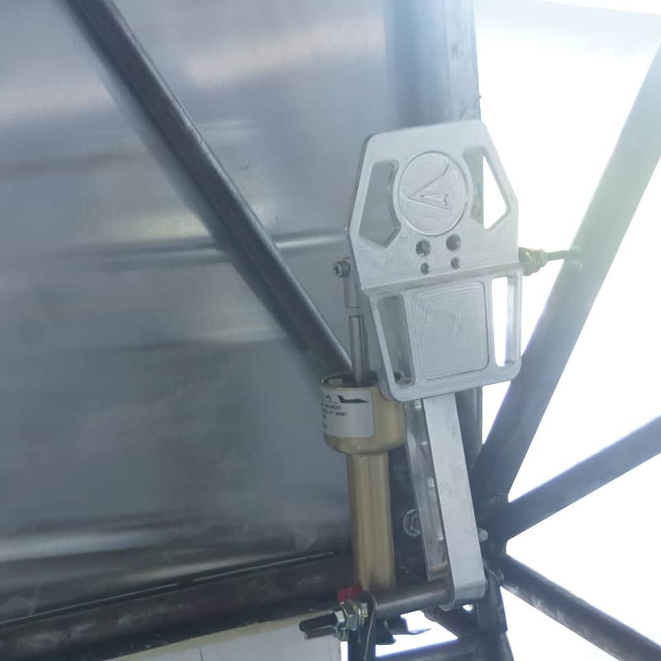

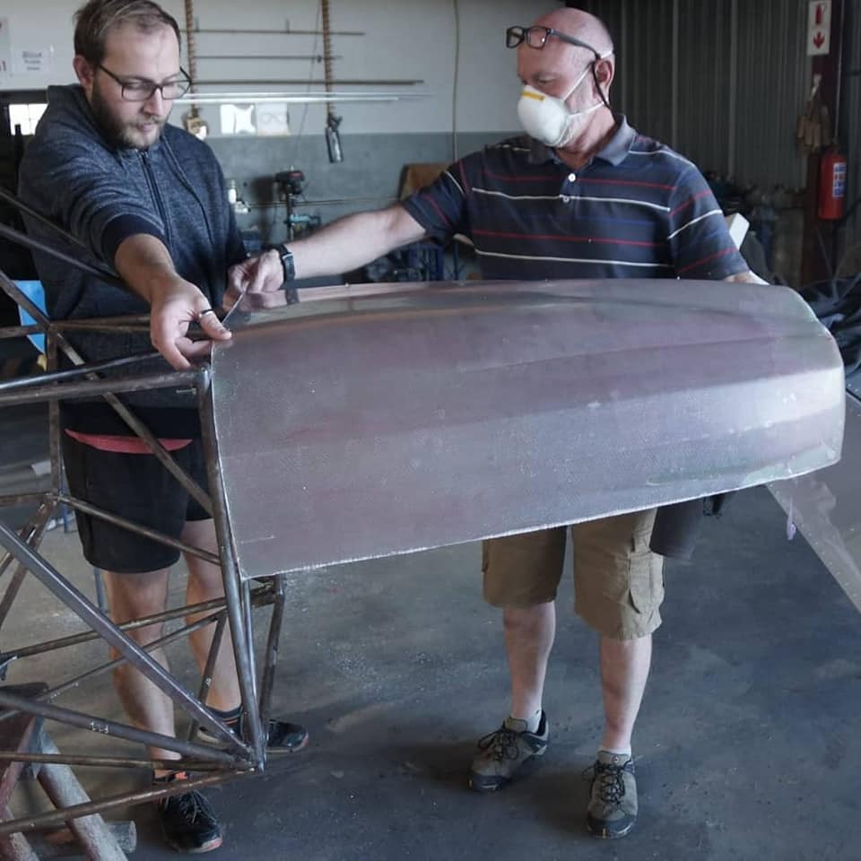

Lots of composite work have been happening the last few weeks, mostly on the boot cowl cowling and engine cowling design, plug, mold and part making.a much easier job was to install the rudder pedals and brakes. We also received our Edge performance EP912STi engine, things are now getting serious!
Check out our latest video: https://youtu.be/rSiNhIGCssk
