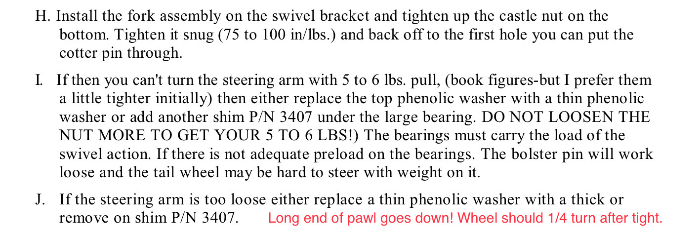

“ Right now I have an ABW fat tire on the tail.
Getting sick of it’s shimmy on pavement when landing in a crosswind.”
Ross, have you checked bearing load? This excerpt is from the Skywagon Club manual (the red text is a note I put in to remember which way the pawl goes). I use a fish scale to check the 5-6 lb pull.

Excellent! I have so far tamed the shimmy with careful attention to bearing load and wheel friction, but it’s good to know there’s another method out there. I had a lot of trouble with an ABI shimmying tailwheel on a Bearhawk, that I never conquered.

Re JRC's 6/4/22 post above:
I had off-and-on shimmy issues with the 10" XP t/w on my 180.
I read a FB post that mentioned the p/n 3407 shim under the big bearing at the top of the fork.
I added one and the shimmy pretty much went away.
It's about loading the bearing without tightening down the compression springs too much.
Like most t/w adjustments, it will likely involve some trial and error.
That said, the fat t/w's are somewhat notorious for shimmying.
IMHO unless you really need the flotation, or the cool look,
you might be better off with a plain old 10" t/w.
