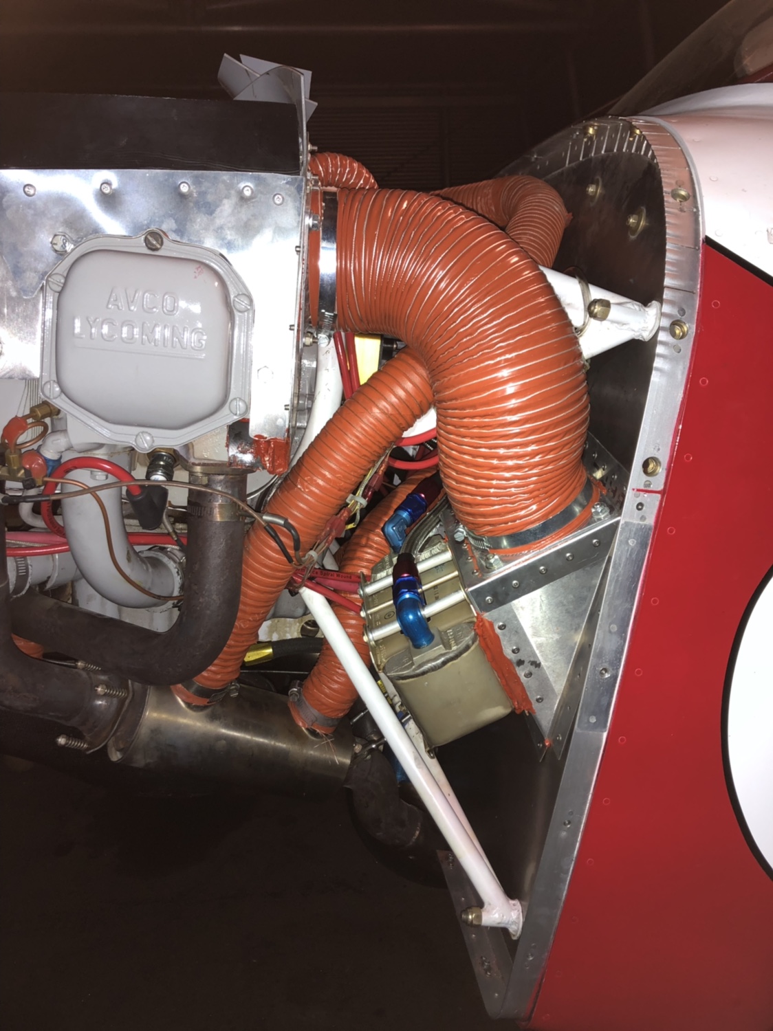

I moved my oil cooler to the firewall and installed my pmags as well as some minor maintenance to my exhaust and baffling.

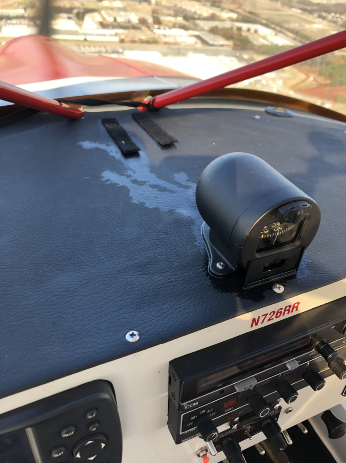

During the flight I noticed my compass was leaking so I have a rebuild kit on the way for it. If it’s not one thing, it’s another!

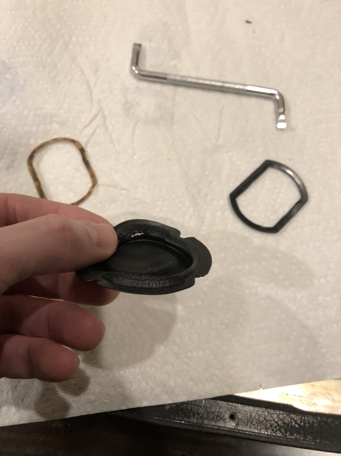

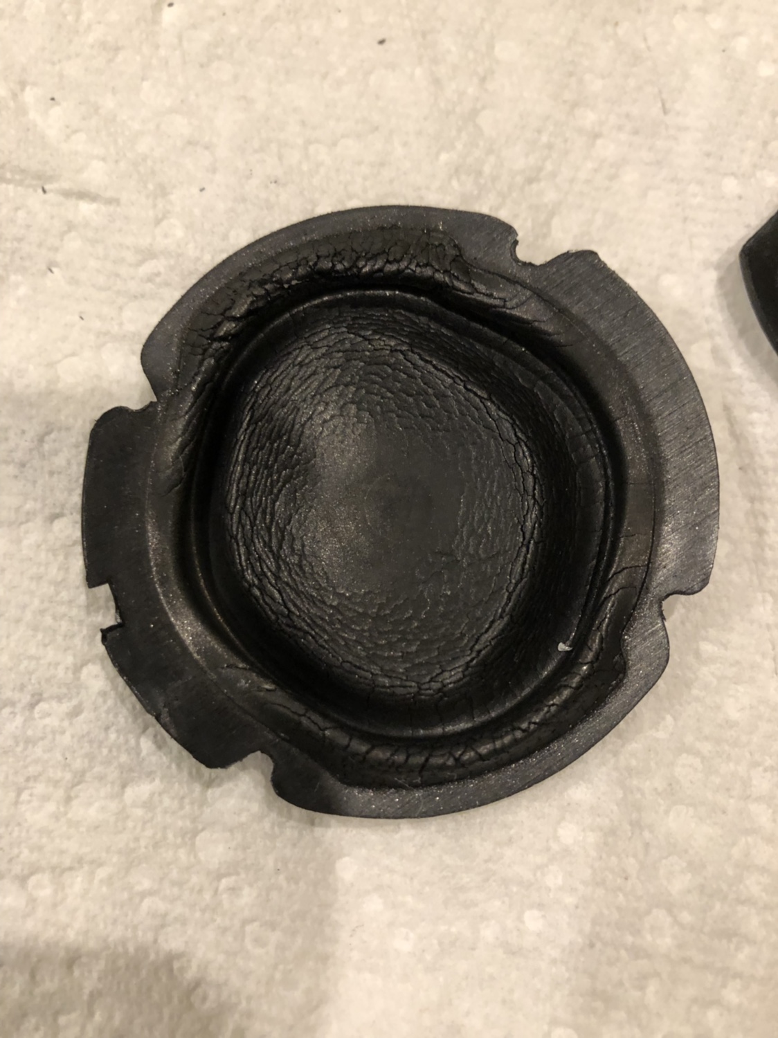

Fixed the compass. $12 kit saved some money for sure. Pretty easy fix, once you get your spouse past the idea of a Tupperware full of kerosene in the living room, hahaha.
Fixed!
Old parts:
The diaphragm was definitely the problem.

On another note, high oil temps are a thing of the past.
OATs were ~55 deg F.
