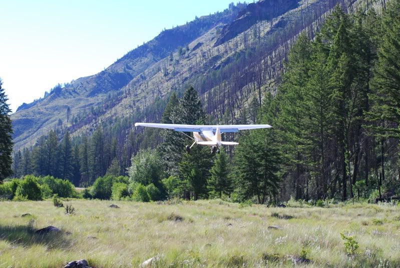

Re: Cessna 170A or older 182
Nizina wrote:I would not take the 170 with a 145HP stock engine into the back country -- very much.
I've had mine in and out of nearly all of the Idaho and Utah backcountry strips without a problem. Sure it would be easier with more power, but its still capable with the stock engine.
Here I am leaving Vines, one of the shorter strips in Idaho. Off and climbing with room to spare.

Looks like Vines is 1,100 feet long with no trees at the ends -- but that's not bad for a stock 170. When lightly loaded it likes to fly.

Yup.. I've seen him "everywhere"...!!!!

Rob do you have a 80/43 prop? Probably makes a big difference if you do. If you want a 80 inch prop on a 170 only the C145/O300A engines are stc'd (8 bolt prop) no O300D. I have had 2 170B's, a 180H, a A185F. I am currently flying a 170A while working on another 180H project. If I didn't want to fly on skis out a 2000 foot strip behind my house (middle of the lower peninsula of Michigan) I would have another 170B instead of a 180. The most fun for me is to go shoot landings for a hour on some grass strip, The 170A or B is great fun for that for a lot less operating cost, Just not the same with a nose wheel plane. Well, for me anyway. Right now the 170A is in my opinion a great value, ie priced low, if not careful you will have trouble getting your money out of a 170A when you up grade(??) to a 180. Probably a larger market for the 182. So. just my opinion, if for you the fun is in the flying buy the 170A, if the fun is in the destination buy the 182. When you can afford a 180 you get both. I need to add, I have a friend who has gone to the ID back country for more than 15 years with 170A, he just flies in the morning and plans his trip for the late summer, early fall. Has a great time.

bat443 wrote:Rob do you have a 80/43 prop?
I have an 80/42 which does help the acceleration on takeoff and climb performance. I lost 12mph in cruise coming from the 76/53.
