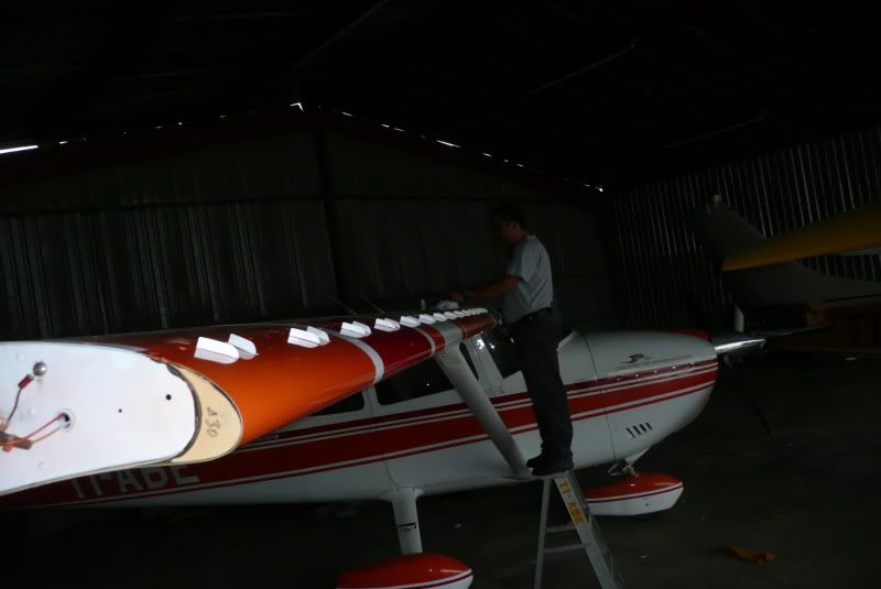

Re: Cessna 170B Sportsman STOL: PIREP
Get rid of the flap gap seals if you want to take full advantage of your STOL kit.
Makes the flaps more effective.
My plane had Horton STOL, VGs and flap gap seals.
I approached for short fields at 60mph, and it felt like sinking under me.
Changed to Sportsman , added the VGs again and got rid of the flap gap seals and short field approaches are at 50 mph IAS.(no sink)
I have 50 pounds in the cargo compartment to have a more neutral CG(helps a lot), dont think the 170 is as nose heavy as the 182 so probably doesnt need it.
See the difference between the stock wing and the Sportsman cuff.
Make sure you re adjust your stall warning.
