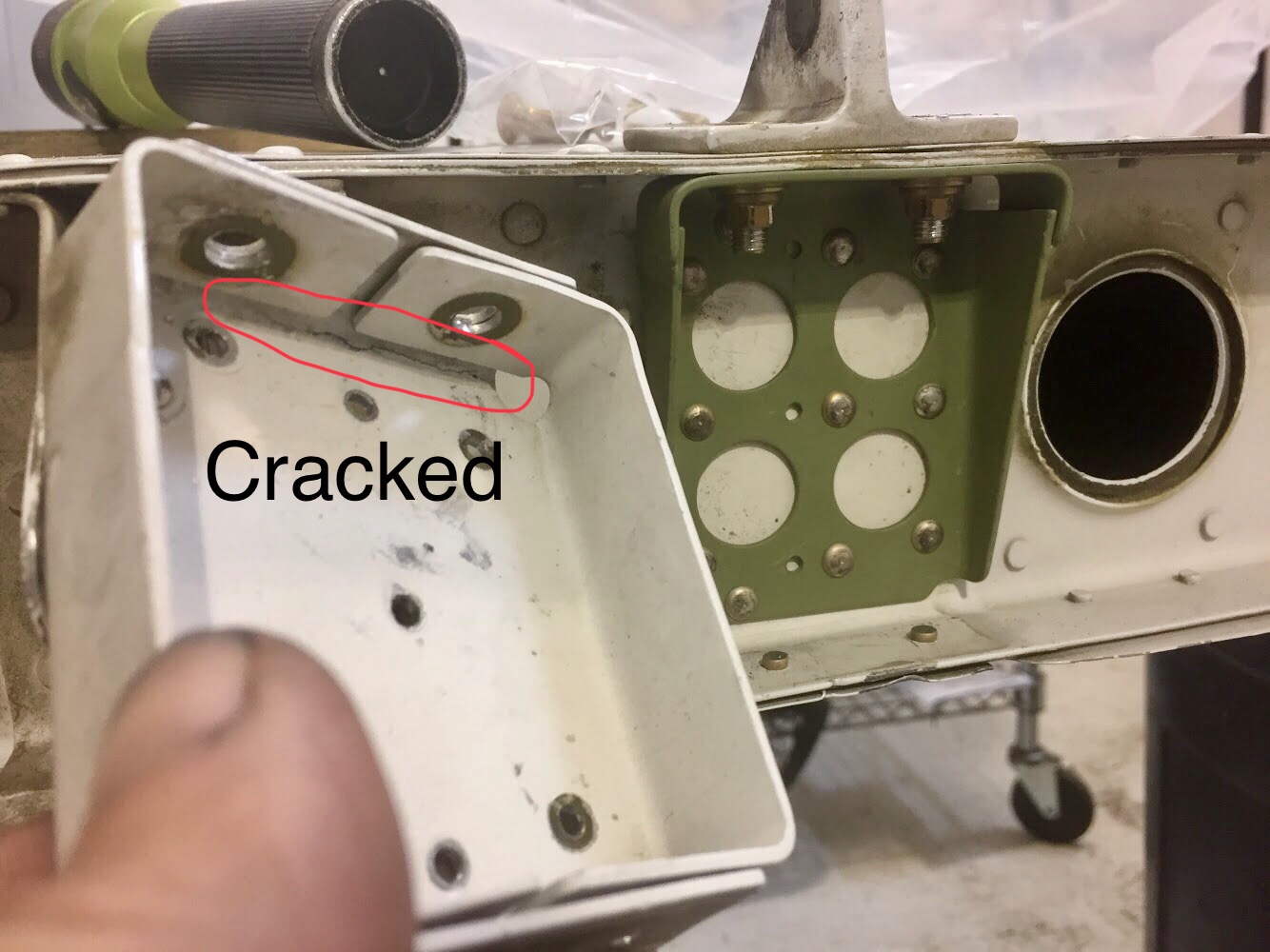

The aft aluminum horizontal stab hinge reinforcement channel is almost always cracked. Good time to install the steel ones.

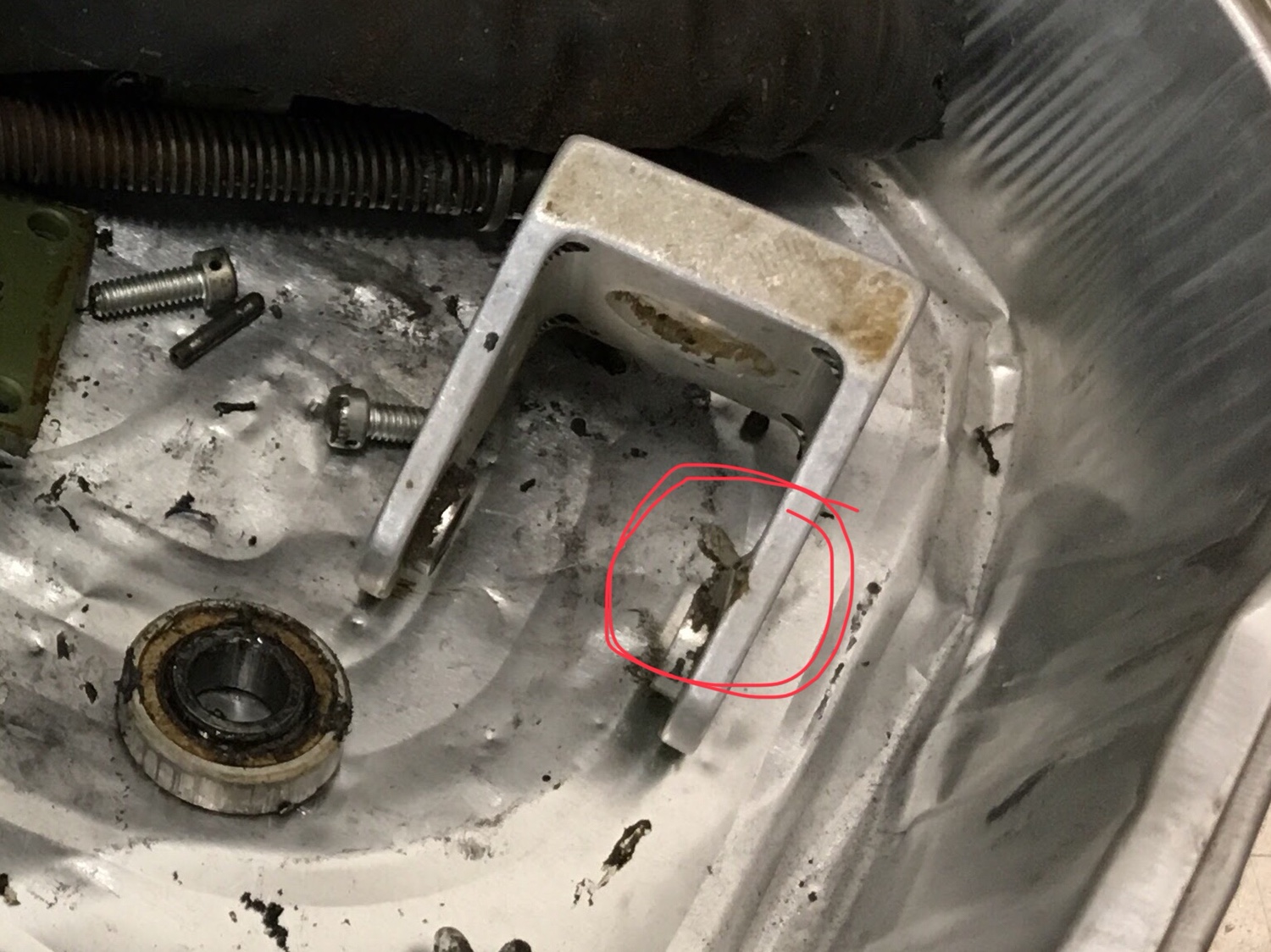

The last few I have taken apart had bad inter granular corrosion on the lower jack screw assembly fitting. It’s crazy expensive from Cessna, $10,000, so if you need one you best find a good used one.

Ditto on the scary part! I’m gonna hope the jackscrew base is fine; even 1/2 of Cessna’s price (which is what Skywagon City usually charges for serviceable parts) is too much (now about $12K ea). Regarding the steel channels, I’m guessing those are P/N 0732603-1 and 0732604-1. They are about $600 each from Yingling. Are those steel, or if not, how do you get steel ones?

Seeing that lower jackscrew bracket with intergranular----then you wonder about lift strut fittings---both upper and lower.

I can’t find the part number right now. The new ones are steel. Here is a photo.
Thanks for posting that picture----I just looked at mine and think it is okay. That cast aluminum hinge bracket looks like it could be fab'd by mating two angle irons back to back and edge welding.
Posts: 2326

So the good news is that the actuator bases had no corrosion and the elevator hinge reinforcing angles had no cracks. The bad news is the LH tailcone reinforcement is broken where it supprts the left aft stab hinge:
Image.
The original P/N is 0712207-1, which has been superseded by P/N 0712048-7 (drilled $2K, undrilled $5K). I’m thinking I need an undrilled part because of the superseding of the original P/N. Another option is a used original P/N 0712207-1 ($1K), which may or may not match my existing rivet holes.

Can't see the whole part from that picture, but could you fabricate (or cause fabrication of) a new one?

Wow for $3k I would deal with a few misplaced holes. It’s usually not a big deal on most parts but I have never changed one of them.

There are about 50 rivets to replace, or many chances to have mismatch, even using oversize rivets (most are -5 already). If the skin was match drilled to the channel/reinforcement, that should work, but if not, there may be problems. Also, the new -7 part may have bigger differences as well. The part has a complex joggle where the stab hinge goes and a 15 deg bend in it’s mid-portion, making me suspect it was formed annealed and then heat treated. That’s out side of my fab skill set. Perhaps the used old -1 part can be purchased and checked for fit, as it’s supposed to be returnable.
