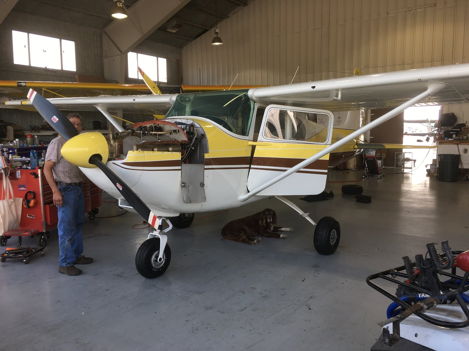

I just had a 310 fork installed on my ‘58 182 in August with 6.00x6 nose wheel and 8.00x6 mains. I think it’s a perfect set-up for my needs. I felt like the Airglas fork would look stupid with a 6.00x6 tire in it. I saw one the other day and I was right. Also, the $2700 Airglas price seems crazy to me. I found a 310 fork for $1000 when I bought the plane in June (yea, it has the little “nubs” on the trailing edges to mount some kind of fender and I thought it looked stupid. Now I don’t even notice it). My mechanic talked me into just buying a new 6” wheel for the nose. $750’ish. Sheesh. Used 40-76A’s are not easy to find and it might only be a $2-300 savings. My plane needed all new tires and tubes anyway so going bigger was a no-brainer for me. My mechanic did have to do some work on the old strut system to get the 310 fork to match up nicely but it seems to have all come out fine. The copper busing at the top of the 310 tube had a hairline crack in it. He used the one off my old fork. My total bill for the fork install, tire/tube purchase and install, wheels balanced and misc parts came to around $3800. It took 2 guys a good part of a day. If you have any questions call Doug or Jake at Dew Aviation in McCall. They got me a field approval in less than 4 weeks, Zane has a copy of it.
