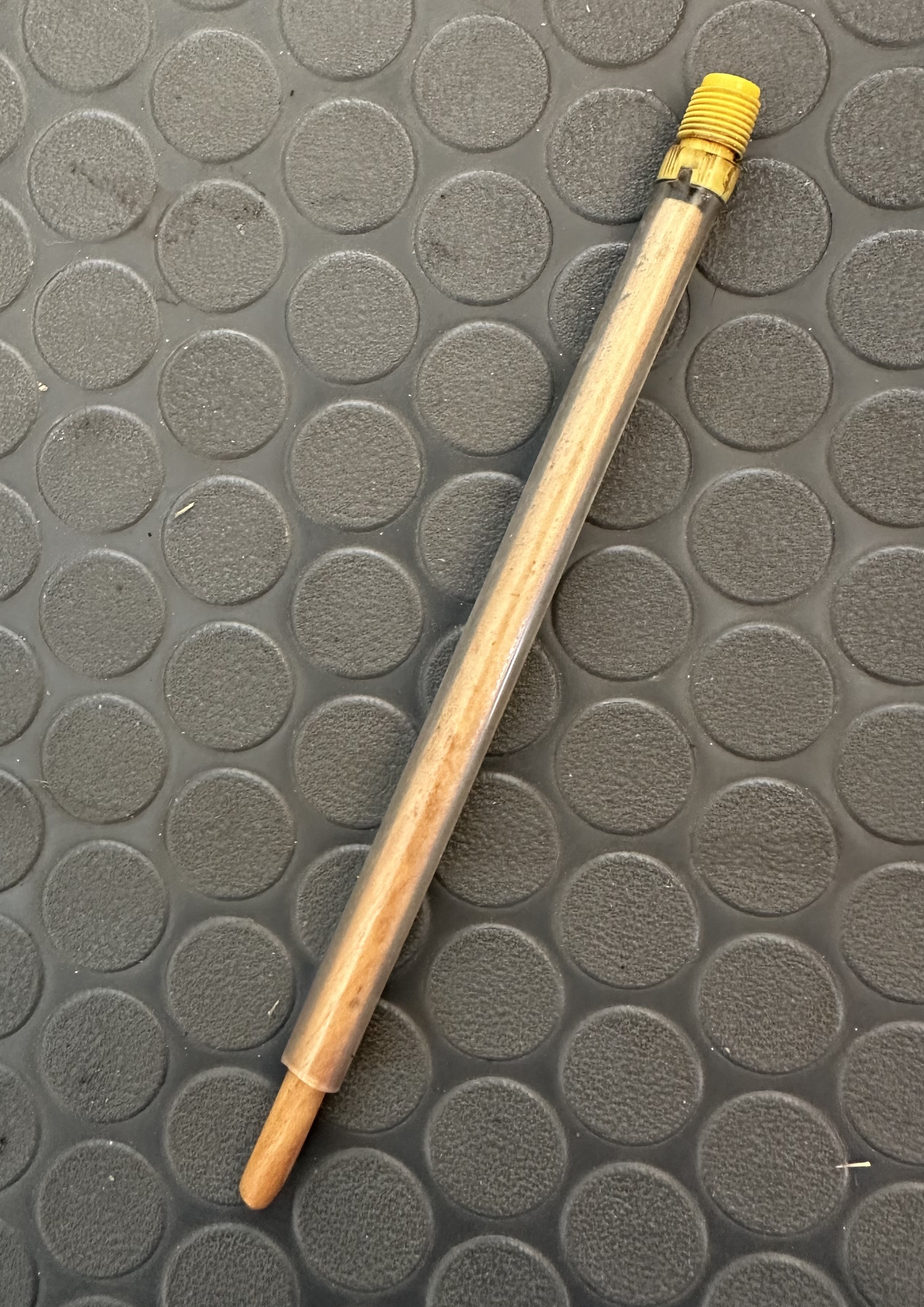

I am trudging through the 100 hour on my C180B this week, and was topping off the brake reservoirs, when I had the thought that my method had evolved over the years. I take a length of 1/4” ID nylon tube and augment it with a length of 1/4” OD repurposed dowel, and use it to capture the reservoir cap after first loosening the cap a turn or two. This elegantly constructed device aids in both removal and installation. When I first started doing this years ago, half the time my too large fingers would drop the cap and hilarity would ensue as I tried to find it and recapture it. This method is also useful for other fasteners on occasion. I also use an oil can loaded with hydraulic fluid, a length of 3/32” nylon tubing and brass tube on the end to direct the fluid into the correct orifice (not illustrated). Perhaps someone will find this tip useful:

Good trick. I’ve dropped lots of those little plugs. I now use ones with a tiny hose barb on top. Easier to hold.
If you’ve never done it it’s educational to clean the master cylinder and change the lock o seal thingy. Mine had an impressive amount of crud in them.

Absolutely, there is always more than one way to address an issue, your's is very creative. =D>
