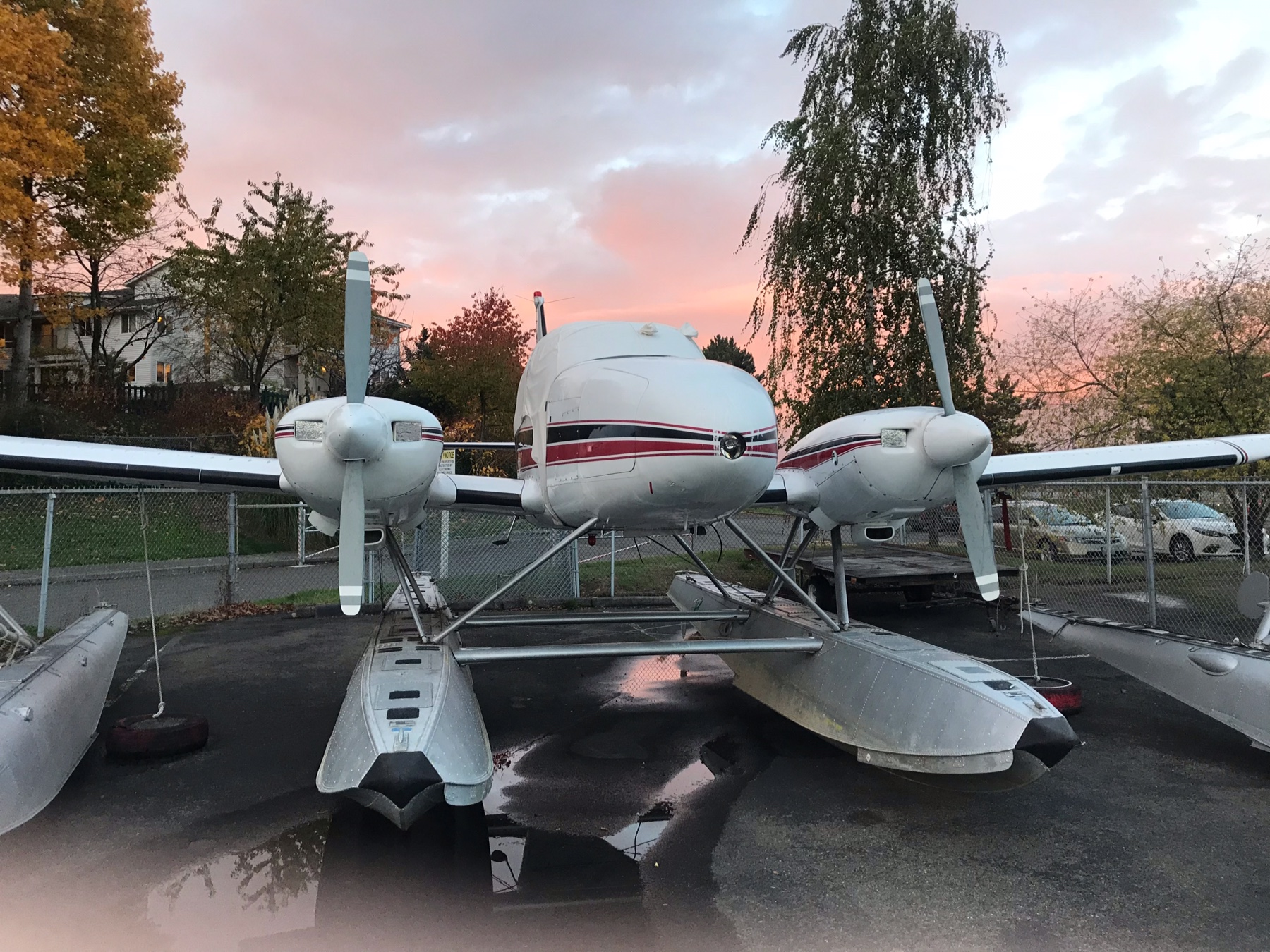

I did my multi sea in that airplane, it gave a whole new meaning to the term dog. Mostly the weight of the amphibious floats was holding it back methinks. Unfortunately it is the only one.
Now the Aztec Nomad I’ve always been very curious about. There’s one currently sitting in Renton, I would love give it a try.
