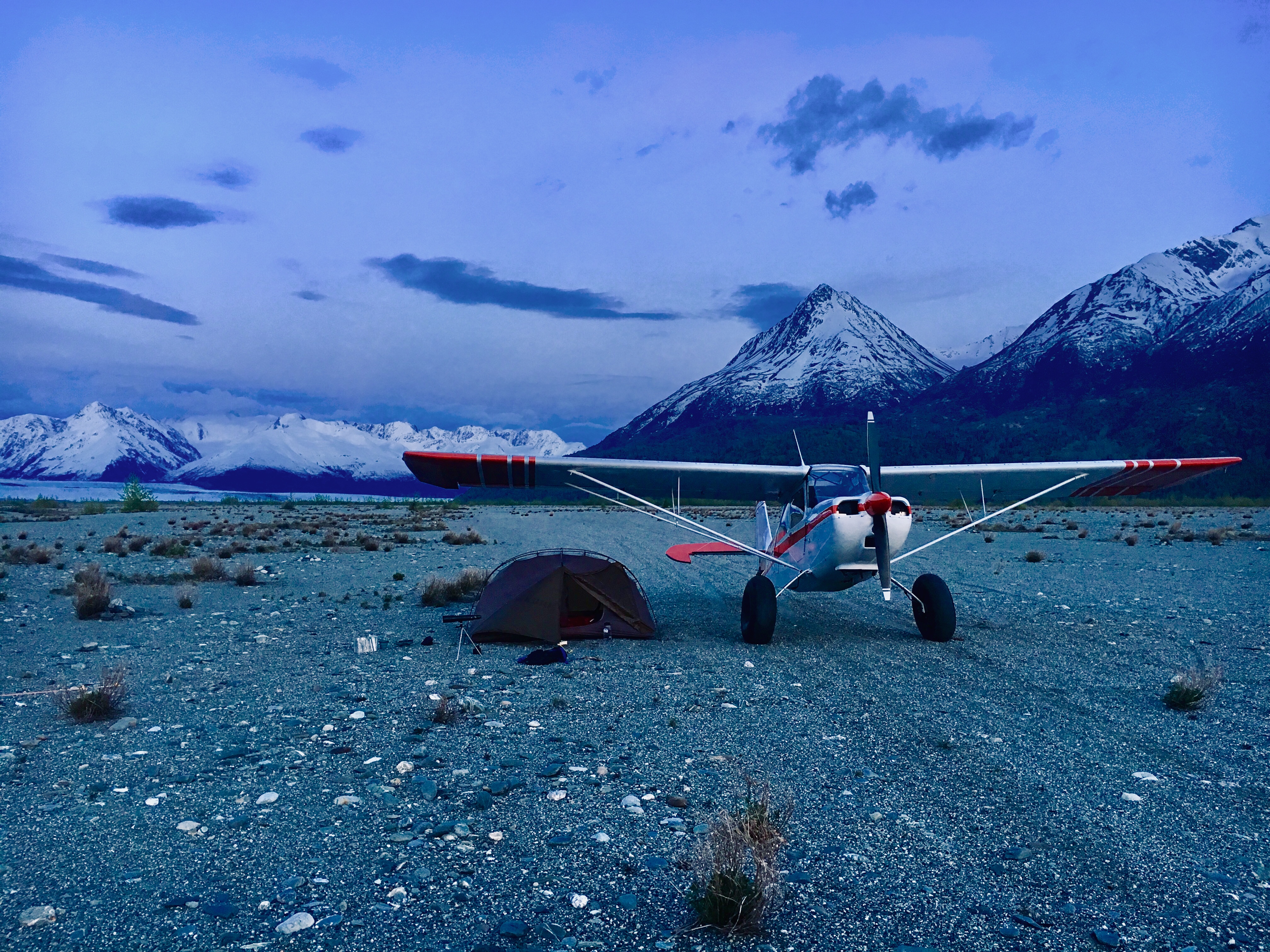

I did a bunch of BC flying with my 76 model. I had the stock 76" prop but had it pitched back to 51, 31s, BBW, VGs and 150hp. I could touch down with power and TW first at 29kts. I really wished I would've had scout main gear on it to give me more angle of attack. I feel like that one of the best takeoff mods you could do to a 7GCBC, but I'd be a bit leery of bending something in really rough stuff. 160HP cylinders also make a nice difference, and still allows you to run 91 octane moGas.
I think the 7GCBC/8GCBC are some of the most underrated planes out there. No they aren't a supercub, but if you realize that they are an excellent bang for the buck. And they are much more comfortable IMO, wider, easier to get in, faster, awesome heaters.
Looking forward to see more pictures of your adventures!Image
