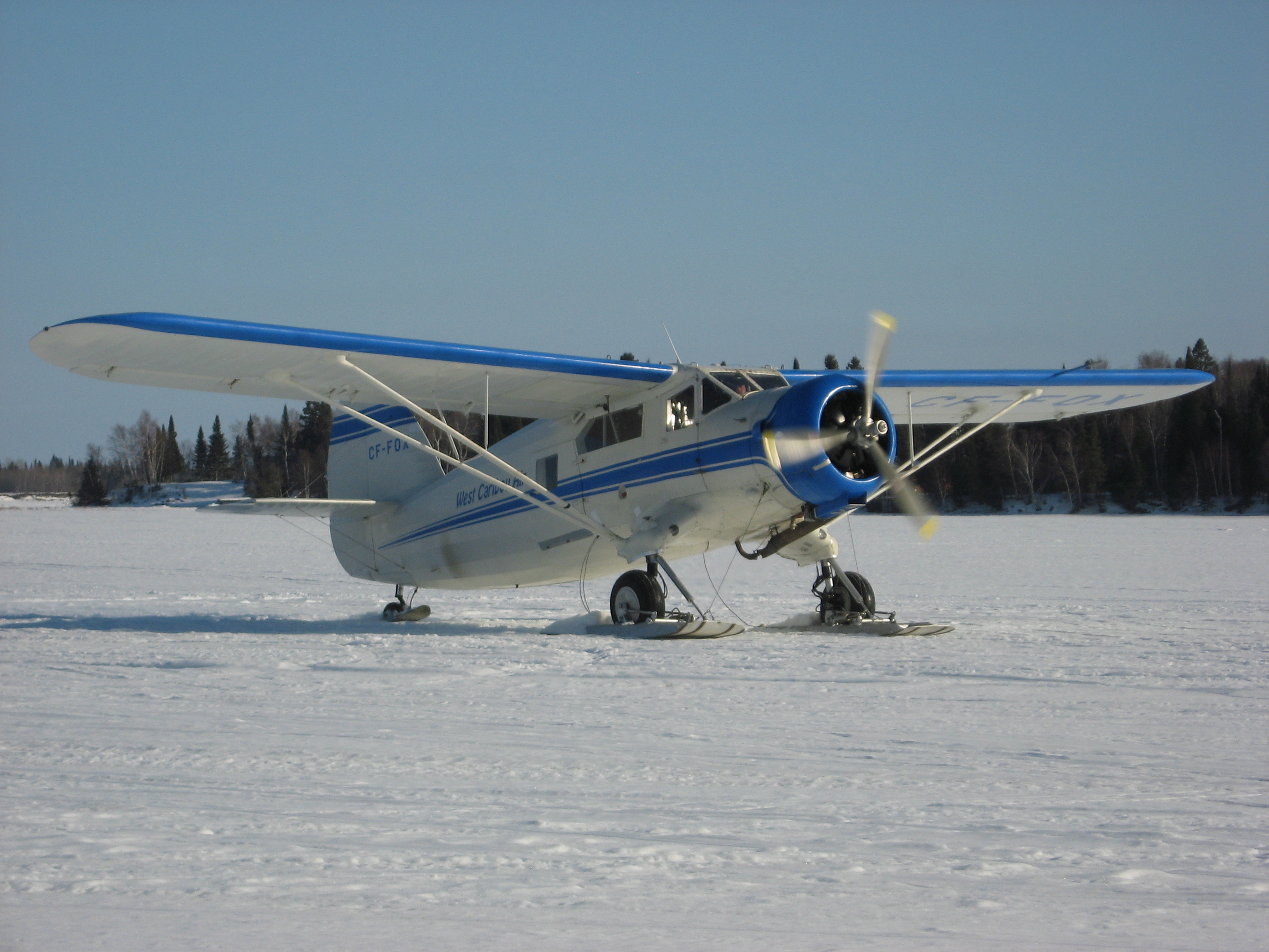

peterdillon, thought you might be interested, this is a picture of a Norseman one of our flying club members used to have.

Hans really struggled to get this Norseman off the sticky snow. Roll the ski like a float :D
Posts: 1458
Re: Collapsible Boat strapped to struts?
BRD wrote:Hans really struggled to get this Norseman off the sticky snow. Roll the ski like a float :D
Those are some serious fat powder skis! 8)

What ever happened to the Norseman that Jeff at Park Rapids Aviation bought?
