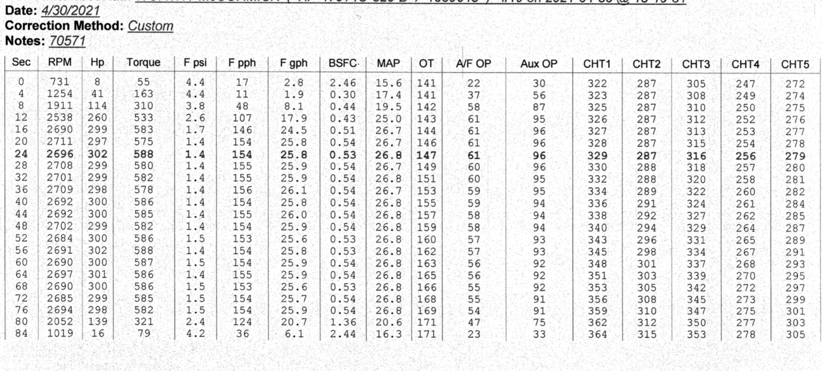

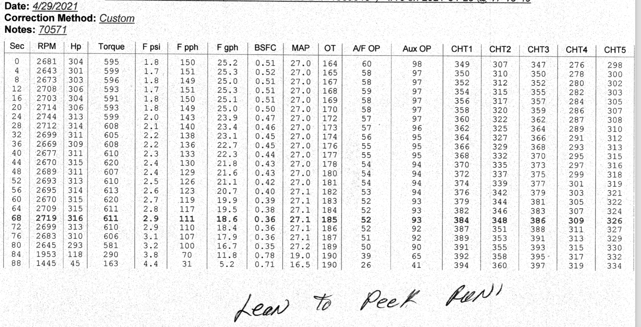

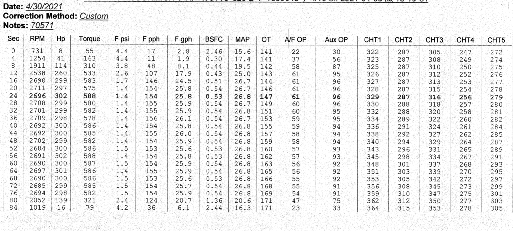

I could never find these docs when searching old posts so I figured I would throw them up here. New engine came off the dyno at 316hp / 611 torque lean to peak. I know there is some controversy about the correction method that is used at Lycon... but anyway, here is some data for what it is worth to ya.

Nice, what was the density altitude during the test?

I really dont know. Altitude at their shop is about 300' and no idea on other variables. Probably pretty low to get those numbers.

Which Pponk engine is this? What displacement? Is it carbed?

It is the Pponk 470-50 but it was built from a 520. Yes, carbed. high compression pistons. I've got a 3 blade MT on the way, Acorn exhaust, and SPW mount... so we will see how this 58' straight tail does in the air.

Very cool. Seems like the port and polish did grab you a few extra ponies too. I'm looking at doing a ported and polished i0-550 at overhaul time.

Does anyone know what continental uses for mixture settings when they rate an engine? Just asking because it seems a bit of a marketing gimmick to say it’s a 300 hp engine, but not at an authorized mixture setting for normal operations. I know, I’m mixing engine operations from a POH, but most of those don’t allow leaning when above 75-80% power, so in the real world a 300 hp engine on the stand (leaned to peak) is something less because it’s running 250+ deg rich of peak.
Perhaps the important thing is a consistent method across shops so we consumers can compare since installed hp is often less than test stand data.

Ly-Con builds a clean engine no doubt, but a lot of their mods are questionable. A fair amount of “Snake Oil” claims. I have seen several of their port and polished engines that had to run high fuel flows to keep the cylinders cool enough to last any length of time in service. More is not always better if you expect any longevity. Peak power at some ridiculous lean mixture with unrealistic correction factors on the dyno is smoke and mirrors.-Lots of folks throwing tons of coin and not thinking things through.
