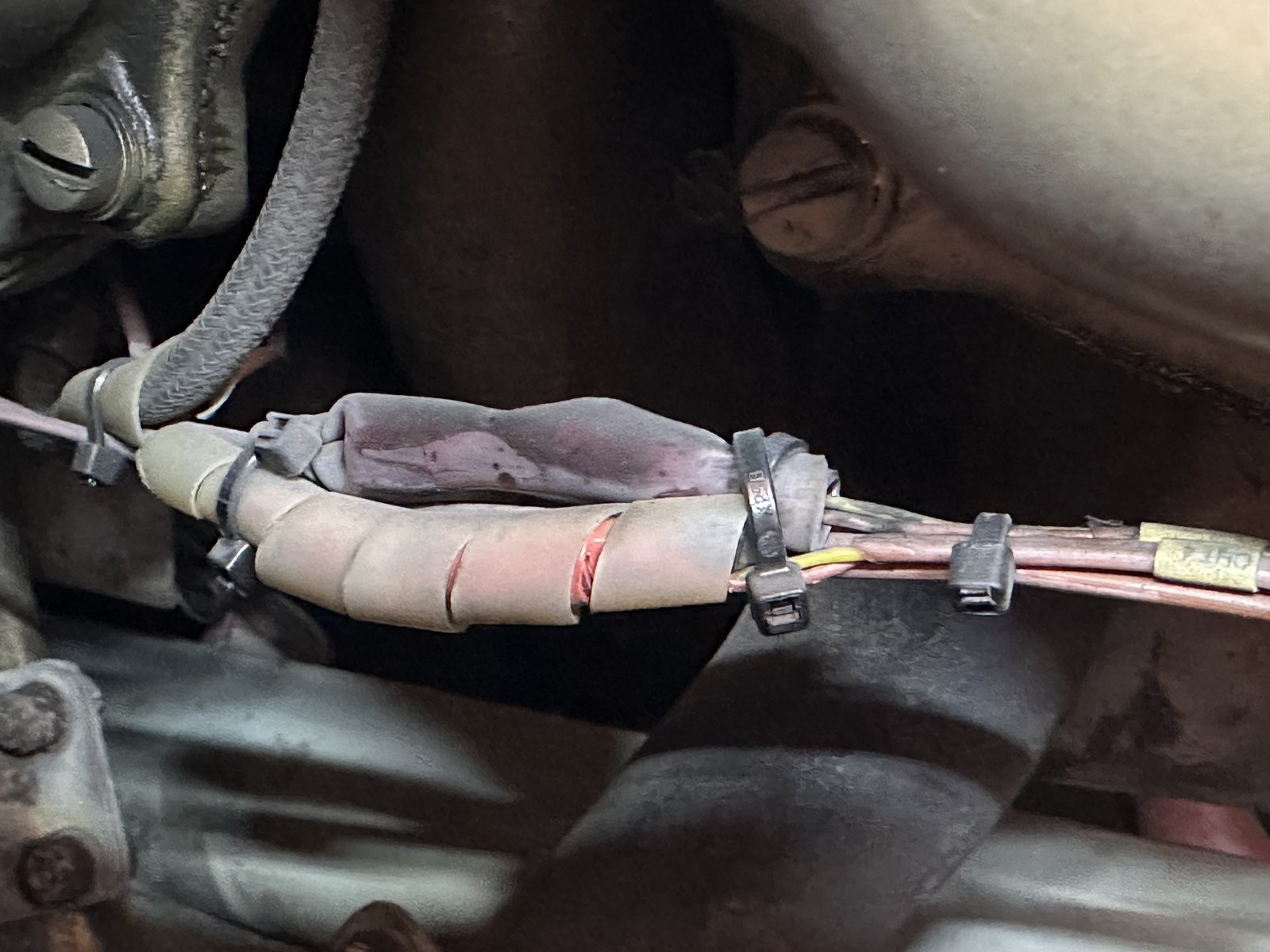

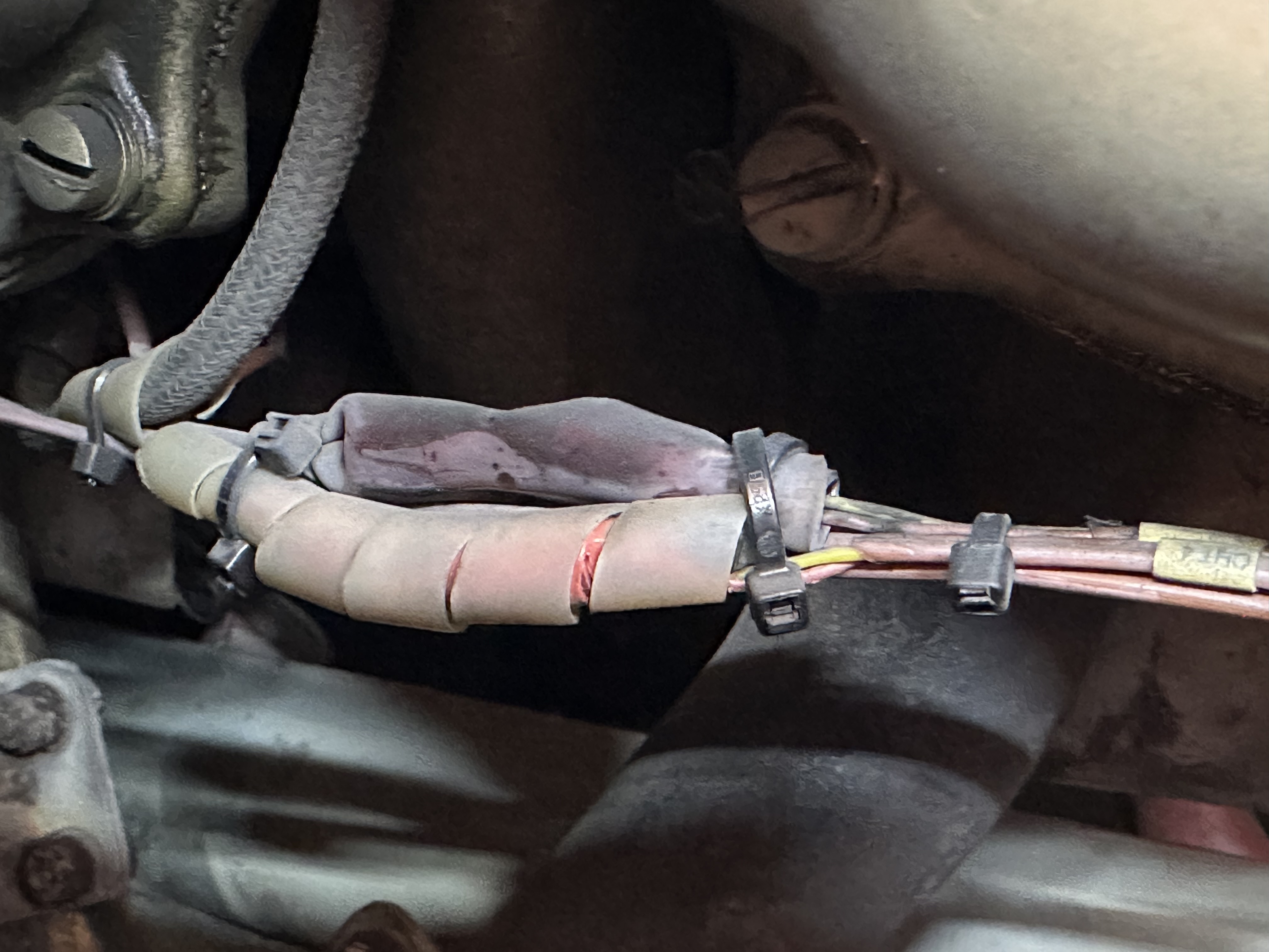

I have had an EI EGR-30P installed in my C180B for several years without connector incident. Presumably they use the same coupling connector. I support the connector and adjacent wire with either clear nylon tubing or silicon tape covered with nylon spiral wrap, along with a few tie wraps for security. Both are illustrated below:
