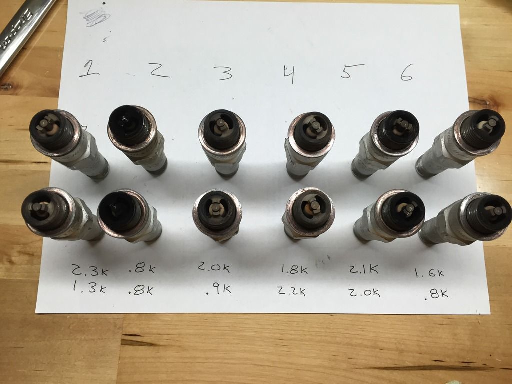

Re: Engine losing power at full throttle...video inside.
So I pulled the plugs, here is a pic of them along with their resistance values right below them. I see the #2 and to a lesser degree #5/#6 are sooted up. The rest appear to look like good burning cylinders. While I have them out I'm going to clean them out and might as well do a leak down on the cylinders before I put them back in....
EDIT: I did a leak down, all cylinders were between. 68-74/80. The engine had cooled off already and there is only maybe ~20 mins of runtime on these rings/hone job so far. The only leaking I could detect was through the rings on cylinder 6, which is the only chrome cylinder I've got on it and that was the cylinder that had 68/80.
I'm at the pint where I don't know if this rpm fluctuation is even a problem..... It seems to have gotten better since the idle mixture screw adjustment. I've got some new cowl seals due to be in on Tuesday, I think I'm going to put the cowl seals on, cowl it up and try flying it, maybe that stumble will go away once some wind is going though the prop?
Are those all Champion massive electrode plugs?
Do they all have the same P/N? Looks like maybe some may not have internal resistors, while others do, which could be messing with your ignition. Otherwise, you have some bad plugs there (cracked internal insulation, maybe, could be shorting out at high power settings).
I am just guessing at the cause, this is internet advice. It sounds like either an ignition or an air/fuel ratio problem.
