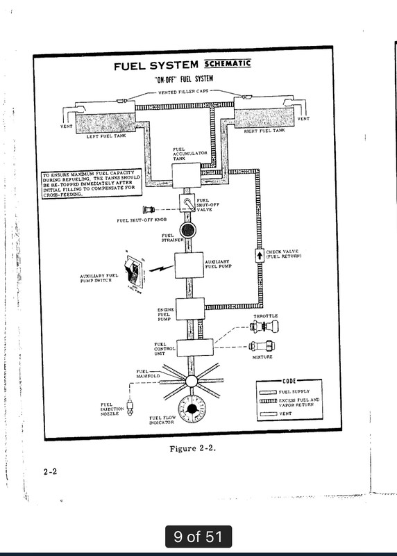

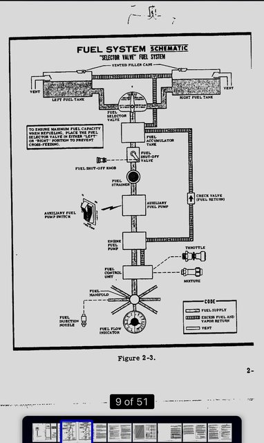

hotrod180 wrote:My early C180 does not cross-feed with the selector in the "off" position.
Oops, forgot that some if not all C185 fuel selectors don't have an OFF position.
Posts: 10610
Re: Fuel vent leaking
Even the on/off has the same cross vent up top
At least per my 185 manual
Posts: 1678
That schematic is pretty useful. Note the check valves on each tank vent? Those valves have a tiny hole in them to allow air expansion in the tanks. If you park in the sun after topping those long range tanks all the way the fuel will begin to seep out those tiny holes. If you leave it long enough, especially on a hill, you can lose quite a bit of fuel.
