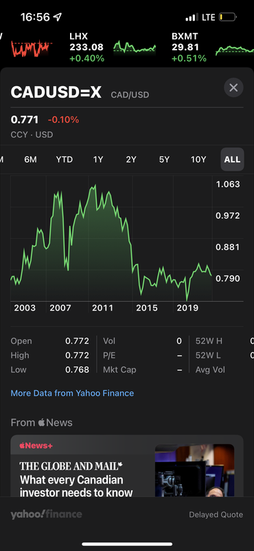

Per the repair I’d enjoy the conversion rate

Does this ever actually work out in Americans' favor? Seems like many parts and supplies originate in the states anyway and it's all a wash. Do Canadian shop rates work out to be less?
I haven’t had anything done aviation wise up there, but I did buy a car, and used to party in MTL, Twas a pretty sweet deal with the conversion and all
I know when the exchange rate is strongly favoring the US, my buddies do a booming business fabricating farm equipment for American customers. A lot of steel comes in from Asia, so in their case it's valuable US dollars paying unchanged Canadian shop rates.
It’s been better, but still not shabby
