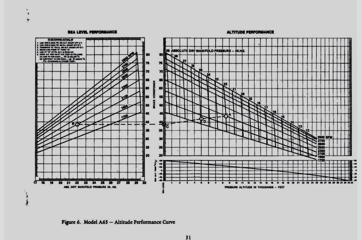

My A65 doesn’t have mixture, only had it up to 6k ish, but I don’t have much of a doubt it could do its advertised 12.5 ceiling if I really want to (and took my time)
Out of the continental manual, there is no separate chart for the different carbs and both are listed on the TCDS

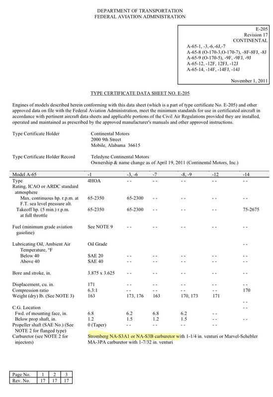

A quick look at my A65/A75 overhaul manual Publication X30008 ©2011 CONTINENTAL MOTORS, INC. AUG 2011) and it only calls out the Stromberg NAS3A1 and that is the one with the mixture control. Out of curiosity I did some additional digging and found in the August 2019 "Coup Capers" an article titled, "Stromberg Carbs by the Numbers" and in it the following was stated:
The NA-S3A1 was designated to be used with a mixture control...NA-S3B does NOT have a mixture control... There are very few model engines that the "B" carburetor is used on ...

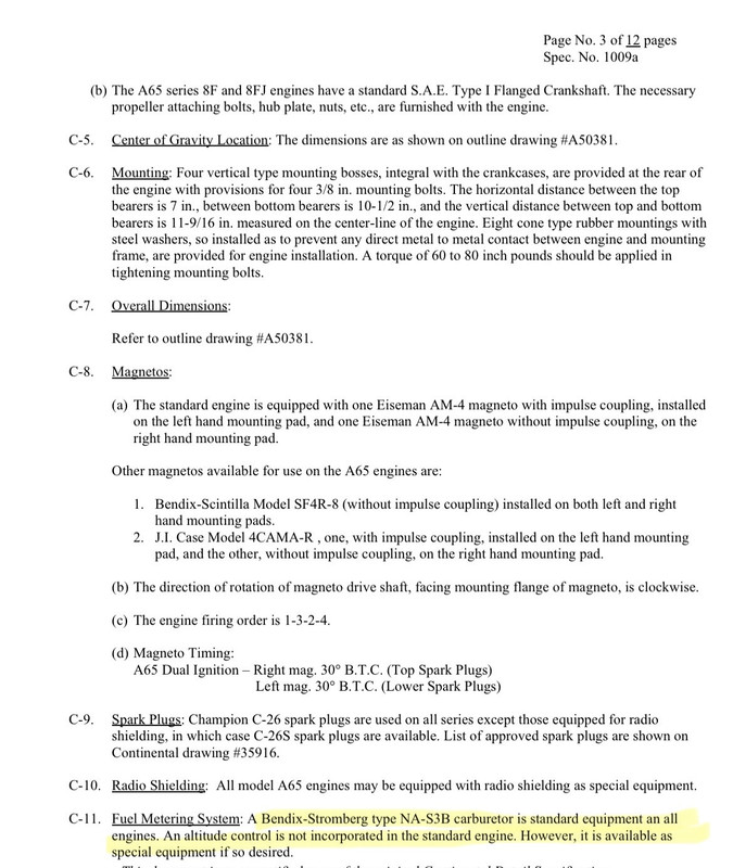

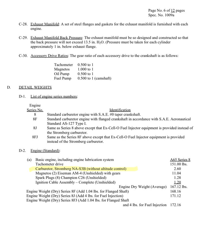

I posted the screen shots of the info I mentioned
Case and point, my champ, stromberg a65, I can tell you 100% it never had mixture because there isn’t even a hole for the cable or knob, as is the case with tons of a65 stromberg 7ACs, as it is with many other planes with that engine and carb combo.
You are correct that it COULD BE ADDED, for whatever it would be worth on that little engine.
Now, the idea that when you see all the stromberg A65s without mixture it’s because some owner took the time and all to deactivate it, that just doesn’t make sense.
If one never wanted to use mixture they’d just simply not pull the knob.
Again many of these planes don’t even have the holes in the panel, firewall, etc for the mixture cable and controls in the first place

Many/most A65 strombergs never had mixture control, frankly in some of these smaller engines it wouldn’t do too much anyways, my guess would be with a proper jetted, good needle seated, proper float measured non mixture A65 the plane is capable of reaching its advertised ceiling with a competent pilot
What type certificate are you using??? This sure isn't A-696, which covers most BC series..... this looks more like an aircraft spec sheet and not anything current, therefore not applicable to this at all.
Few different sources of data, very applicable, gotta read the whole thread
Started off with will a non mixture adjusting stromberg A65 be able to do the OPs flight
Then someone said the strombergs without mixture are due to owners removing the mixture adjustment ability of their planes, which is not really the case in the majority of these aircraft
