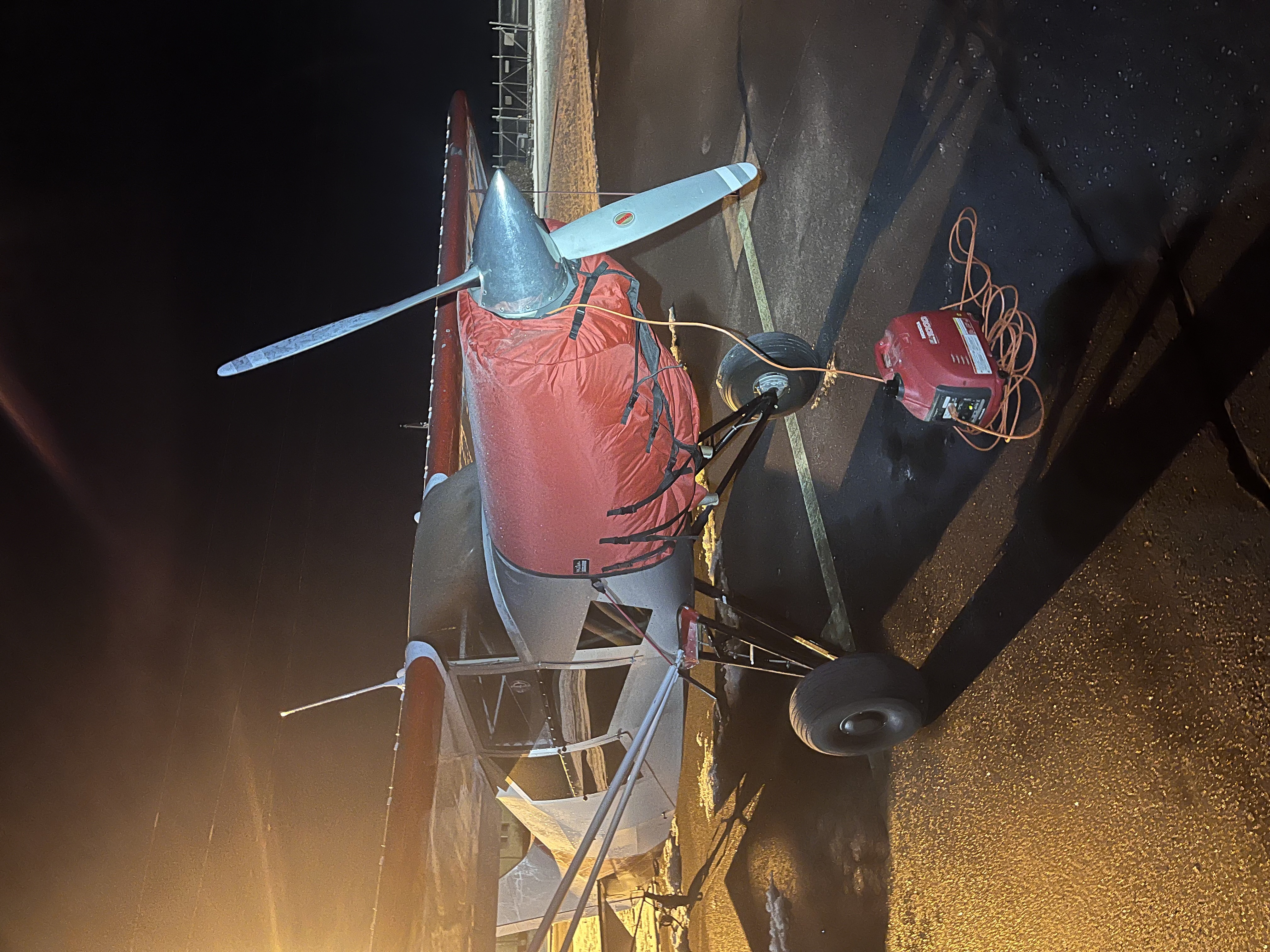

Recently I got my hands on an older Honda EU1000 generator and it’s great. Can leave it running overnight until the gas runs out or just start it in the morning. Super quiet.

As Denny stated, the simplest (and safest) solution for engines with electrical heating systems is the compact portable generator. Get one with the longest run time under rated load because to be effective, it needs to run all night. My 1800-watt generator runs near 7 hours with the draw of a full Tanis system, less if I also run a small ceramic heater for the cabin interior. I run a 50' arctic rated cord out to its full length which is far enough away for me to be comfortable leaving it while running. If you need more assurance, use a 100' cord, just ensure wire size is adequate. Another advantage is no need to carry fuel, its already in the aircraft. I have been running my generators on 100LL for coming up on 3 decades (chainsaws as well).
