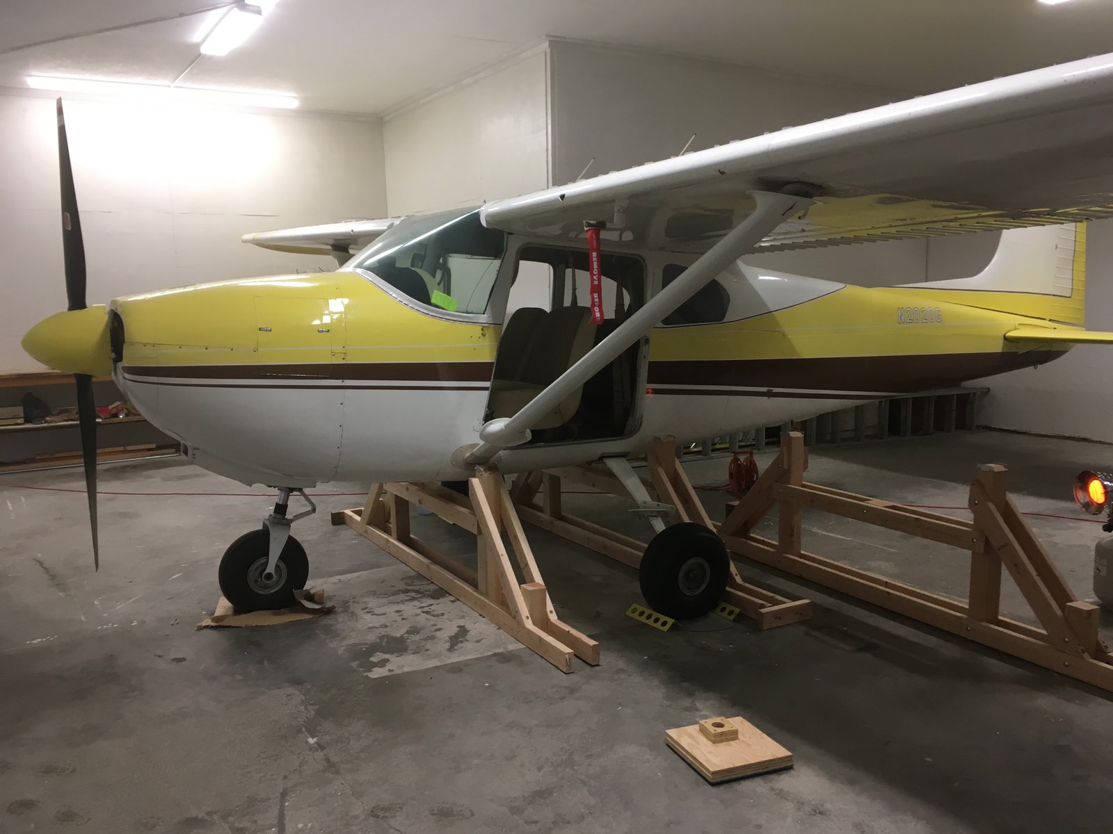

C 182 guy....I’m very interested in what you’re doing. I’ll PM you and can hopefully go more in- depth...maybe even a phone calll and some pics. I’m 1 or 2 days away from jacking up the plane up and removing the main gear for refurbishing. I made 3 cradles with straps and ratchets to set it in for the month the gear will be gone. I hope they work. Attached is the pic...the webbing straps will go around the 4x4’s and form an adjustable cradle between the tops of each pair of 4x4’s. I can adjust the tension with ratchets positioned along the outside of each 4x4.

All went well with the gear removal and refurbish. Jim Hayton at North Sound Aviation did a great job and is a really fine person. He was very reasonable and prompt. The gear came back like brand new. He’s also a wealth of information. I even though I got the gear back to new condition I still had to add two .063 shims on the pilot side. All is level now. Not sure why the shims were still necessary but Cessna allows up to 3 of them. I made the shims out of 2024-T3 sheet. Just copied the inside tip shape, where the bolt goes thru, for about 1 1/2”. No torquing in that tight space, just got it as tight as I could with a little prying with a wooden hammer handle.
Now into my 3rd month of panel refurbishing. Also new rubber motor mount to firewall bushings went in yesterday. Not a simple job! Just make sure your hang point at the top of the case is slightly forward of the center. Mine was too far back and it got a little interesting. We had to add a rachet strap around the crankshaft and over the top of the hoist arm to get the front back up. Too much grunting and groaning.
