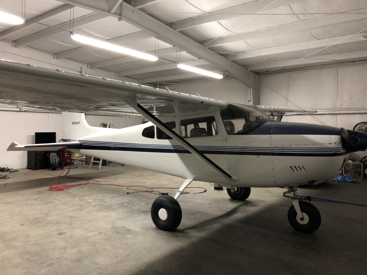

Here is mine on 8.50 mains and 8.00 nosewheel.
