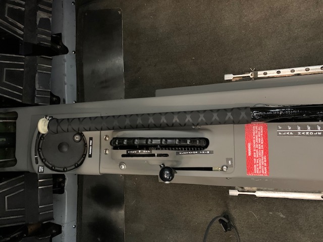

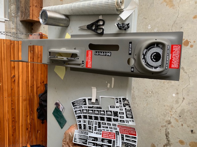

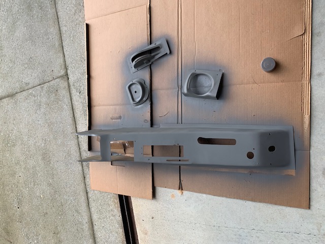

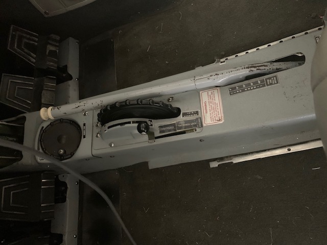

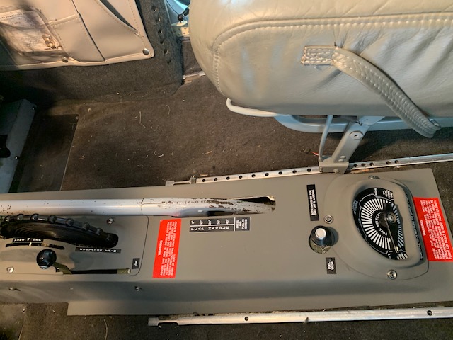

I'll start it. The ugly beat up tunnel really let the interior down and it is a focal point.
Materials- Automotive plastic paint $18, Placard kit from Wag Aero, $59, Heat Shrink from Buyheatshrink.com $18.50, spray enamel paint $8.50
Tools- masking tape, small paint brush, heat gun
Time-3 hours
I removed the tunnel and associated parts as usual for annual, rubbed down with scotch brite, cleaned with dish soap and brush, 2 coats of automotive plastic paint, applied appropriate placards.

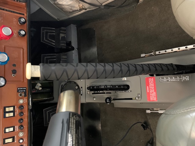

Scotch brite flap handle, cleaned with acetone, applied enamel paint with a brush. Even with good prep the wear from bare hand started marring the paint. Slipped over a piece of 35mm heat shrink with built in grip and warmed gently with a heat gun on full power. Be careful to heat slowly and evenly.

I like the heat shrink on the flap handle. My handle gets beat up from being slid through the slot when the cover is taken off for annuals. I'm also considering a vinyl "boot" for the base of the flap handle, sort of like what is used for car parking brake handles. Think I've seen a picture of one on this site.

On my 170, I just masked off the floor and seats and used a rattle can to paint the flap handle. Four years later when I sold the plane, it still looked like new.
I am always skeptical of ANY type of "wrap" on something made of steel. I don't think you want to buy one of those handles down the road.
Or, it might be fine.
Re: Inexpensive Interior Project Thread
mtv wrote:On my 170, I just masked off the floor and seats and used a rattle can to paint the flap handle. Four years later when I sold the plane, it still looked like new.
You're right, I think. I have mine wrapped with tennis racquet tape. With that setup or this one, it's easy enough to unwrap it at annual, take a look, and wrap it again. I was thinking of a paracord wrap this year, but the fact that you can put the heat shrink over the collar makes me consider it.
Otherwise, how do you secure the collar in a non-permanent way?
