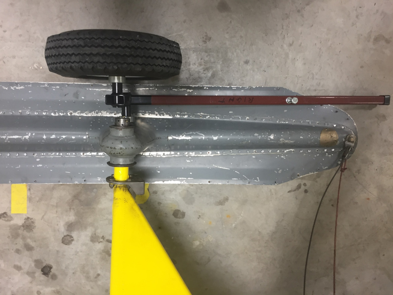

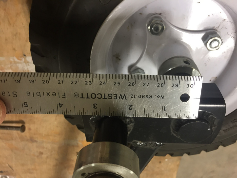

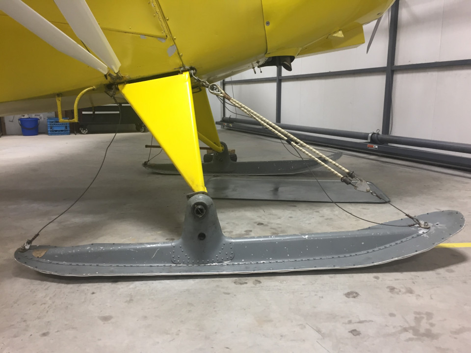

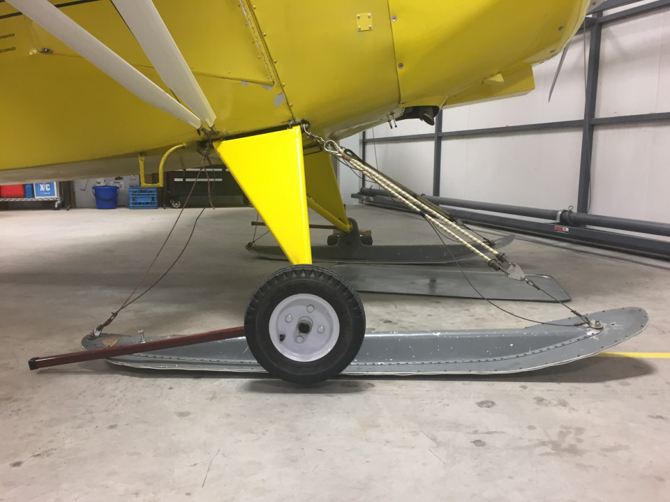

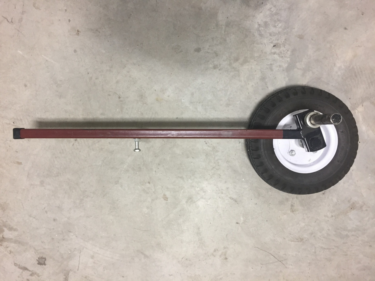

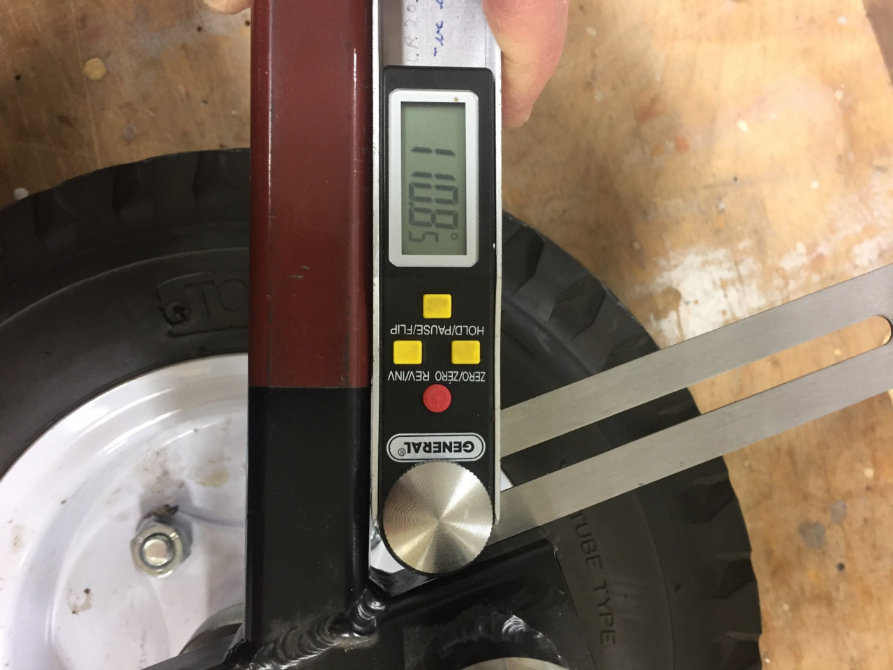

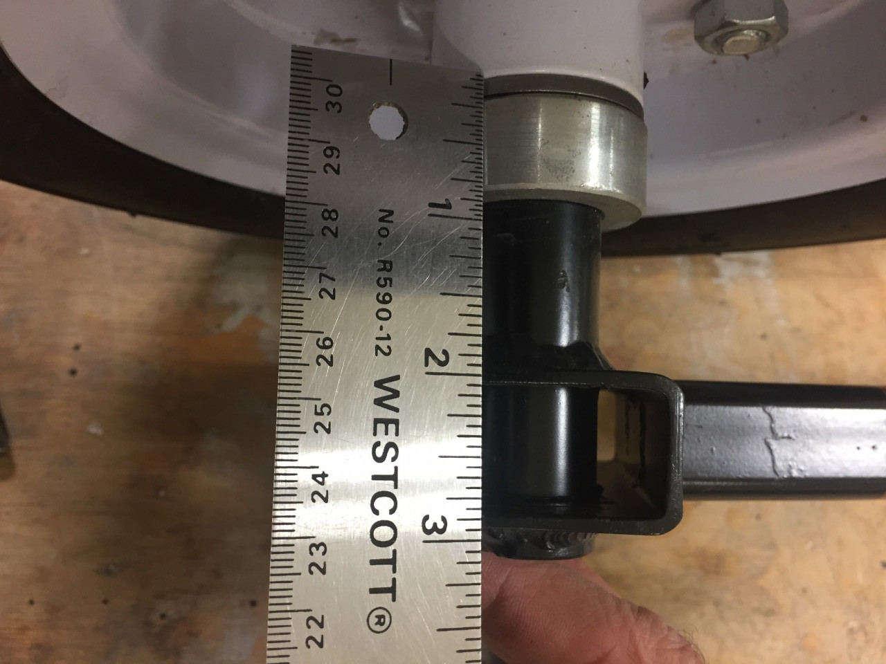

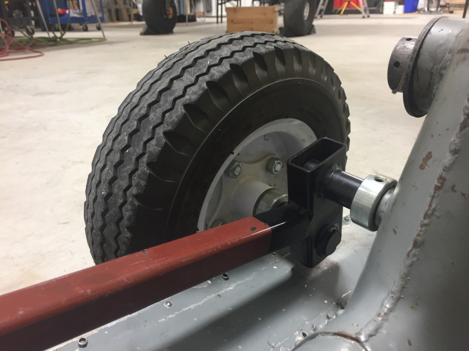

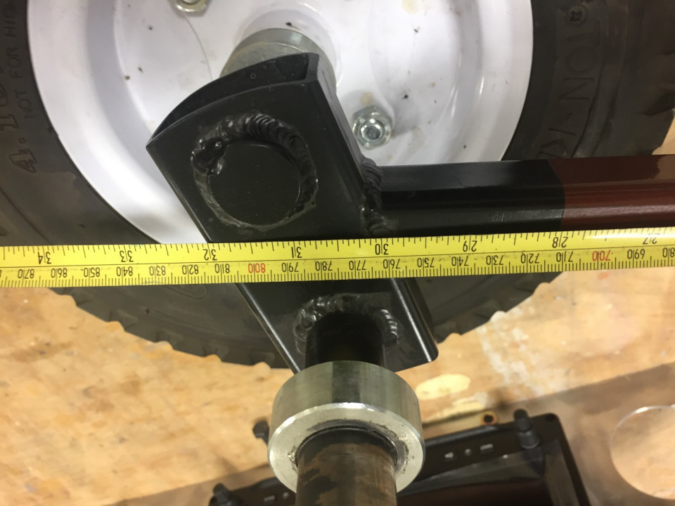

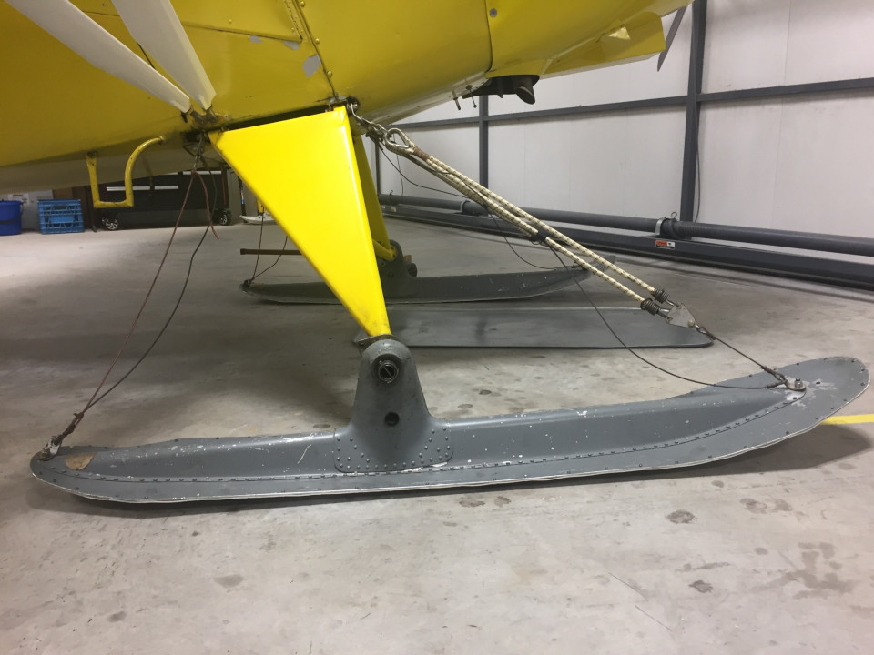

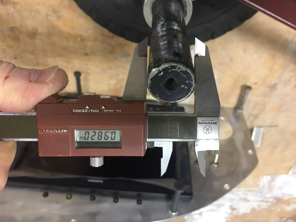

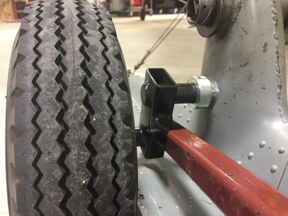

The following pictures are of a set of dollies that I made for my Federal 2000A skis on my PA-16 Clipper. There is nothing special about the materials I used, it was just what I had on hand at the time. I didn't make any drawings as I went, otherwise I would gladly share them.
Before I use the dollies, I hook a string from the back of the ski to the cable mount. This keeps the heel of the ski off the ground when it is lifted by the dolly.
Notice that the rubber bumper that I put on the handle does absolutely nothing. It seemed like a good idea at the time but it turns out that the handle rests on the ski long before the bumper hits.

Welcome aboard....and Thank you sir!!! Those are great pictures and measurements. I was in the hangar today and another guy had sent a picture of a similar design. but without measurements.
I can easily build a set like yours. I just happen to have a piece of steel rod, but ironically it is 1" and the hole in my skis measured the same as yours, (0.98x) Guess I'll need to put it in a lathe and turn it down a few thousandths.
Thanks again,
Keith
