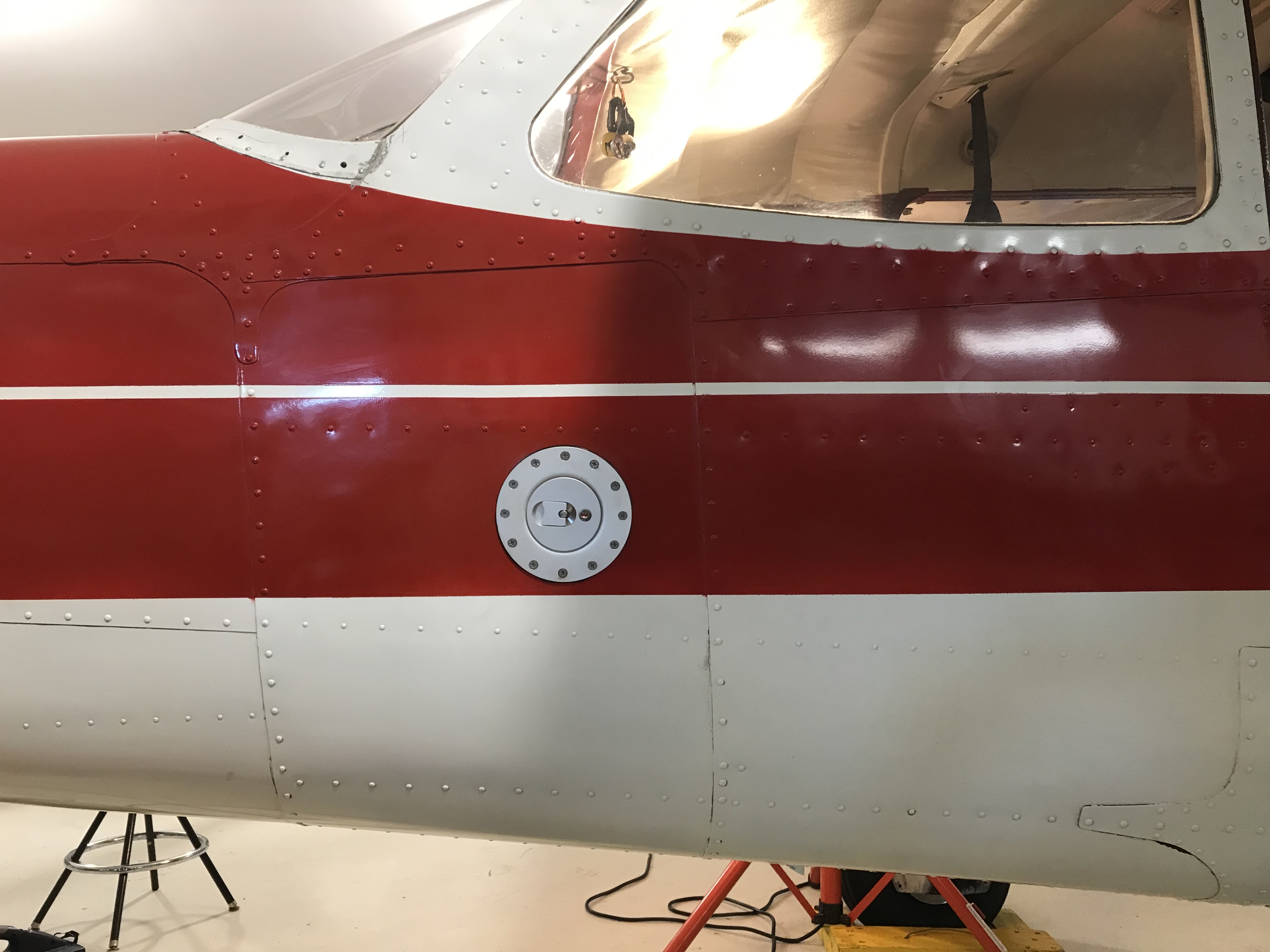

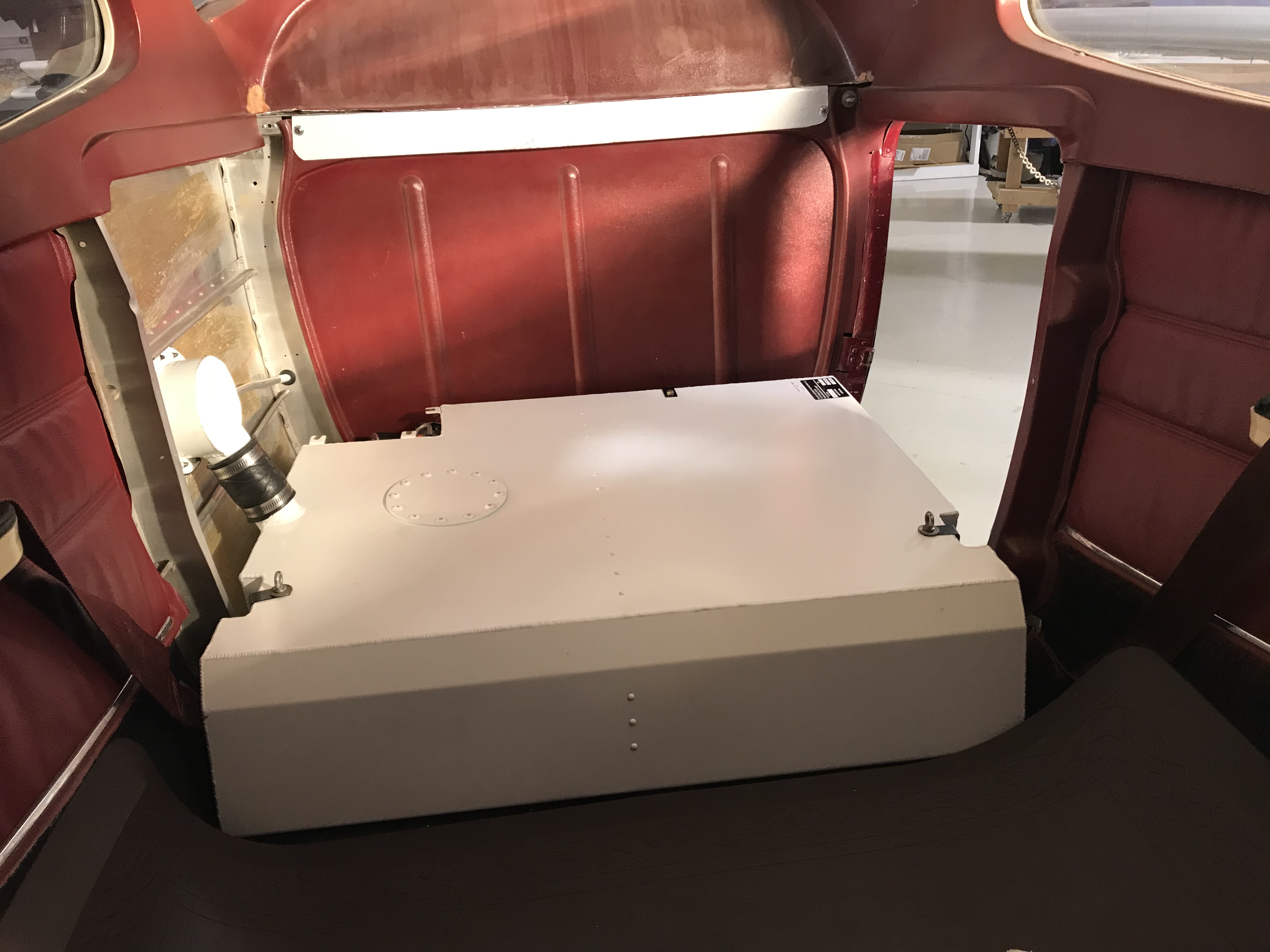

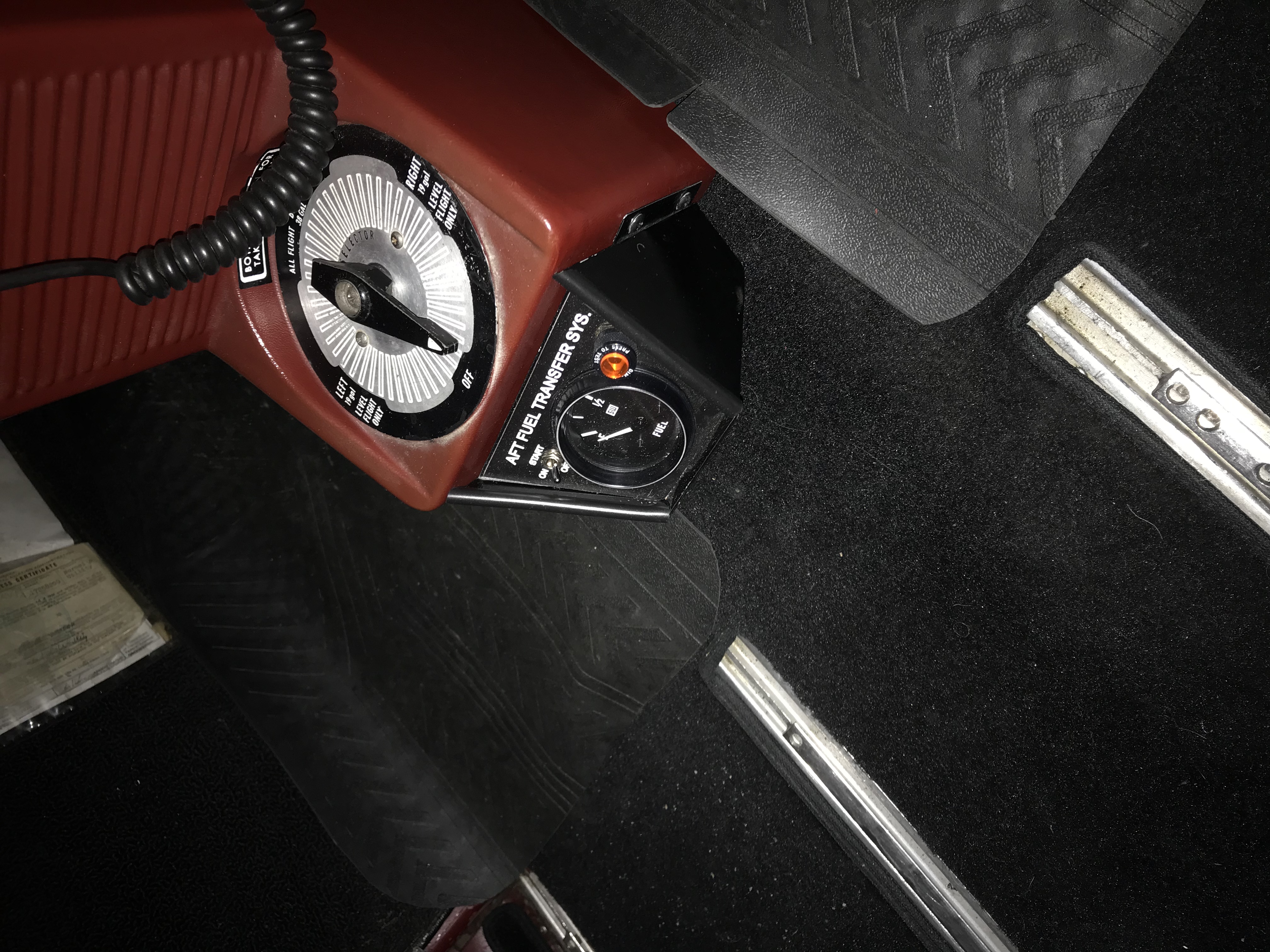

Griggs Aircraft (O&N) baggage aux fuel install
One of my upgrades last winter was the installation of the Griggs Aircraft aux Fuel tank. Originally I wanted to install Flint internals but he had no stock and no timeframe for availability, (Covid mania). I regularly make trips from s.e. Ak. west along the coast and north thru Canada. Up to Tok we don’t stop in Canada so the peace of mind with having plenty of fuel is really nice.The folks at Griggs were great to deal with and the kit quality is top notch. Yes it takes up space but I operate the airplane as a two place so w&b wise no problems and it sure beats jugs in the back. About 25 hrs install so much faster than flints and could be removed in about 1.5 with a reinstall of 2.5 not counting paperwork. Of course one upgrade begets another so comfy new seats are required for the increased range, and since long hours can be tedious an autopilot comes into play. First world problems, at least for my lifetime. :wink:

That Griggs system looks real clean. Those back tanks are fine on wheels and required if you have the 180HP conversion. On floats thats the last place you want more fuel. We put the Flints on a 172 with the 180 conversion on floats and while it worked well and kept the weight ahead it was yikes a bit (lot) scary when turning in rough water with the typical Edo 2000 floats. Had a serious pendulum effect when the tanks were full.
