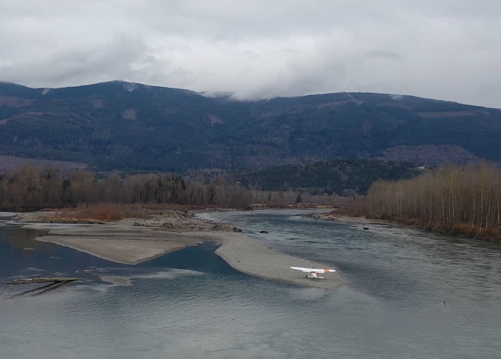

You can fly your 182 off airport, just have your tailwheel friend's land first and check the conditions for you the first time :)
You need to protect the nose gear so be more careful, but can be done for sure.
83683819_3040211589365261_239141374444594099_o (3).jpg (141.12 KiB) Viewed 2231 times
