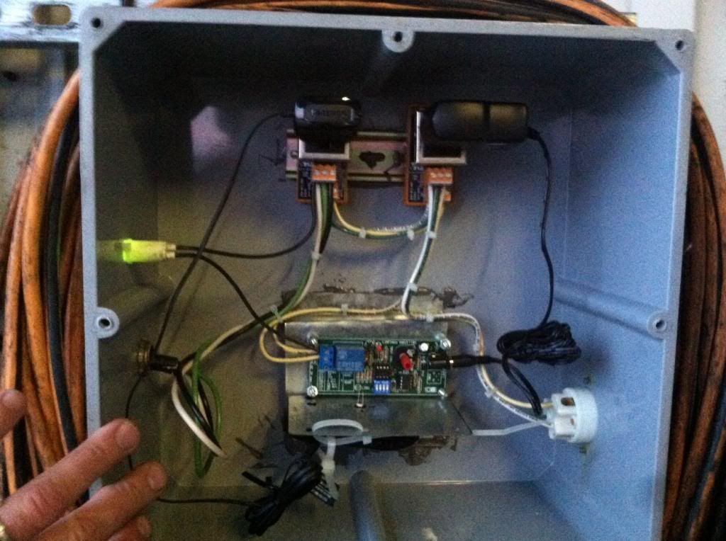

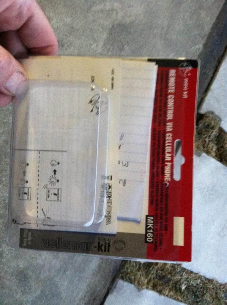

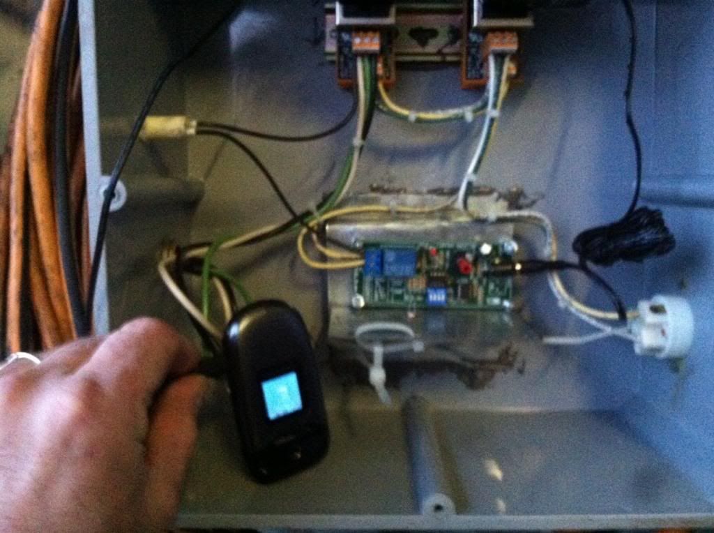

Here are a few pictures of the light activated cell phone switch I use, it works well for me although the SIM card method may be more user friendly. The switch is a kit and requires soldering together, i built the rest using sheet metal, JB Weld, some din rail mount receptacles and an indicator light.

Kodiakmack, A thermostat at home is equivalent to a remote switch to turn on heat source. Furnace has oil or gas connected directly to it. Cell phone in this case is just a remote switch to also turn on heat source, in my case an approved aircraft engine preheating system from Reiff intended for the purpose. The 120v power run to the system is on its own breaker for short circuit protection and supplied through a ground fault receptacle, my fuel is in the wings and my fuel selector is off. I can't say that Ive ever heard of a pre heating hangar fire or explosion although I'm sure they have happened, just as I'm sure there have been fires caused by faulty/incorrectly installed furnaces. Just Sayin
