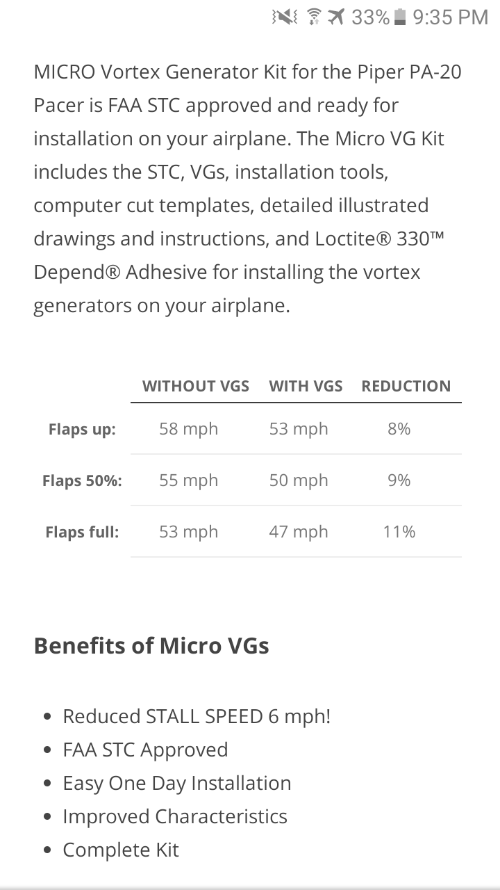

Thanks, that makes sense to me and I appreciate the replies and your time. I think what confused me the most is how they are marketed to people. They tout the lowered stall speeds first and foremost on their website, and roll the rest of what i would consider the real benefits to my airplane into one bullet point, "improved characteristics." Maybe you should write a few paragraphs and send it to them haha.
