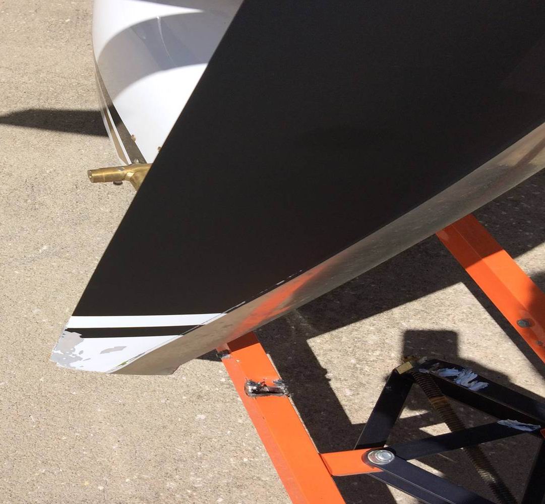

There is little damage that you can do to an MT that would cause any concern for safety or function. The factory approved an owner to fly his SR22 home 150 miles from where he started the engine with the tow bar attached and did this to his brand new MT prop (see pic below). Blade repair was easy. Same thing happened on a Hartzell Composite a few months later (different plane) and the prop had to be condemned on the spot with no possibility of further use or repair. The .pdf file next shows two extreme examples of damage to an MT that still allowed the pilot to safely land the plane following a gear up approach.
I can tell you from your pics, if this was a metal prop, it would be condemned for sure. If you attempted to fly it on a pounding Lyc 4-cyl engine after a dent like that, you would risk the tip breaking off in flight leading to very serious vibration. This does not happen with the wood core MT props.
Review the details of the MT Service Letter (SLE-32) for Owners to inspect and perform their own repairs to an MT prop blade. You will learn how to do a coin tap test to determine the amount of area under the leading edge that may have lost the bond. If the results are inside of that spec, simply get out your sander, epoxy and clamps and fix it. Then when time permits, have Dominion replace the leading edge only...no need for any other work or expense. That can be done w/o the need to even re-paint, but I would ask for re-paint of all the blades so they all look nice and match.
If you need help or a copy of this document, please call me.

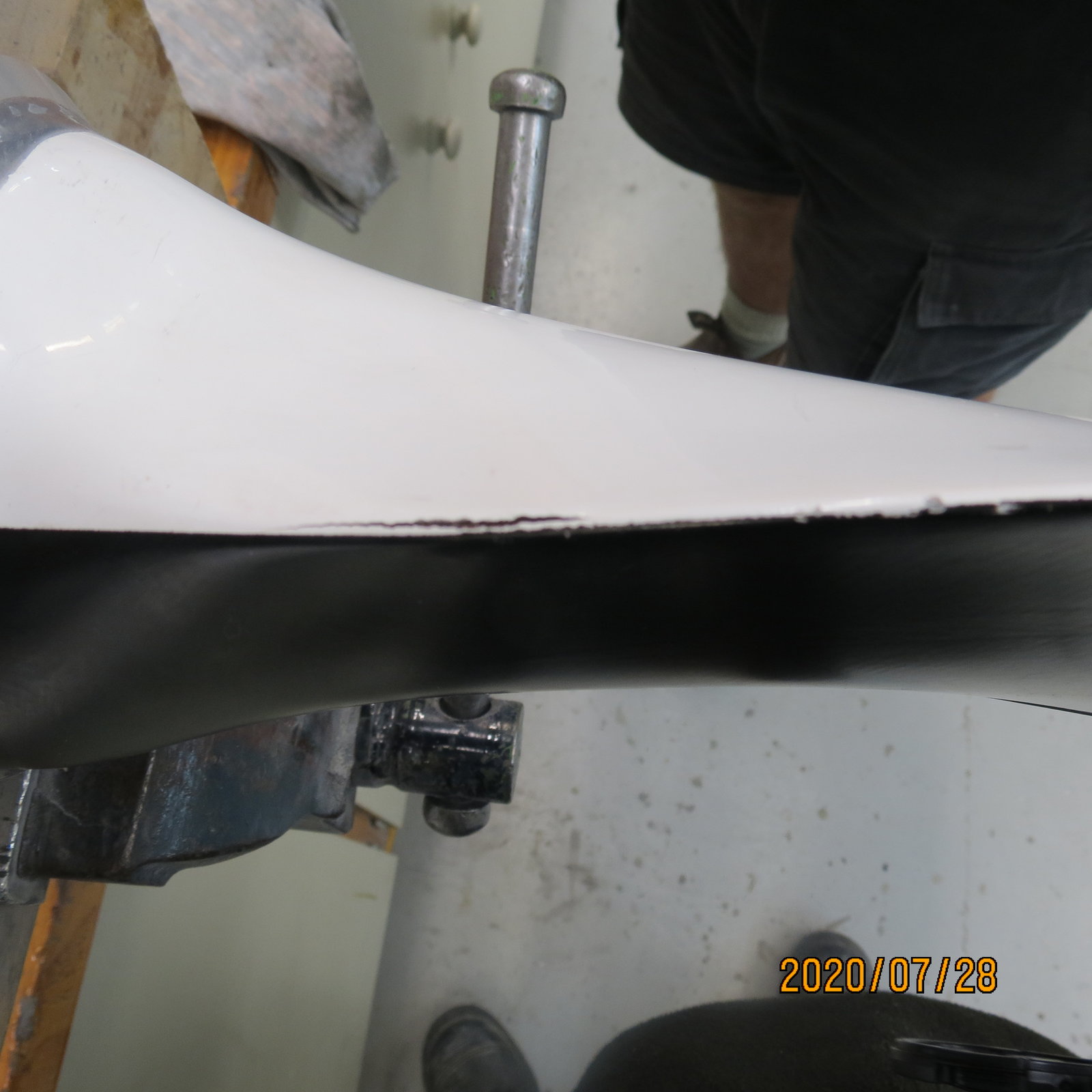

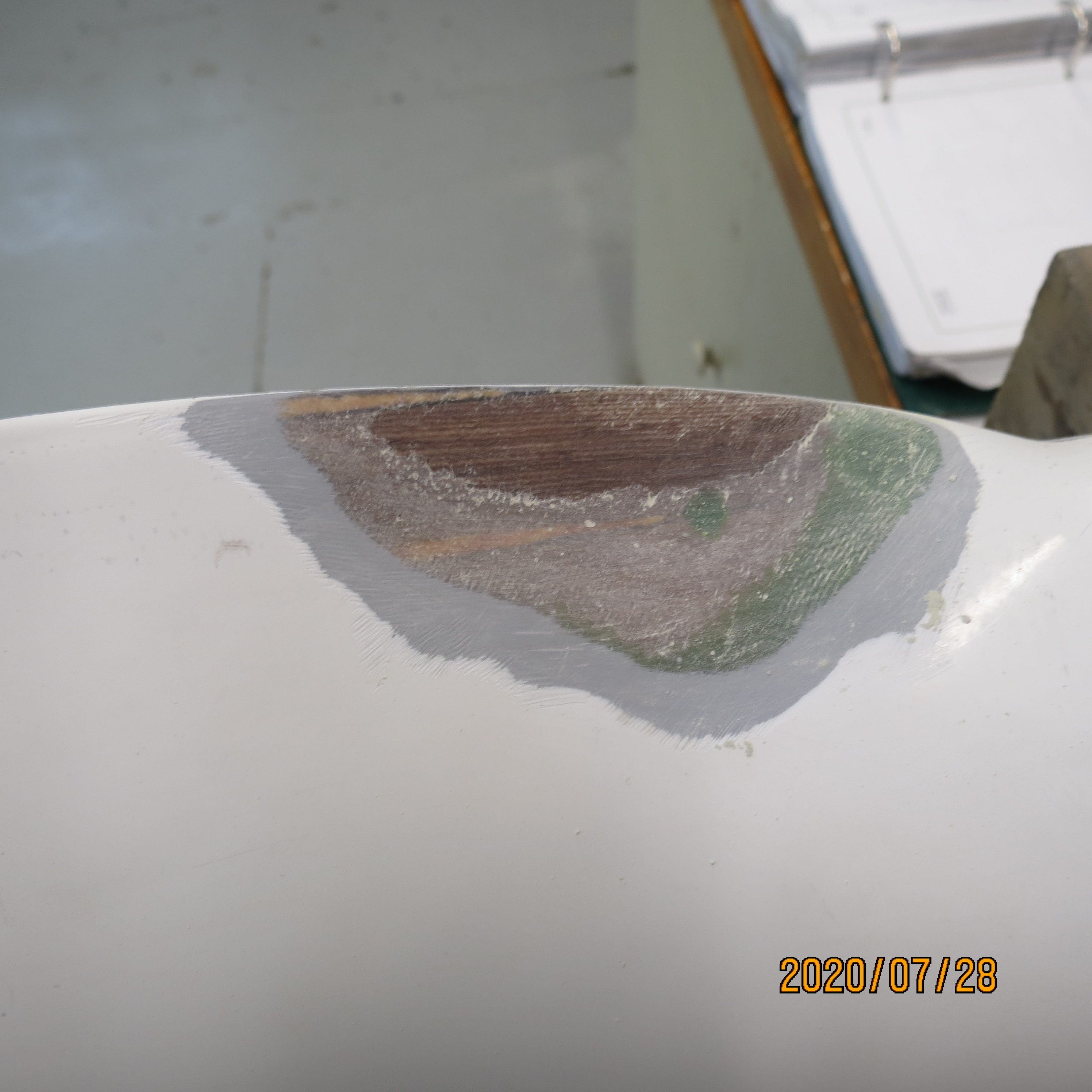

We love our MT but at 1100 hours we have had leaking blade seals and a small crack in the fibreglass on the in board trailing edge of one blade that was taking in moisture. No biggie and easy enough to repair, but just saying.
