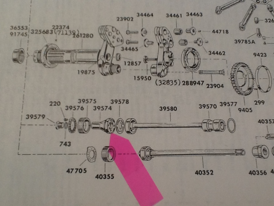

Here is a parts catalog. Might be easier pointing at the part your talking about. I’m not familiar with the nozzle you are referring to. I know a hydromatic prop is completely different.
http://www.dustersandsprayers.com/PDF%2 ... ellers.pdf
AKJurnee offline
Posts: 184
Location: USA
Re: Mysterious 2D30 Beaver Propeller Issue
It's actually an engine part and found in the 985 parts book. If I recall in my parts book it's one of those hand drawn additions in a later printing even the p/n is hand drawn.
Rocket
rocket offline
Posts: 156
Location: Talkeetna
Ha, i miss remembered the drawing, means I was wrong, darn free internet advice ;)
Not sure why the overhaul doesn't come with this part? Old timer who trained me said to take it off the old one cause, then reinstall on the O/H

Are you talking about the Little Giant seal inside the cylinder?
If the seal at item 39 is damaged, and I've seen more then a few, you have oil all over your windshield, lot of these got missinstalled at lake hood, then they flew out west and straight to the Naknek River at PAKN or the 5NK pond where I had to deal with it: billable hours! Hard to believe but I've shouldered a few of these off and on by myself back in the day and I'm not a big guy, more guts then brains I supose, got smarter and made sure the pilot didn't sneek off to get lunch or the bar til I was done. If some meathead didn't over torque the prop nut I usually had the whole thing off and on in an hour, a touch more if she had the spinner and the required safty wire. Later came to love the big Hartzell...
Rocket
rocket offline
Posts: 156
Location: Talkeetna
Rocket,
Yes that seal, but I forgot about the tell tale oil leak over the windshield thing! Long day.
Great story! I bet you backed a pickup truck up to the prop, used the bed rails and a 5 gallon bucket for the oil that spills out? brings back memories of crop dusting for me.
Back to square one I suppose. I hope he finds the issue and I'm curious of what it is.
