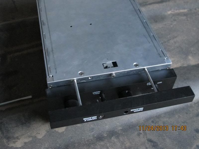

Here are the pics of one of my Mark 12Ds. I didn't feel like pulling the one out of the panel, since it's such a bear to get back in, and it's the one with the yellow tag on it with the name of the avionics shop in Alamosa. I think it's Depot Avionics, but I'll call my local avionics guy tomorrow and ask him.
The Phillips screw labeled "handle release" only releases a pull handle--makes it easier to get the radio out of the panel since it fits so tightly. The hole labeled "radio release" has a hex head screw behind it.
With the radio upside down and the handle pulled open, you can see the hex head screw. Directly behind that is a rectangular hole, and in it you can see the latch. As the hex head screw is turned clockwise, it draws the latch forward, and when it clears the back edge of the hole, it turns 90 degrees and inserts into a slot in the can to hold it the radio in place. A little more tightening, and the radio is snug.
To remove the radio, you turn the hex head screw counter-clockwise until the radio is slightly loose, i.e., can be pulled out maybe a sixteenth inch. Then you push it back in and turn the hex head screw counter-clockwise one more quarter turn, then pull out the radio. At least, that's the theory. More than once, I've thought I had a radio in there tight, then pulled on the handle and the radio started to slide out. Other times, I've thought I had it loose, and it was still solidly latched in. It's not the greatest latching system, but when it works, it holds the radio in securely.

Thanks for the pics Cary. There is no hex screw behind that hole on mine. It is just a solid plate of sheet metal. It must have latches on the sides towards the back. I'll play with it and see what I find.
