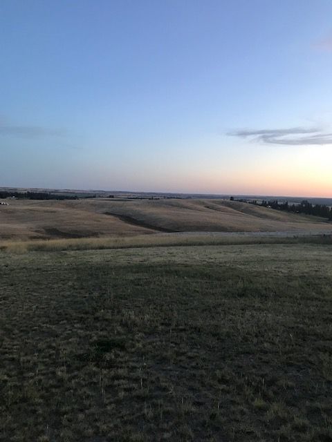

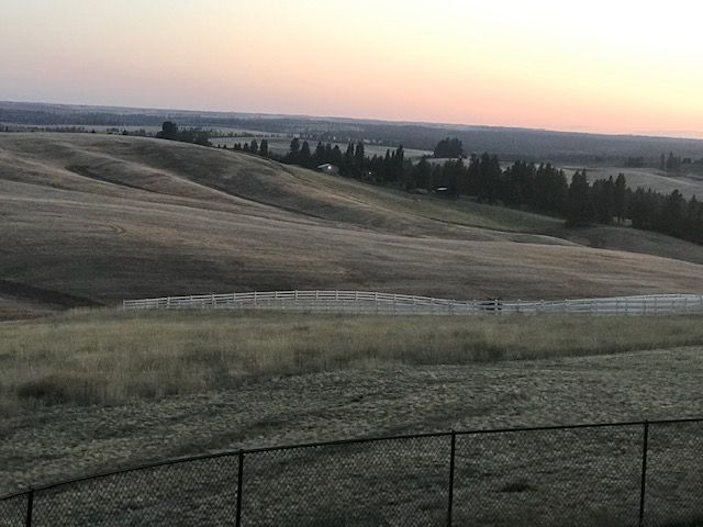

Ok so you guys are throwing some awesome ideas at me. Seriously appreciated. yes it get very hot here in the summer. 90 is common. I do not know my actual altitude and that complicates things a bit.
Will Yes I would be interested in chatting? Can you PM me? I took some pics of the area with my iphone to give you some background information. Next post will be the pics.
Again thanks

I'm not 100% certain I have the runway positioned correctly in my brain (fence line?) but nothing I'm seeing there is giving me much pause. Competent instruction in any of these airplanes should sort you nicely. Looks like you could pop up into ground effect for miles there. You live in some beautiful country, my friend. Excited to see your home-strip journey develop.

Thanks a ton Jourdan. If I was a bit smarter I could have easily looked closer and posted the pics. The fence line is the neighbors fence. But along that line running down hill seems to offer my best option for a departure downhill and a landing site uphill. I have more photos if needed for you guys to assess the landing strip.

I should note that the grass near the barn has been cut as a firebreak of sorts due to fire risks. I have not not spent the 3 hours yet cutting the grass where the airstrip would be. It makes the photos slightly confusing. Thanks
