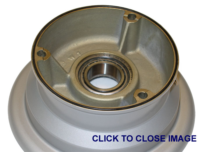

Im curious to know how "tubeless" with a split wheel works. I have heard of kits to seal the wheels but never seen how it works.
This would eliminate the fear of valve stem shearing. No?

Crzyivan13 wrote:Im curious to know how "tubeless" with a split wheel works. I have heard of kits to seal the wheels but never seen how it works.
They have an o-ring seal at the mating surface.
Tubeless does eliminate the stem shearing issue but it presents a new one. Instead of shearing the stem when the bead slips the air just blows out because the bead is no longer sealing. It is one of the reasons off road guys use bead lockers.
