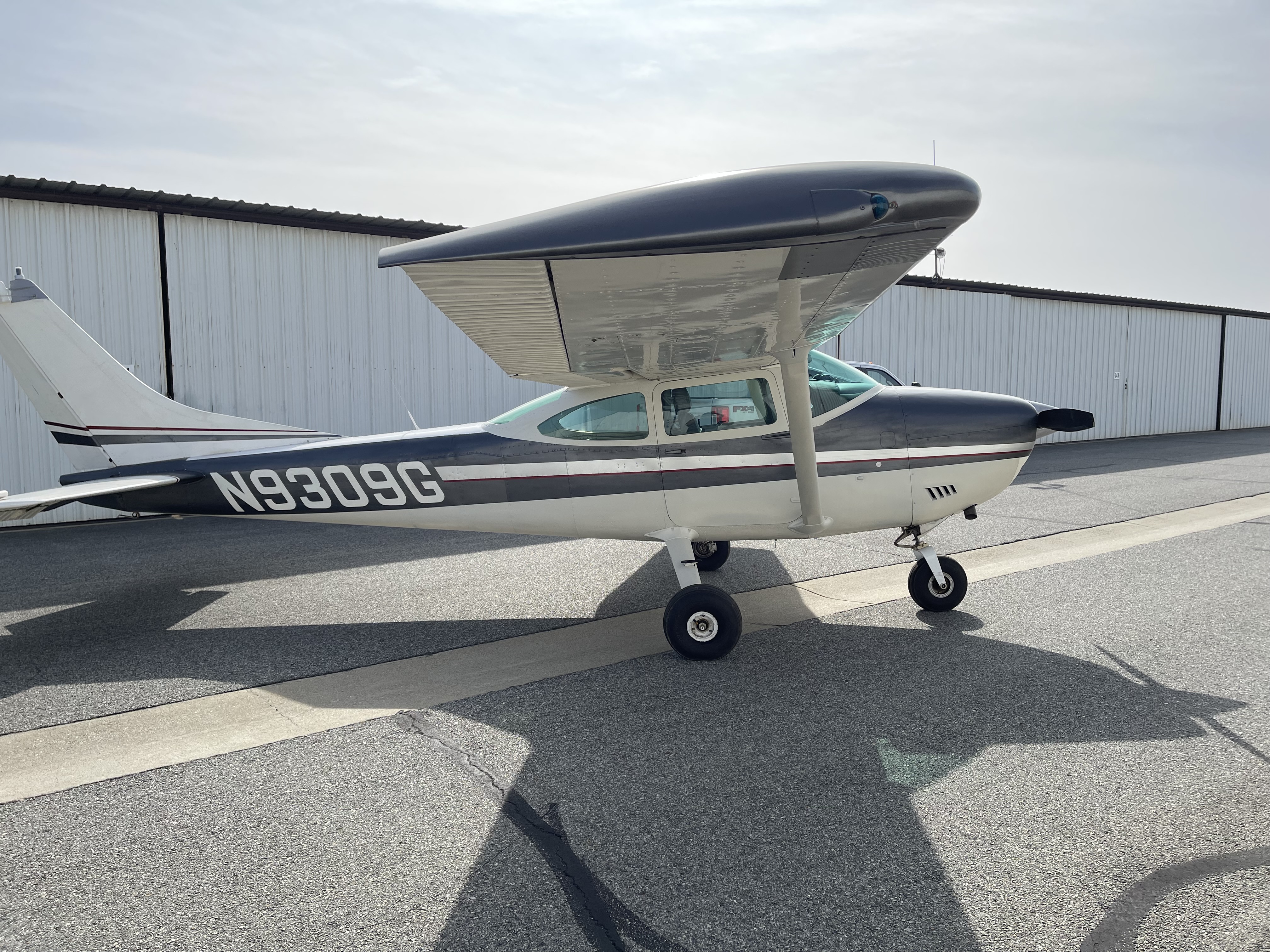

That is exactly how my 182 wheel set up was. If I didn’t roll out ALL of the elevator trim on short final just before touchdown I struggled with heavy nose.
Mine was a P model. The wing may have helped for slower landings, more nose up.
Do you have an aftermarket wing cuff?
Here is a pic of stance for comparison.
