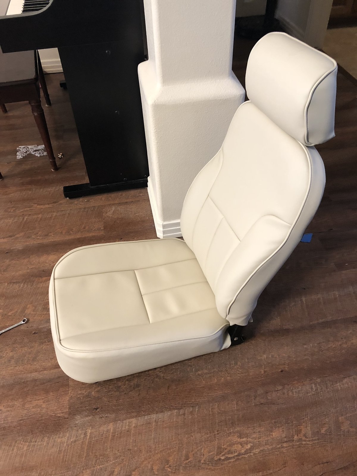

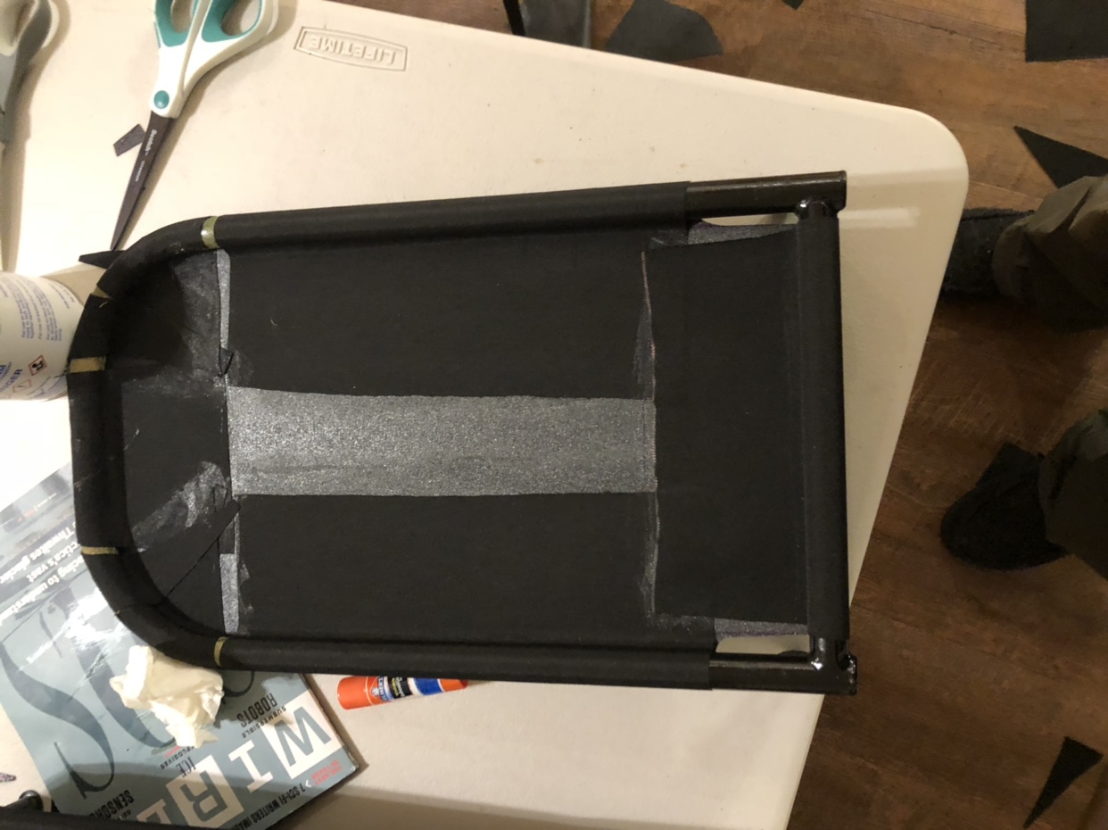

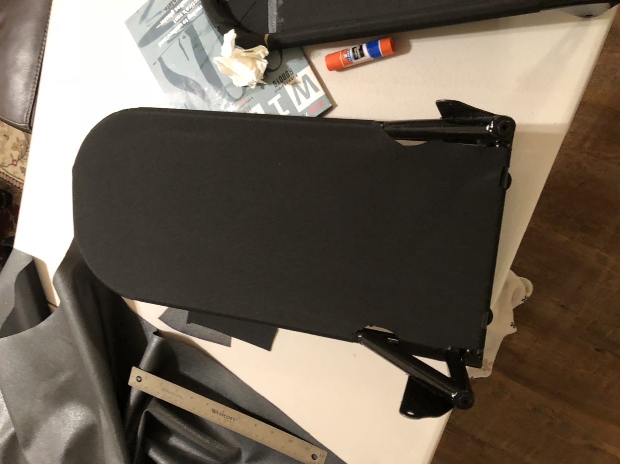

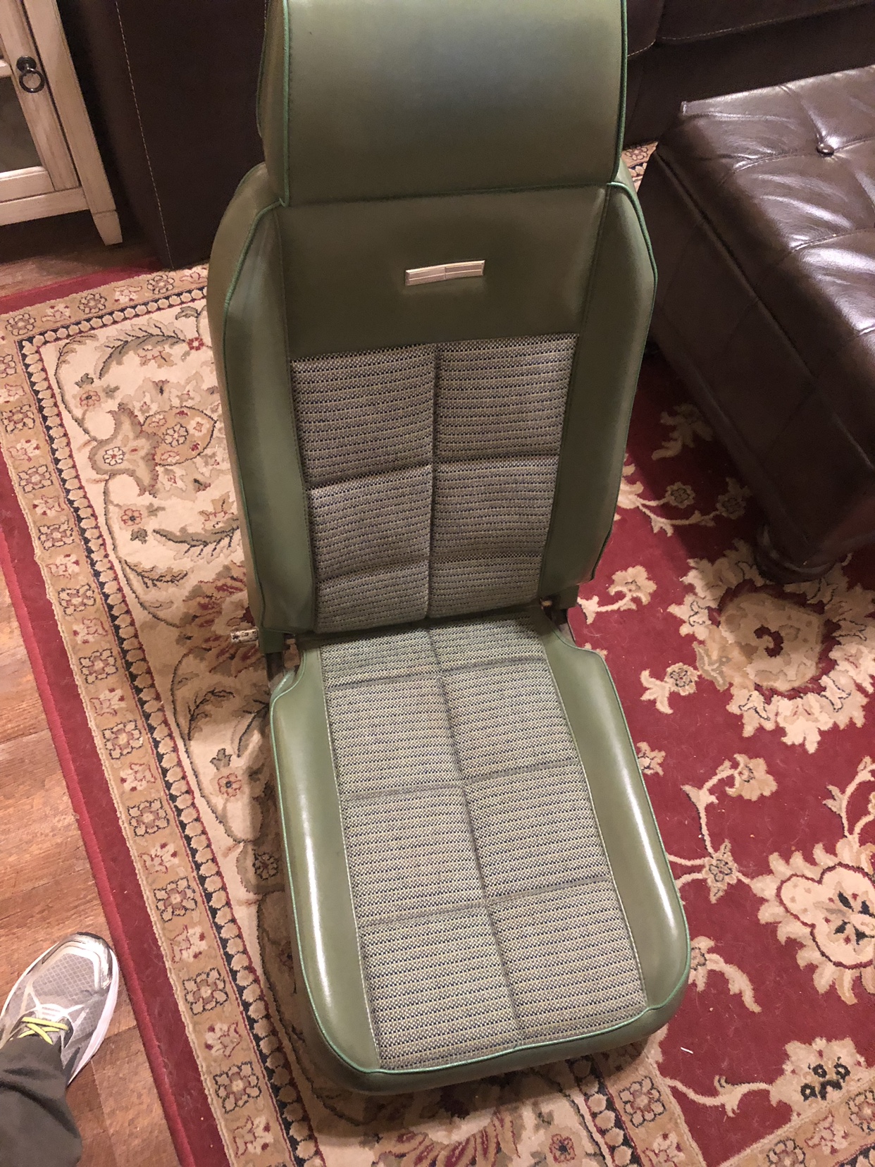

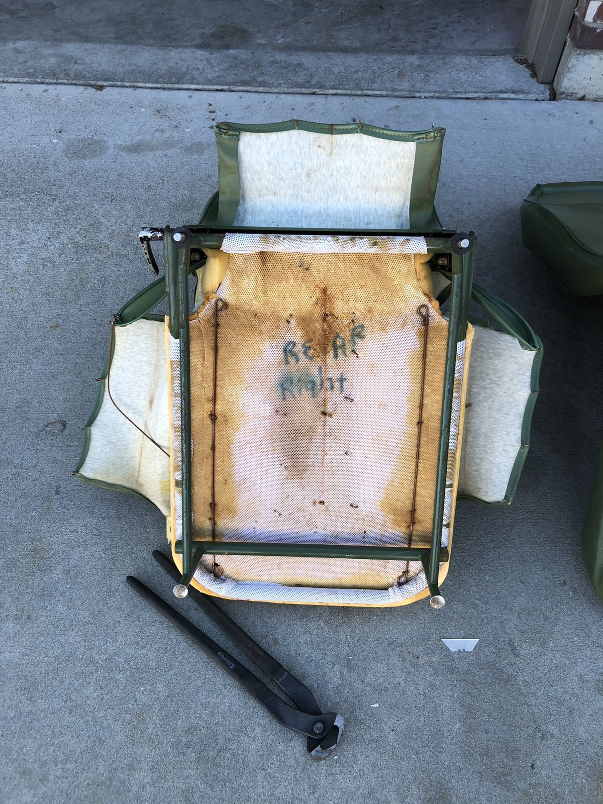

I am just finishing reupholstering all 7 of my seats with airtex and used their seat sling material. It is really heavy duty stuff and their adhesive is really strong (both in smell and adhesive qualities). I wore a respirator when working with it. Really happy with the airtex stuff so far.
Before
After
scottf offline
