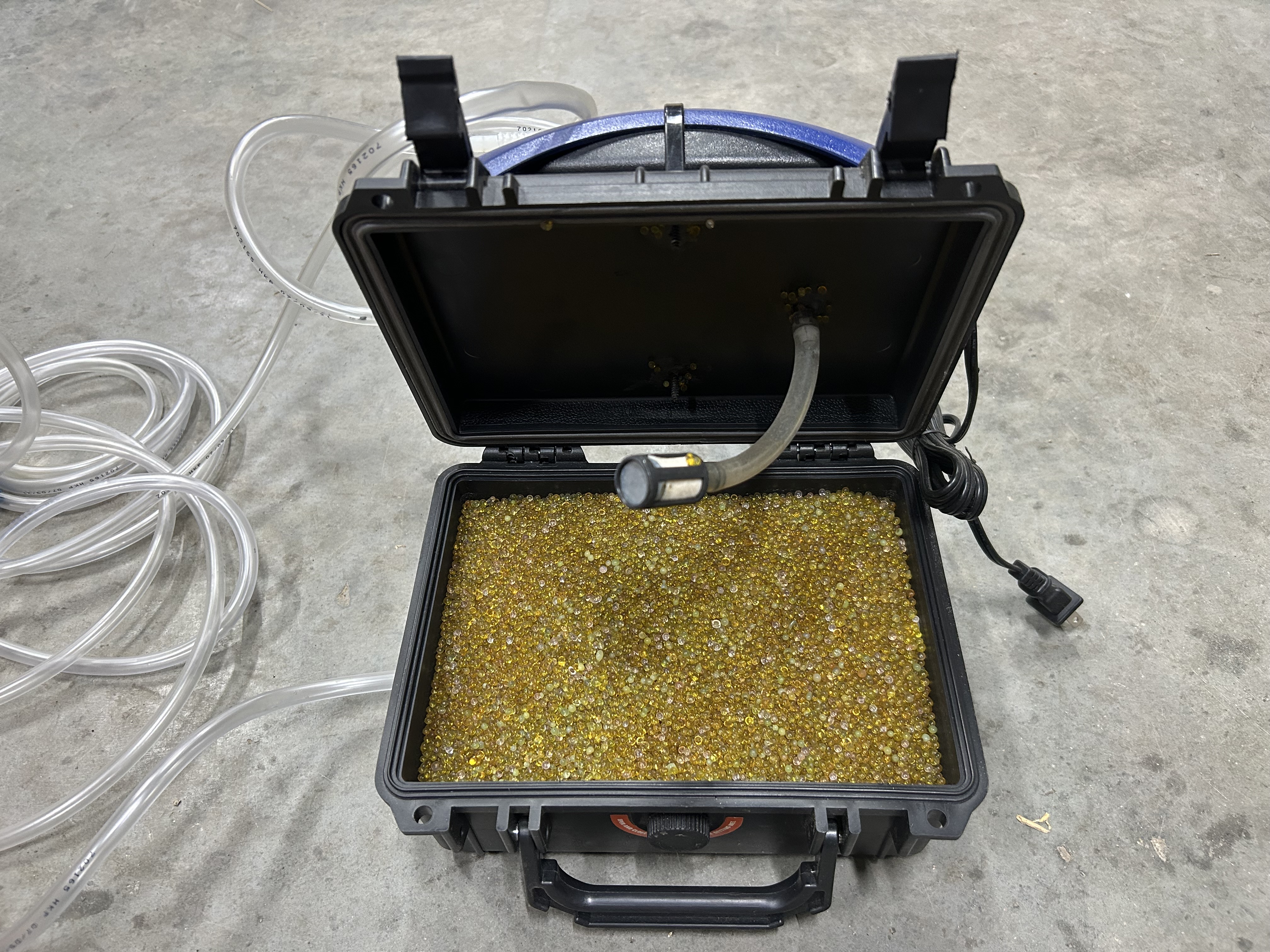

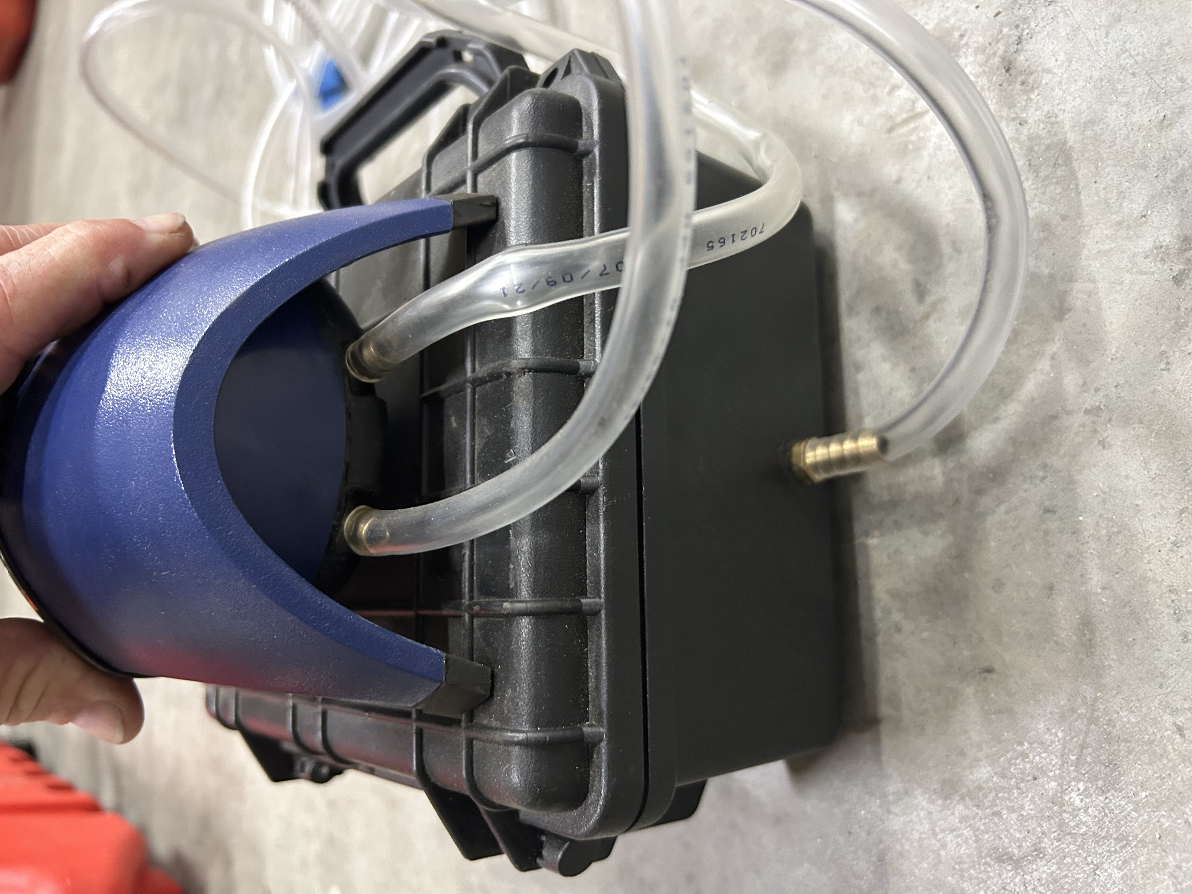

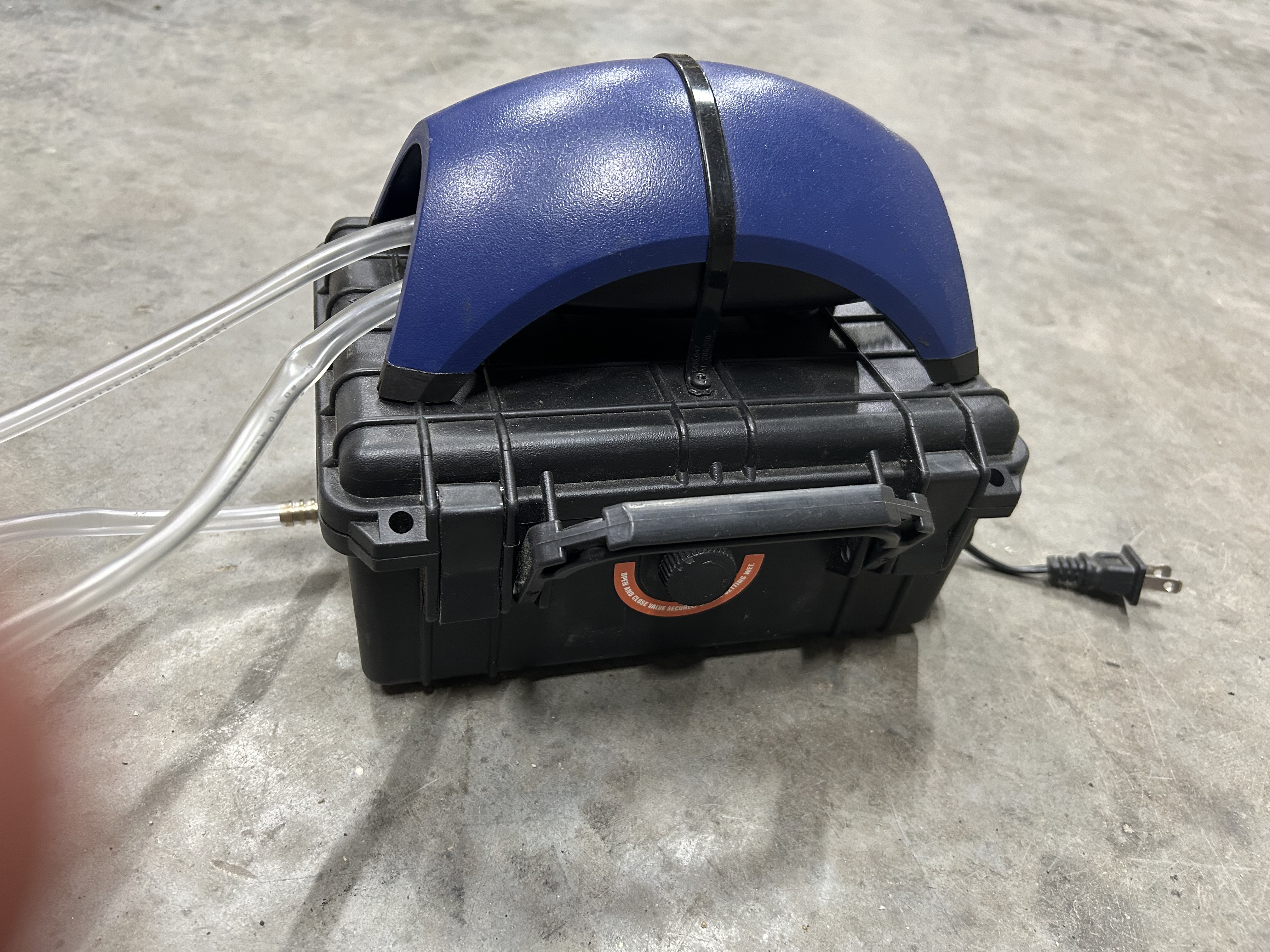

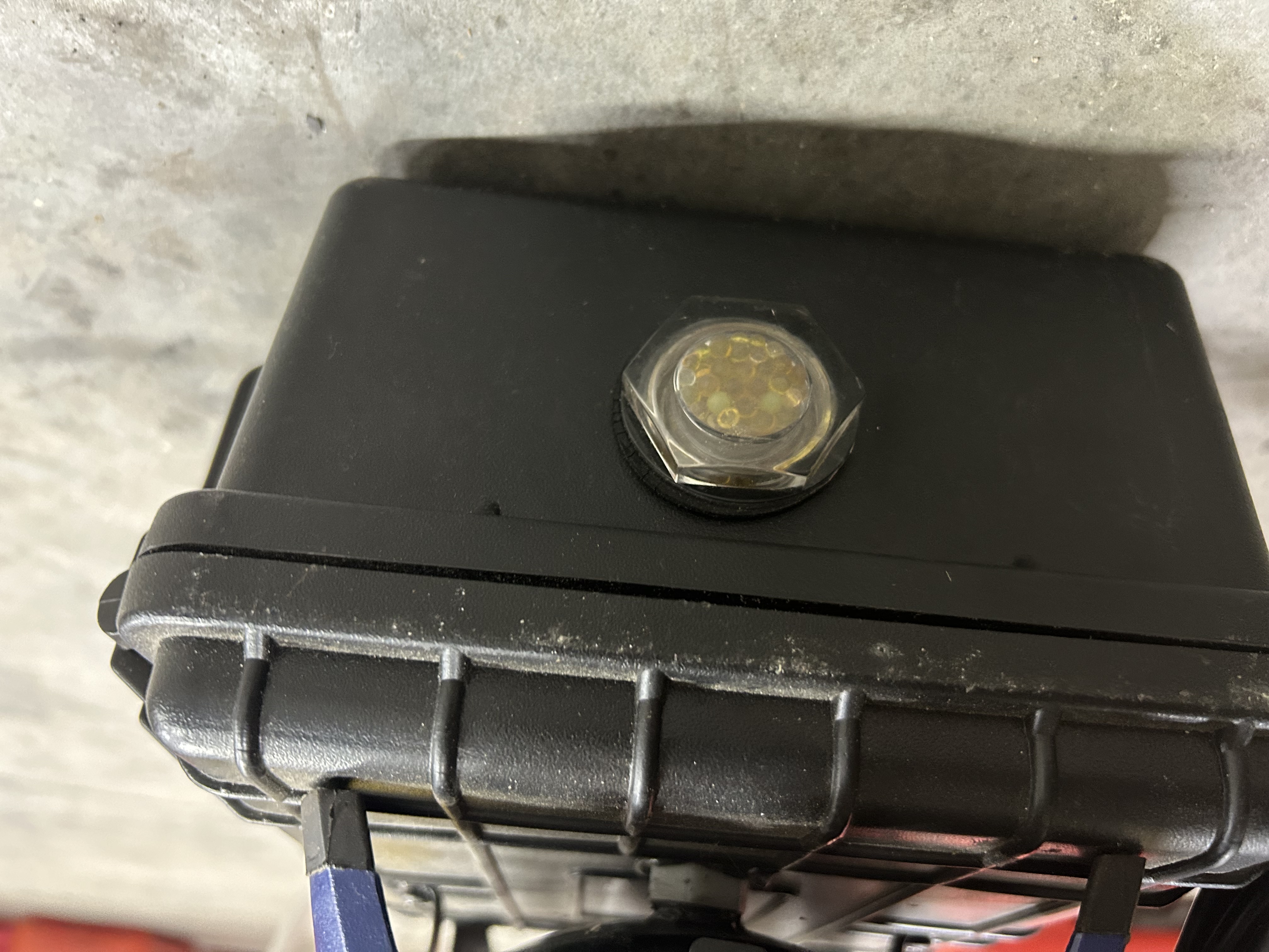

Several videos/threads on a DIY dehydrator. I made mine somewhat portable out of a an airtight case from Harbor Freight, aquarium pump, and a sight glass. I can get a picture of it if you want.

WWhunter wrote:Several videos/threads on a DIY dehydrator. I made mine somewhat portable out of a an airtight case from Harbor Freight, aquarium pump, and a sight glass. I can get a picture of it if you want.
Yeah, it would be great to see pics of your set up.

Apologies for the late reply. I'm a bit of a klutz when it comes to downloading photos.
