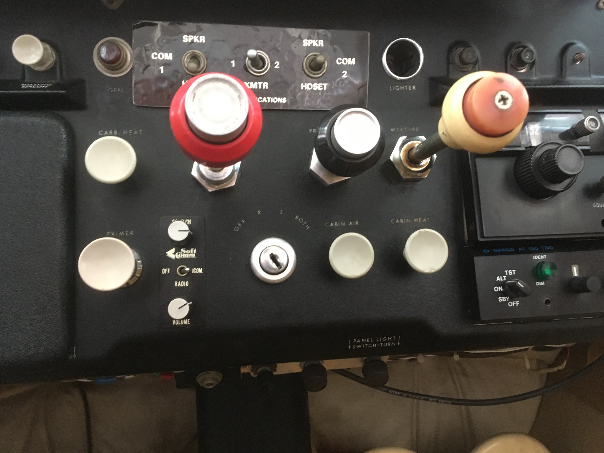

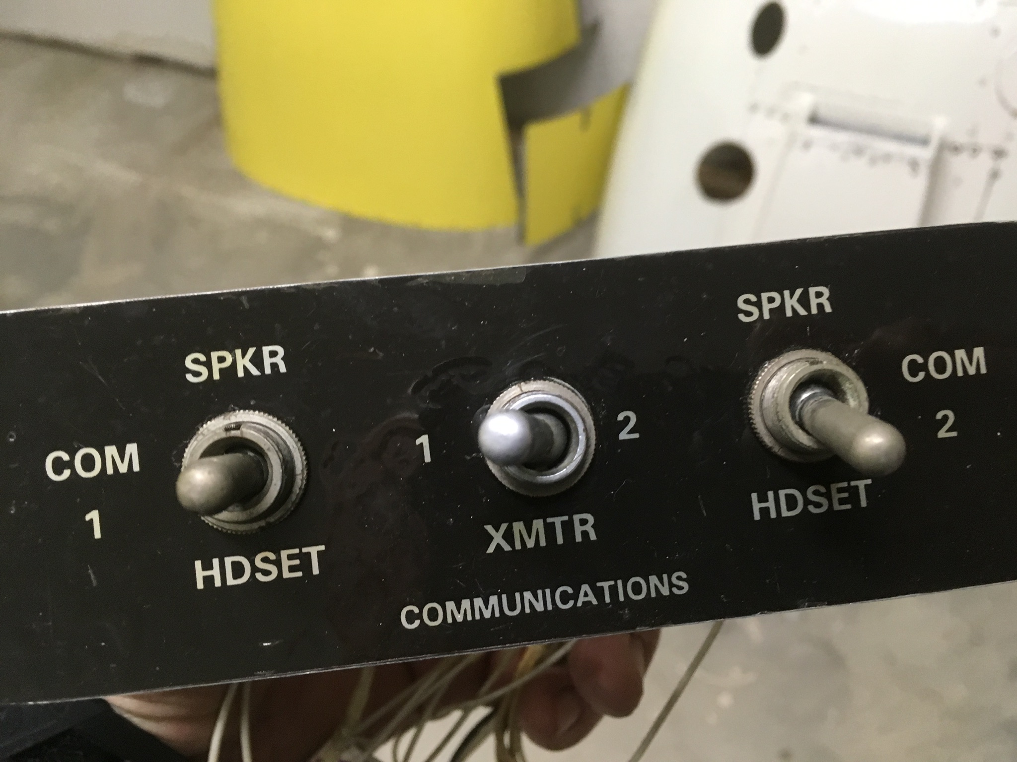

A question...I’m rebuilding the panel on my 182 and the previous owner wired up his own “audio panel”. He would not have been able to identify a VOR with this set-up but I’m not putting in a Nav radio...just 2 Comms. GPS will be all I will need. So...I don’t need to identify a Nav station either so his creation would work for me. However, an Avionics guy looked at it and said “Gee, I’ve never seen anything like that. We would have to reverse engineer it to figure out what he did. (I didn’t know that I have the schematic.).
However...to keep things simple and easy...I’m wondering if anyone makes a set-up like this. You can see it above the throttle in my attached pic. (Hello! Yep that throttle is red and will be changed!)
Comm 1 on the left with a speaker or headset toggle. The center position is off. Same on the right side but for Comm 2. The center toggle is used to select the transmitter to talk on. Pretty simple.
Anyone ever seen this in an off-the-shelf version?

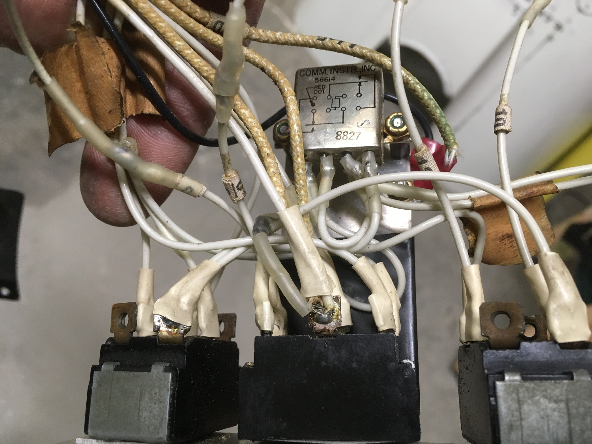

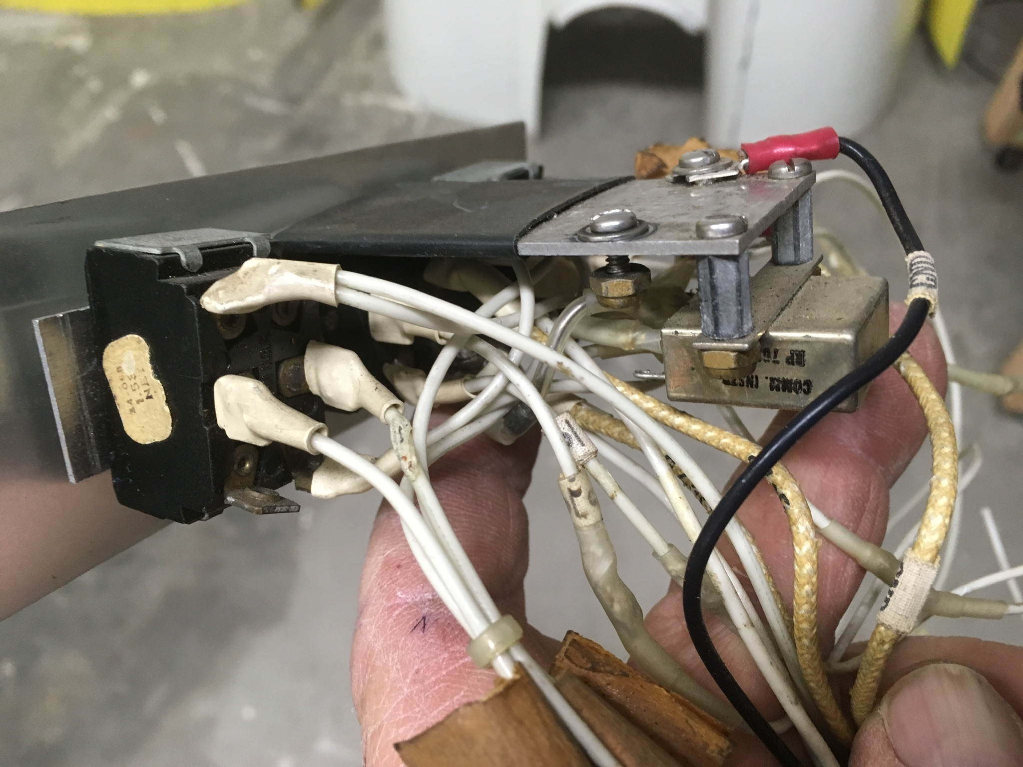

Looks pretty home made to me.
Do you have a shot behind the panel?
My guess is it’s simply toggle switches to route the signals and a small amp to drive the speaker.

If that rig works, why not keep it? Looks simple and elegant to me, not to mention a LOT cheaper than some commercial model.
Should be easy to figure out how it’s wired, make your own schematic.
Finally, do you really need a speaker?

My first airplane, a stock 1969 C150J, had a similar "audio panel" for the two nav-coms.
I agree with Mike- what's wrong with that set-up?
In fact, if you don't have a speaker, you can just have a single toggle switch to select which com is transmitting,
and just turn the volume on com 1 & com 2 up or down as required.
IMHO simpler is generally better.
An audio panel just adds one more thing that can fail, or be set wrong.
Esp if you already have an intercom, I don't see the need for one.

No audio panel in my 170B. My IA and I wired up a simple switch that selects COM 1 or COM 2 for transmitting. It’s so simple and works so well I have zero need for anything else.
Others who try it are amazed at the simplicity too.
You can control the volume of each radio independently right on the radio.

So here’s what a rocket scientist with 65 patents comes up with for his (mine now) 182. Pretty cool actually. It worked great. Comm 1 was a Val 720 and Comm 2 was a Mark 12B. Perfect for the guy who doesn’t need to identify a VOR. I’ve taken 39 lbs out of the panel that’s not going back in. That should help my forward CG.
