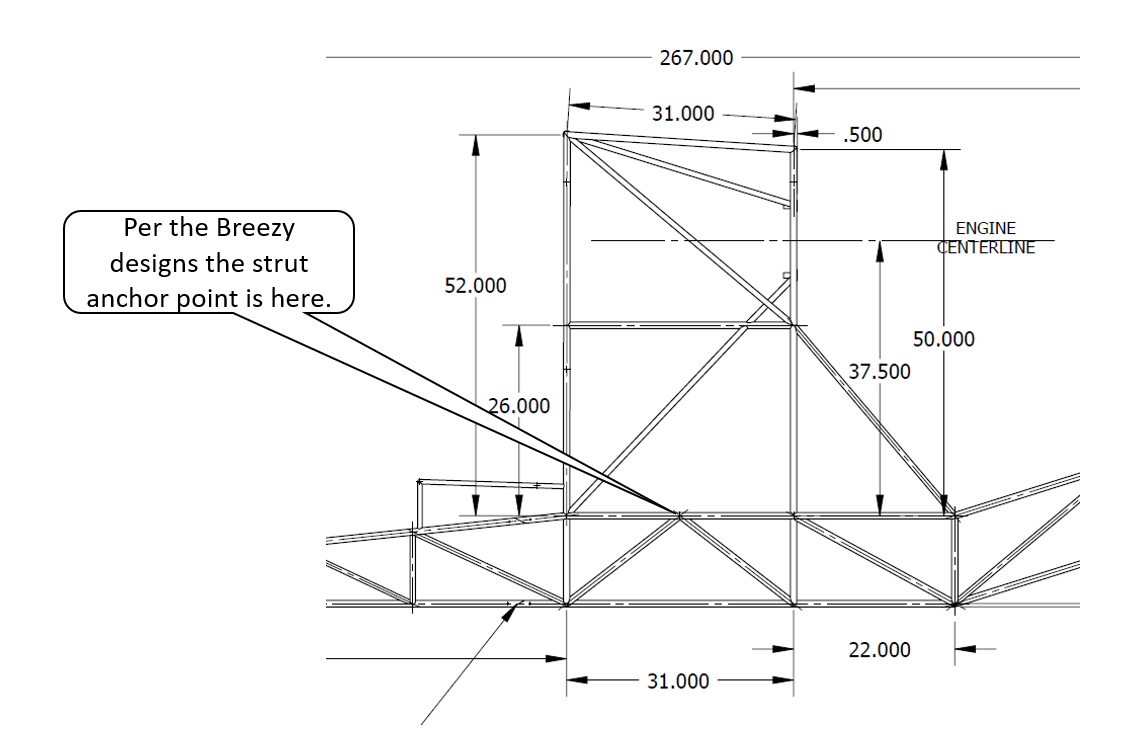

Thanks for the great comments. Here is the anchor point as defined by the Breezy design. I presume I could move forward or aft to hit one of the main members however with this configuration the stock struts can be used. A big plus. This will get a full finite element analysis before it is built.
anchor point.png (114.83 KiB) Viewed 2841 times

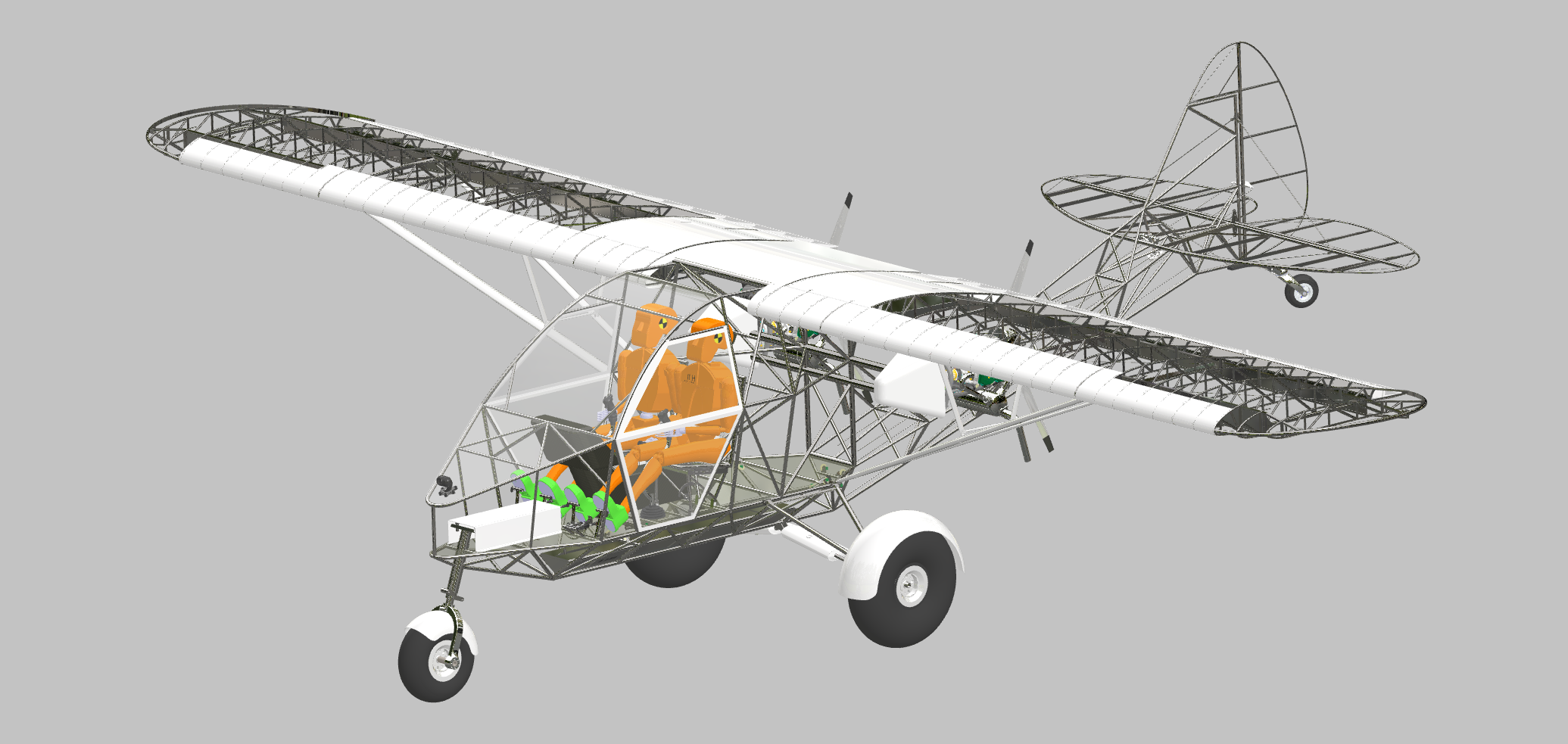

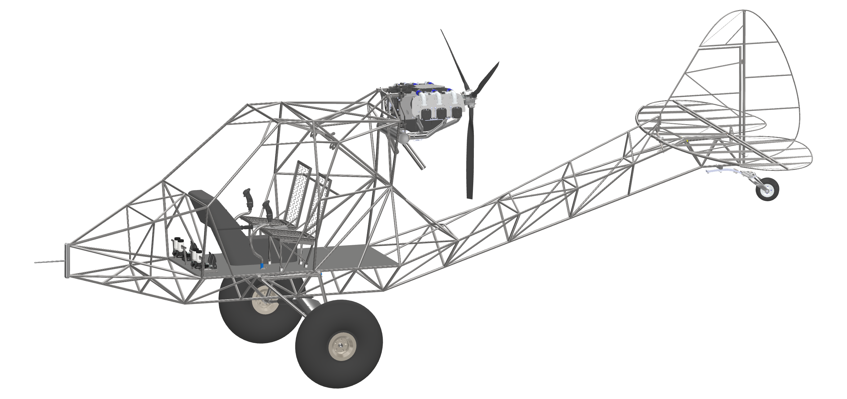

Thank you for the information. I have now designed my own wing based on the PA18 design. The Makey kit and Backcountry's still look pretty good also. Calcs show good CG with current design.
Here is the airframe. No bending required. Modified Breezy with Piper tail and other parts (seats, controls, etc.). Designing airframe jig now.
dragger airframe nearly complete

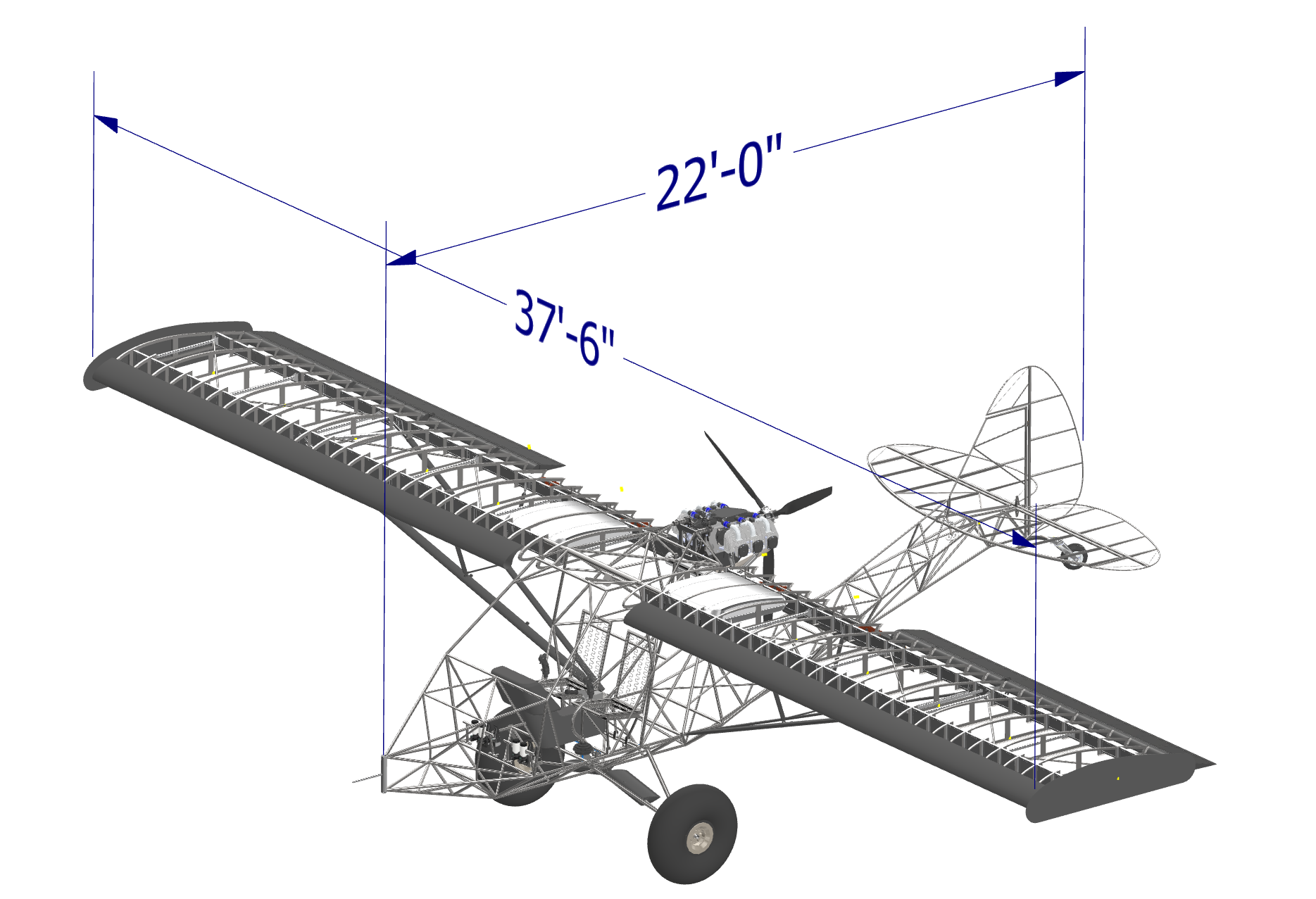

With custom wings.

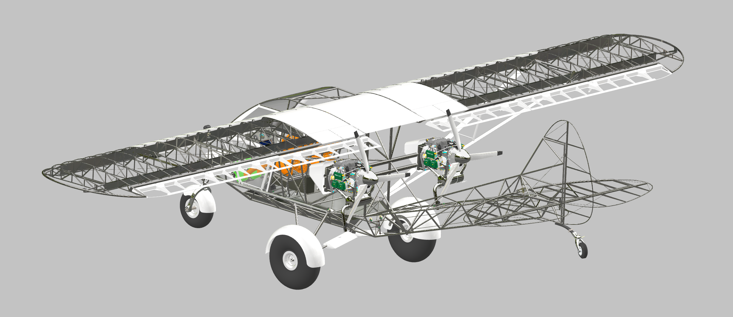

Folks,
Sorry for the delay, Mike at Yakima helped me with the single engine issue so I went ahead and twinned it. Nearly complete and working on construction drawings now. CG looks very good and stable and is coming in around 1100# dry.
Engines are offset from CL at 33" and running small props to limit yaw on one engine. This is a bit like the AirCam design and should be able to take off on one engine. Currently looking at 912si or 914s.
cadman offline
Posts: 20
Joined: Sun Mar 01, 2020 11:15 pm
Location: Austin
Aircraft: Home Designed
Re: Pusher Stol
A couple of my critical design goals were:
* No or minimal tubing bending
* Side by side seating (wife "must" be able to dig nails into leg when uncomfortable)
* Easy to build - air frame based on Breezy so pretty straight forward
* A design to work with existing wing designs such as Dakota and Piper (currently for Piper 18) - the Breezy base air frame does so.
* Uses standard Piper parts and pieces such as seats, etc.
I am hopeful to pick up a donor Piper to scrap the tidbits needed for the build. I hope to be in the 51% but have to talk with FAA inspector to be sure. Donor air frame and unused parts will be sold or scrapped.

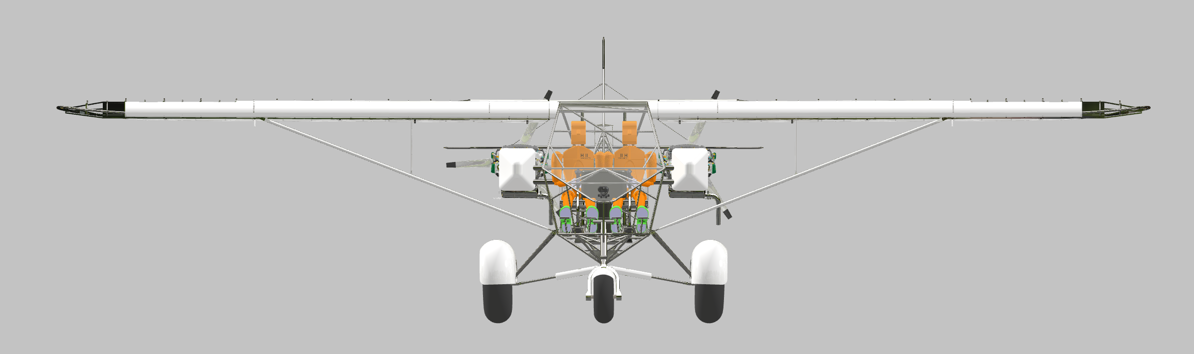

Front view.
