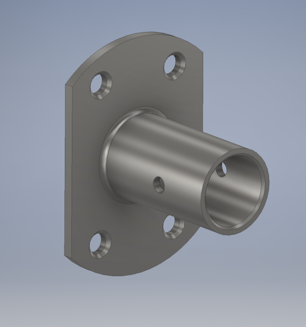

Saw this video the other day, not sure if the owner is on this site of not, but I think it's a pretty good idea. Got me thinking I could CAD up the plate mounted to the axle pretty easy. I'm going to re-purpose a pitbull motorcycle stand as the jack part. The inner diameter of the tube is 0.860" so it can accept a 1/2" NPT pipe or the end of the pitbull stand.
The design will fit the 120/140/150/170, but certain year models will need the 1/4" holes drilled out to 5/16" and/or 3/8". (Grove Type 2 but with 1/4" holes).
If you are interested in a set, let me know. I'm by no means trying to turn this into a business, but I figured since I'm doing the leg work I'd offer it up to the forum, makes no difference to me if I order 5 set or 10. A set of two will be $110 shipped. I'm not making any money off them, this is my cost. I'm having them machined out of 1018 steel. The plate is 1/8" thick and the tube is 3/32" thick. Estimated mass is 0.318 lbs.
Most people who have done something similar have been able to get away with just a logbook entry. This would be considered an owner produced part per the FAA.

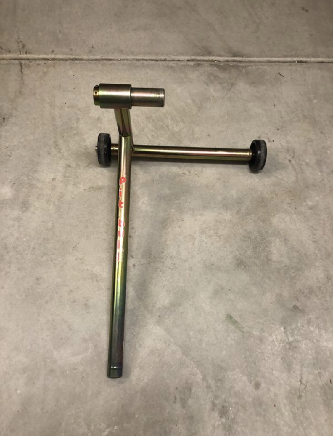

The motorcycle stand I’ll be using. You could buy one of these, weld up your own, or use an automotive scissor jack and a 1/2” NPT pipe.

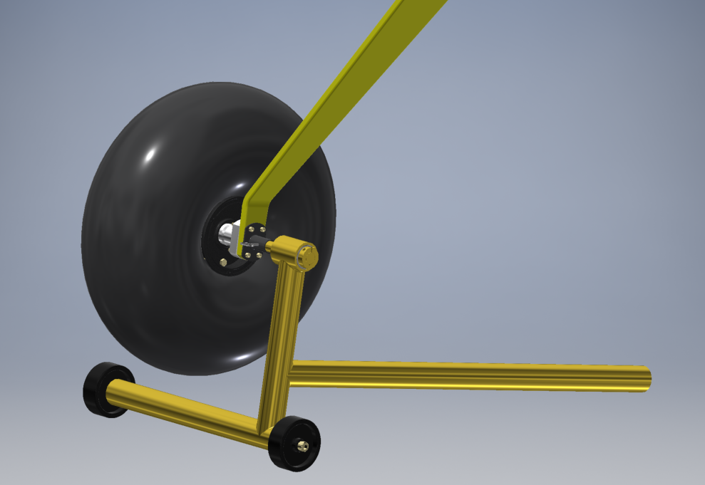

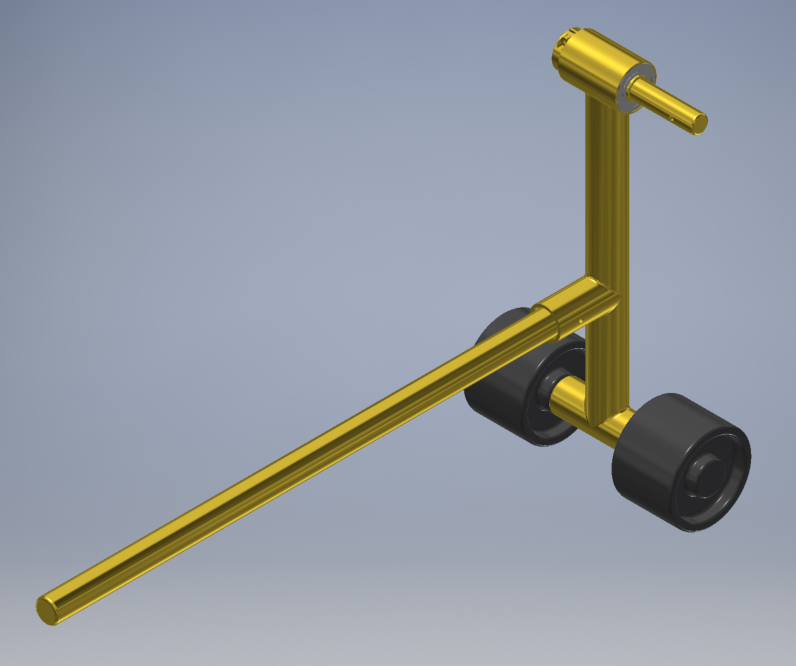

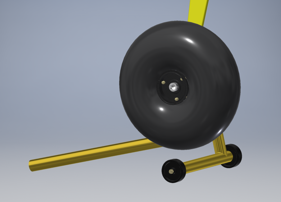

Kinda went down the rabbit hole with the CAD, but I'm having fun with it..Pictured with 850s, but also modeled 26s and 29s.
