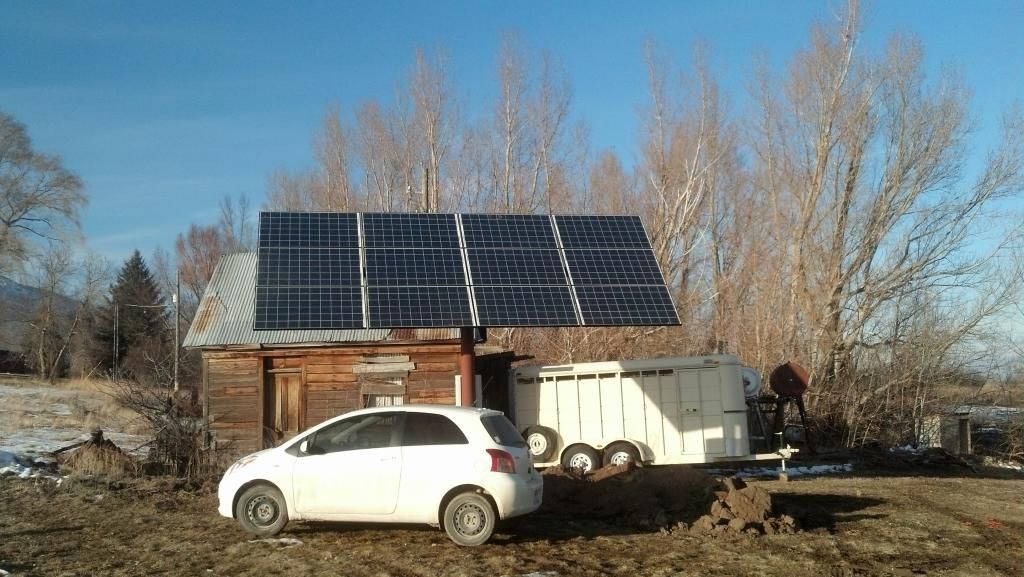

I have used a 10 watt PV panel for the last 25 years, the same one, to pump all my fuel. Junk batteries, or almost junk anyway, not even deep cycle just too wore out for the vehicles as a starter battery. I'd consider 10 watts as a minimum, and like real estate, it's all about location. Mine points true south, and while a 45 degree angle would work best at my latitude year round, mine is vertical as it is simply secured to the side of the fuel outbuilding.
The proper way to determine what to use, is to figure how many watts those 12 VDC fuel pumps use, then figure how many hours (or minutes) per day or week you may need to run it, and then get a PV panel that will slightly exceed that amount of power on a routine basis. Figure (approx.#) 4 to 6 hrs of full output per day on an annual basis, that will be pretty close to how many amp hrs a panel puts out, if aimed halfway correctly. Or, just do what I did, and use what you have......buying new, get a multi crystalline type, they are preferred over the amorphous type (what you have jeredp) they are longer lived (pretty much forever) and put out more power per sq. in. 99% or more of what you see on homes are the multi types. Like a checking account, any solar system is best when a bit more money/power then needed is deposited. Also these small panels get a lot cheaper the bigger they get, cheaper per watt. As an example, I just googled "20 watt solar panel" and bang, there is a multi for $70.00 or $3.50 per watt. The little 2.5 watt maintainer cost $15.60 per watt. So, especially if trailer mounted, and possibly subject to less then ideal siting, go 10 watt min. 20 won't hurt but now you also need a charge controller, but a simple one can be had for around 30 bucks.
This 3060 watt system I set up last week would do it!Image
